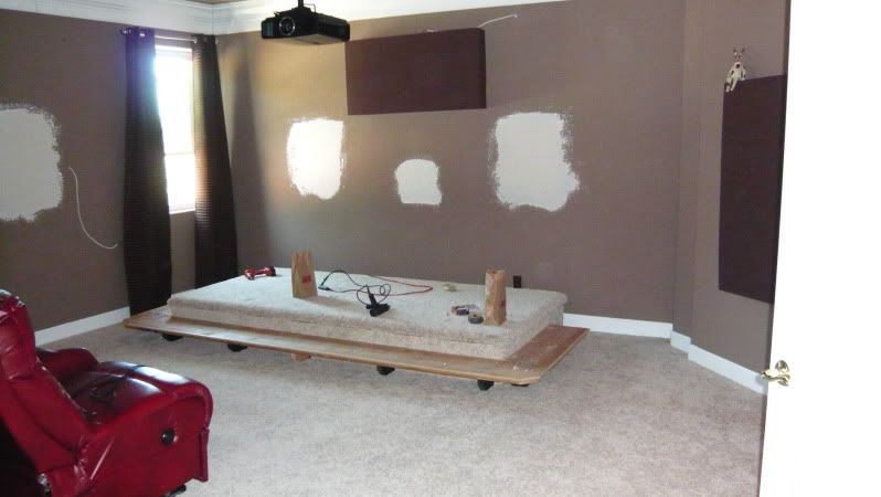

I posted a picture of my in progress room changes and was whining about the hard work but somehow it didn't post:confused:so here is the picture from earlier today (minus the whining) as well as one I just took. Basically, I couldn't wait for tomorrow to set up the room even though I still have to texture and paint the patches but I just had to give the new JTR's surrounds a listen. I did a very basic setup level match and had to drop the surround level 10db from my Revel in-walls setting. I put on Porcupine Tree DVD-A that has a song I am very familiar with (Even Less) with great dynamics.
OK hype alert OMG:eek::D
I had the volume -5 from ref and the SPL meter was right @100db with peaks to 108 or so. I had that I can't believe I own this system grin on my face. I know it will go a lot louder (I checked;)) but I really want to keep my hearing for a bit longer.
Bottom line ... I think this is gonna work out just fine ... :cool:

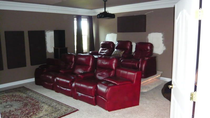

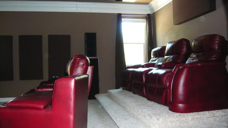

Couple of pics from the day;
New chairs and riser nearly done.

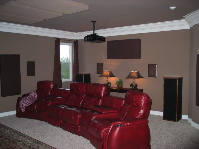

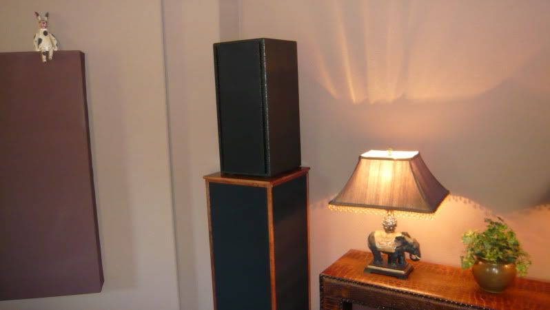

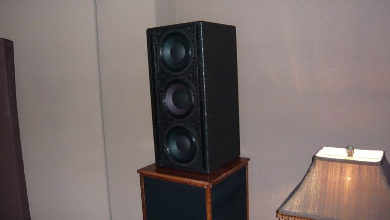

Phase one of the most recent changes is complete. The in-wall are gone,wallspatched and painted and the JTR Triple8's are sitting on the GIK Pillar Traps. That places the T8's at 46' off the floor with coax at about 5' and that is just about perfect.
I ran the wires for the surrond backs (JTR Slant 8's) and the Captivator subs that should be here by mid August. Also did another basic calibration *(DVE Bluray) and cleaning of the projector lens/filter.
Couple of pics:
The sub riser (Dual Danley TH-SPUDS under):
The T8's on the Pillar Traps
I've had two movie nights so far and I'm feeling pretty good about these changes. Really nice having a six seaater. :cool:

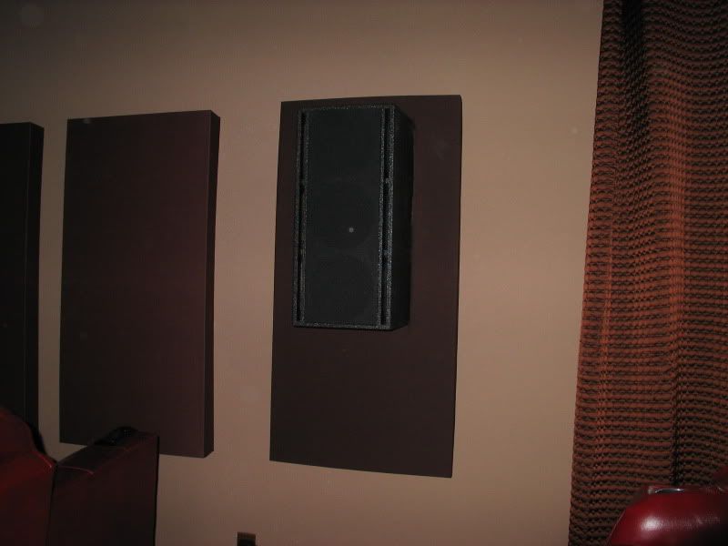

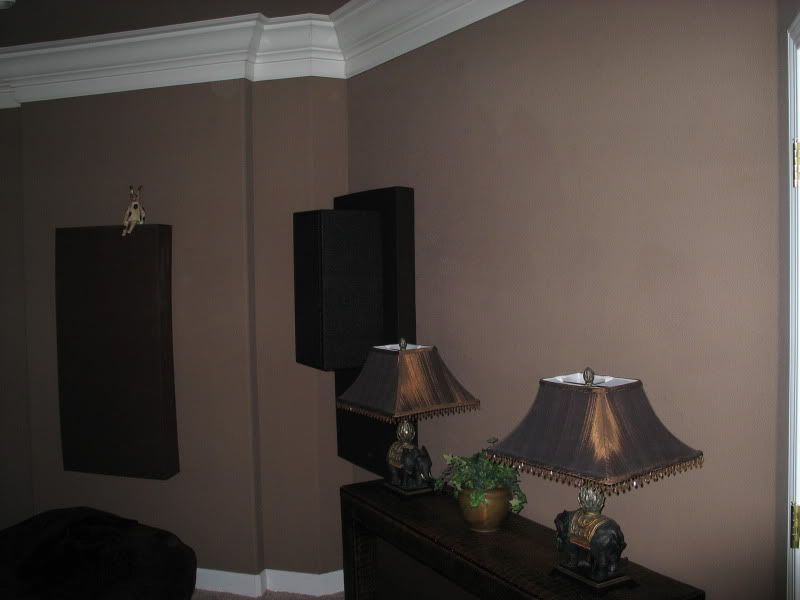

New Surrounds
With several movies and 5-6 hours of music listening under my belt, I am amazed at the improvement in the surround sound. The new coax in the T8’s is just outstanding and I am looking forward to getting my T12LF’s upgraded to its counterpart coax and Xover. I used to believe that the surrounds were not that important as long as you have strong LCR’s but when you have 5 or more very capable speakers and a good quality 5 or 7 channel mix, the results can be spectacular.
The T8's are very large (and almost 50lb's) for a wall mounted surround but Jeff P.gave me the idea of using a french cleat and that worked out great. I then cut and slid an acoustic panel over the T8's.
Here are a couple of pics of my in-panel wall mounting solution. I am going to be trimming them out with a piece of crown molding (cosmetic only) to lessen the apparent depth visually.

Nice job!
Yeah, cleating is a great way to hang heavy stuff. Plus, if you want to take something with you, it is not so permanent. All my garage cabinets are hung this way so I can take them with me if I ever wanted to move.

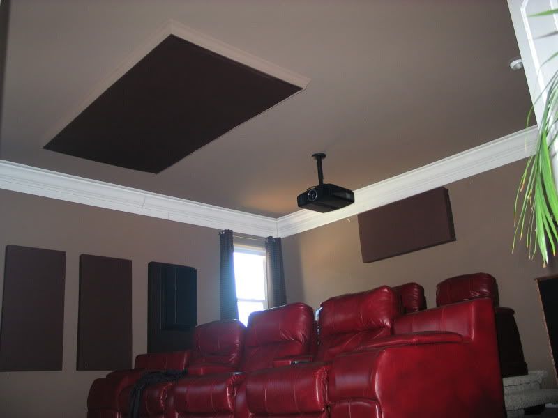

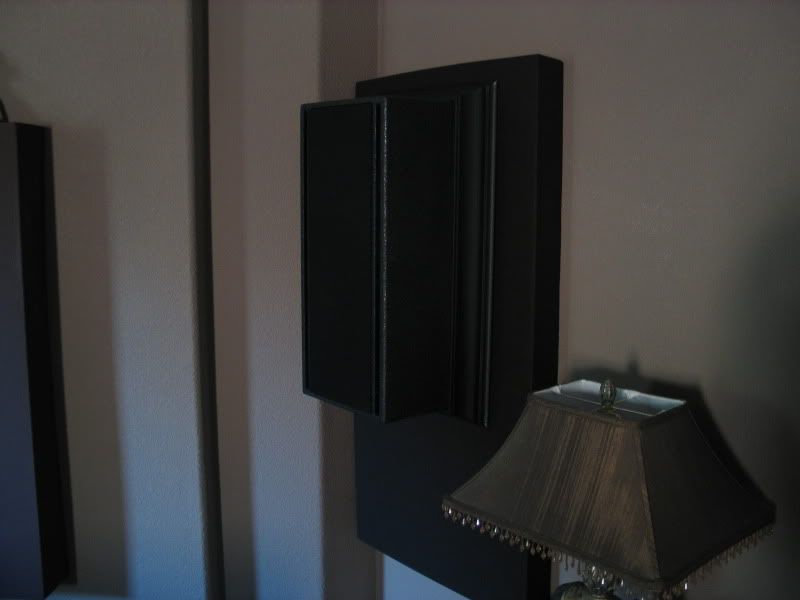

Couple of small changes to the room. The biggest difference/change was to the three acoustic panels on the ceiling. I cut out the old fabric covers and added some crown molding making one large panel. I had painted (against the GIK guys’ recommendations) the panels with the same wall/ceiling paint. I thinned the paint but when I removed the old fabric the paint had ruined the acoustic transparency. The ceiling is an important first reflection point and I was getting little or no benefit after my “paint job” modification. I can definitely hear a difference in SQ since the change.
Old 3 panel look (mostly non-functional)
New Mono Panel (doing it's job)
Also finished the panel cut-in and molding on the JTR Triple 8’s. These speakers are 12.75” deep and I was hoping this panel mod would make them blend better. I have mixed feelings on the looks but the BIG difference in SQ vs. the in-walls makes the aesthetic compromise worthwhile.
