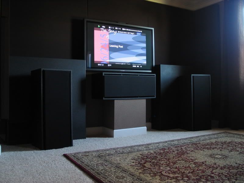

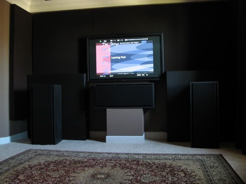

I finally got around to installing the speaker grills that Jeff P made for my JTR Triple 12LF's. Makes them a little more presentable, don't you think?
Anyway they are still a bit behind the Revel's aesthetically but in terms of dynamics, they will give most "audiophile" speakers a good spanking. :)

yeah, they look nice, and the absence of visible grill pegs are nice (how do they attach?)
are the grills included with the speaker SRP? or separately?

Those grills look really great. Those speakers are awesome, just not so aesthetically pleasing, until now that is.. really nice upgrade. Those are on my short list for sure...

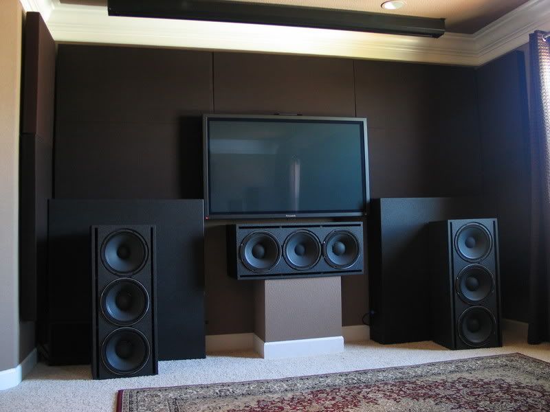

They are optional. There is also a round metal grill option that just covers the drivers but I prefer the full grills. Mine were ordered after the fact, so Jeff P sent me a template for drilling out the cabinet and installing the anchors. The grills themselves have plastic pegs installed that mate to the anchors. At 8 per speaker that was a lot of drilling (drill baby drill:p) but it turned out nice. Of course if you order them up-front they come pre-installed.
As you can tell, I've turned into a function over form kind of guy, but I really do prefer the new look. ;)
Before

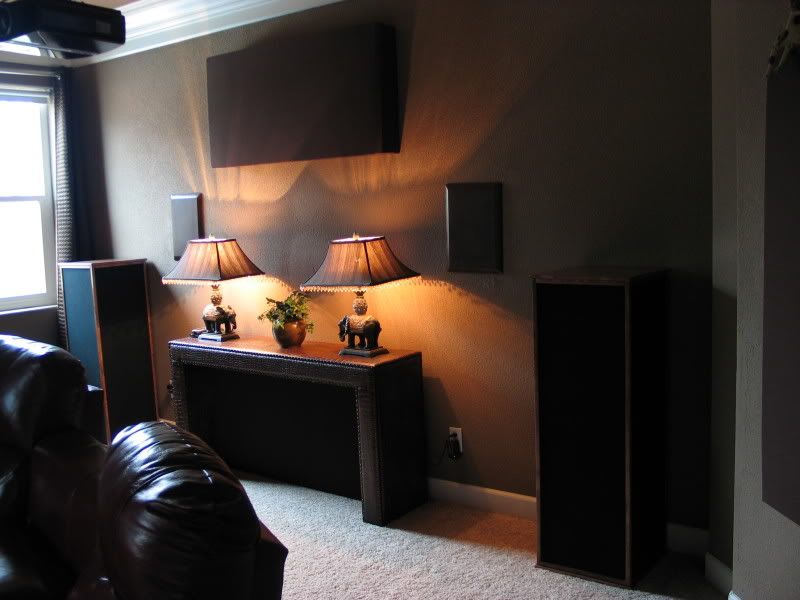

To finish off the Revel speaker replacement, I just ordered a pair of the new 2010 JTR Triple 8HT's to use as my surrounds paired with my T12LF's. They will be replacing my Revel in-walls.
Due to position limitations I'm going to revert back to a 5.1 setup vs. my current 7.1. I am confident that the increased dynamics of the T8's will more than offset the reduction in speakers from 7 to 5.
My intent is to place them on top of the GIK Pillar Bass Traps pictured below. I am hoping that will be a good height for them as this will place the coaxial mid/tweeter about 5’ off of the floor and a couple of feet above the LP.

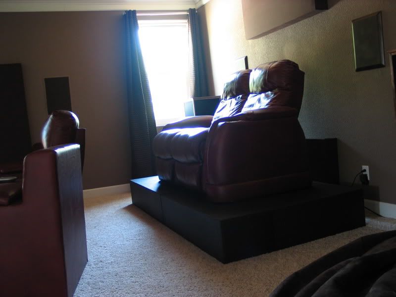

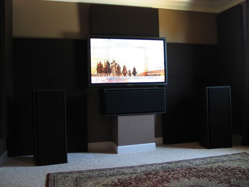

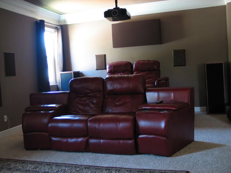

As a little Fathers Day present to myself, I re-configured the room to try the Danley "Couch Sub" as it was intended. My first comment is I wish I had done this months ago. The bass in both rows is excellent and really fun in the 2nd row on top. I re-ran my SMS-1 EQ and Audyssey on my Integra SSP and the FR graphs at all seat locations look/sound really good. I place the subs so that the vent exits are aimed at the side walls rather than front (what I did before) or rear facing exits. The flexibility of this vent placement is really nice and gives you several options.
I ahd used dual SpeakON cables for the front location but I only had a single in-wall SpeakON cable (50') run to the back of the room so I bridged the QSC PLX2502's channels. The SPUDS are wired for 8 Ohm nominal so chaining them made it a 4 Ohm load to the amp. The QSC bridged @ 4 Ohms is rated at 2500W so power is not a problem
I really like this two row config in the room. I may add two more seats to the front row but for the time being, this is a really nice seating/sub arraingment. Sound and view from both rows is great and I think this is going to work and (this is the best part) it cost me nothing.:cool:
Some pics:
2 (small;)) Rows
Dual Spud Riser
New look front minus Spuds

you seem to have an unlimited supply of panels :) edit: i didn't realize the whole front area was made up of panels
good change though ... where do you keep your minions btw? (for moving all that stuff every other day. mine are in the basement)
