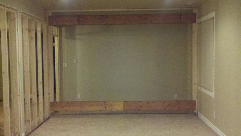

Things are pretty much set in stone at this point. There is 3' 6" behind the beams which will have to suffice because that is the most I could get him to sacrifice of the room.

I am still annoyed with those huge beams. The only intent of them is to be a false screen wall, he just did beams when he really didn't need to do anything but a few 2x4 struts to support the screen. He called me and said "I've got my false screen wall framed" as opposed to asking me how to frame it. I guess being 1200 miles away doesn't help - I was there for the framing of the last one and it wasn't as complicated.
The remodeler that helped me to begin mine happened to be degreed in art now that I think about it, and he advised me that being plumb was more important than anything else here, including being level. I don't know how much his art background relates to AV, so take that FWIW. And I followed his advice, I went plumb first and foremost, using a mallet to adjust before drilling in the huge screws into floor and ceiling.
