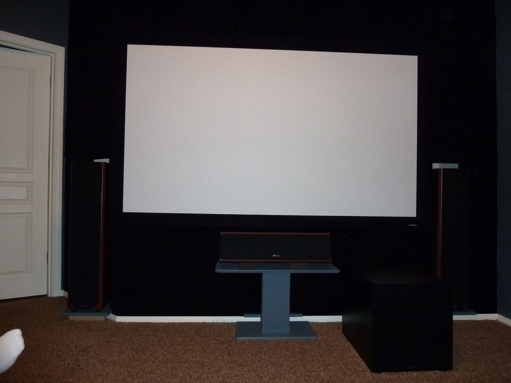

Ah yes, a clarification is definitely in order. I am covering my entire front wall in velvet.
I had this idea as I was moving away from Wyoming and my dad was working on a new theater. We stuck some self-adhesive black velvet that they use for telescope liner all over his front wall (except behind the screen) and the effect was most excellent. Despite the improvement in the projection experience, that stuff was expensive and it didn't stick too well. His ceilings were only 7', so we ran a piece on the ceiling as well, and it won't stay up. Anyway, I found the Mc-Master Carr stuff and got a sample (you can see a couple strips on the wall in the above pics). It sticks great, but now you probably understand more why I was so concerned with the price. :D I estimate I need about 15 yards of 45" wide fabric to do the whole wall, and I should probably go ahead and do behind the screen area if I ever intend to do the AT screen thing...
I will definitely wear a mask. There is going to be a lot of glue fumes if I intend to glue velvet to the entire wall.
I bought the combo pack with the big can and the little can of S77. I think I will probably do the big can for the massive surface area and use some metal J-channel to help me make my edge cuts without gouging the drywall, then use the little can for the edges.

Ah, I see! Talk about a light controlled screen wall! Your screen will definitely be "floating", depending on the quality of the screen's border itself.
edit: I am starting to have some concerns about the overall visual effect though. Velvet like this is so absorptive, than any non-absorptive areas may stand out. So, your speakers . . . . will they be distractingly reflective all of a sudden? Your dad's speakers were plainly visible? (If you are certain to go AT, and have all* three speakers behind the screen, then I say go for it.)
Are you planning the cuts to be vertical, or horizontal? Yeah, with that much S77, open ALL the windows! haha.
I've never heard of the Carr stuff, but I'm guessing that every velvet we've mentioned in this thread is used inside telescopes. I'm pretty certain the Fidelio is, as I think Seymour said as much.
The stuff is really like a black hole. Check this out, I had all of my track lighting at max setting, pointed at the velvet. I had a tripod flashlight right next to me, pointed at the cutting area. I also had a headlamp on at max setting, and even with all that lighting, I could barely see the cuts I was making. :eek:

Yeah, my dad's speakers were the most reflective thing around. The grilles weren't distracting, but I think he ended up putting velvet on top of his center and subs and on the sides of his L & R to tame the reflection and it looked fine. I think my situation will have less issue as far as that is concerned because of them being set back near the plane of the screen. I will probably have to put velvet on top of my current center, but I won't glue it. I also intend to wrap the sides and tops of the speaker holes with velvet and there will probably be black acoustic panels in the closet behind the speakers themselves for minimal distraction. I am excited to get it done. Should it turn out even half as good as my dad's theater, it will be awesome...I really need to put up pics of his theater. It is the best thing I/we have ever done. I even mechanical enginerded a vibration-damped projector shelf that made that RS2 nearly silent, after all the noisyness complaints I had while I was using it.
I built an MDF blank-out panel for the center speaker hole today. I will probably velvet right over that. As of today, I am getting a very definite, unambiguous vibe from SWMBO that the AT screen and DIY speakers might not happen in the foreseeable future (less because of money and more because of the doing stuff and never having it done - that may all change but we will see...). :(
It's okay though, I am sure I will enjoy what I end up with, especially since I have been without a really good HT for about a year now. The distant future holds a move away from California and hopefully a savings account that will allow for a custom home wherever we end up, and at that point, there will almost certainly be the full AT screen experience. :D

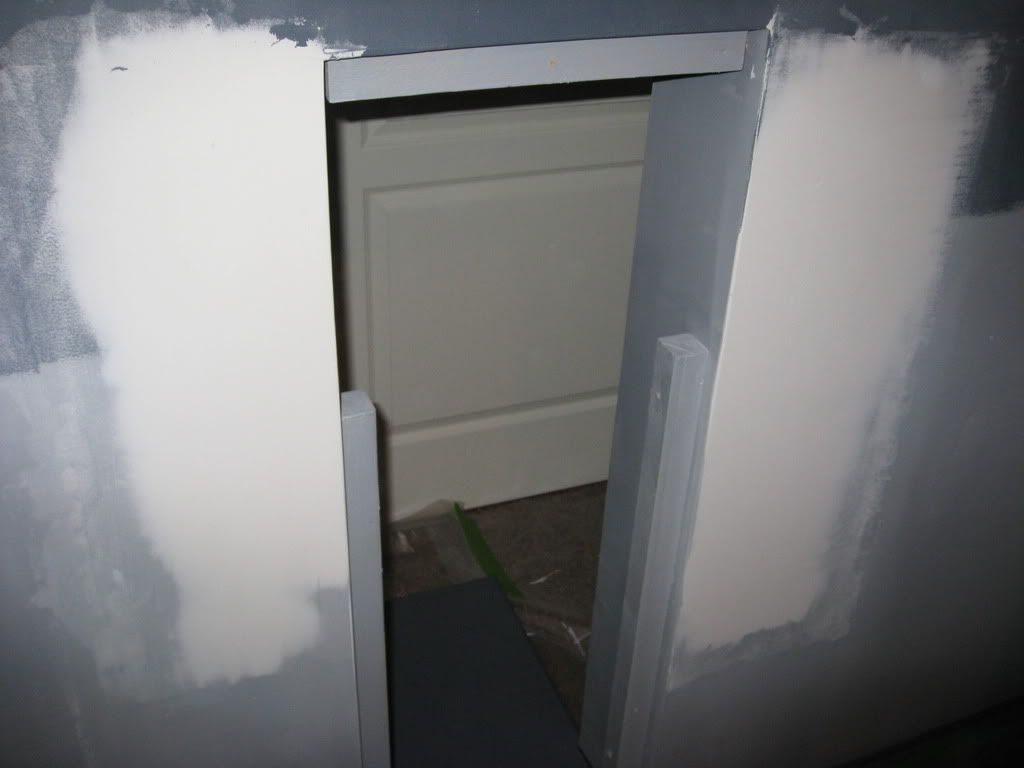

Fixed!

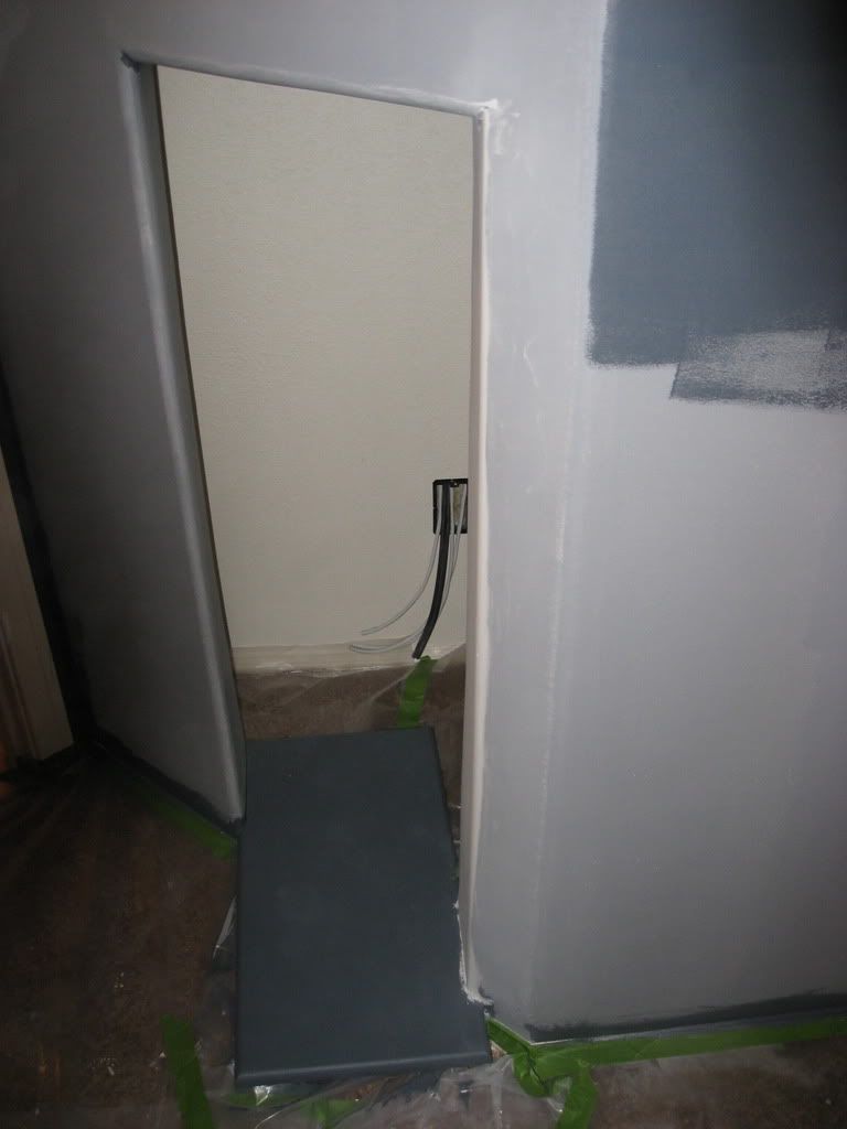

I fixed the left and center speaker holes with some careful muddage. They look much better now (there still looks to be some curvature but that is due to poor photography skills and the resulting distortion from said photography). You can see how bad that left one was before by how much mud there is towards the middle:

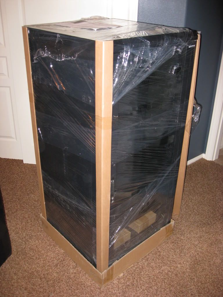

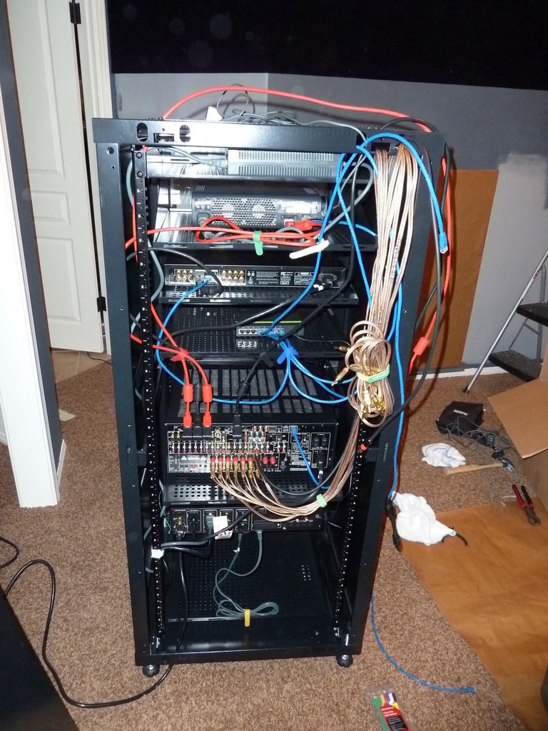

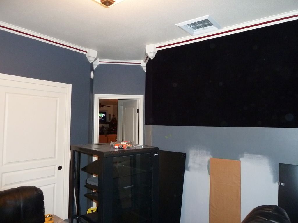

Here is an update and pics of the progress.
The new rack is the Sanus CFR127. I like it a lot because of how flexible it is, but I might have to add a bit of something dynamat-ish to prevent the side panels from buzzing at certain bass frequencies, should it decide to do so.

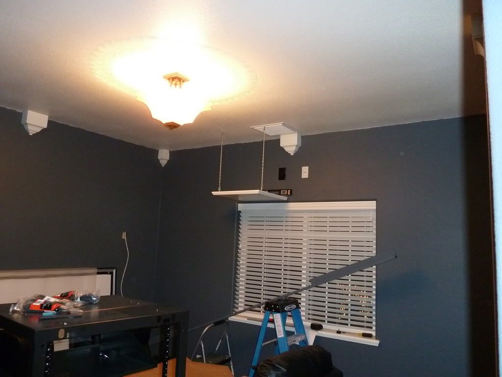

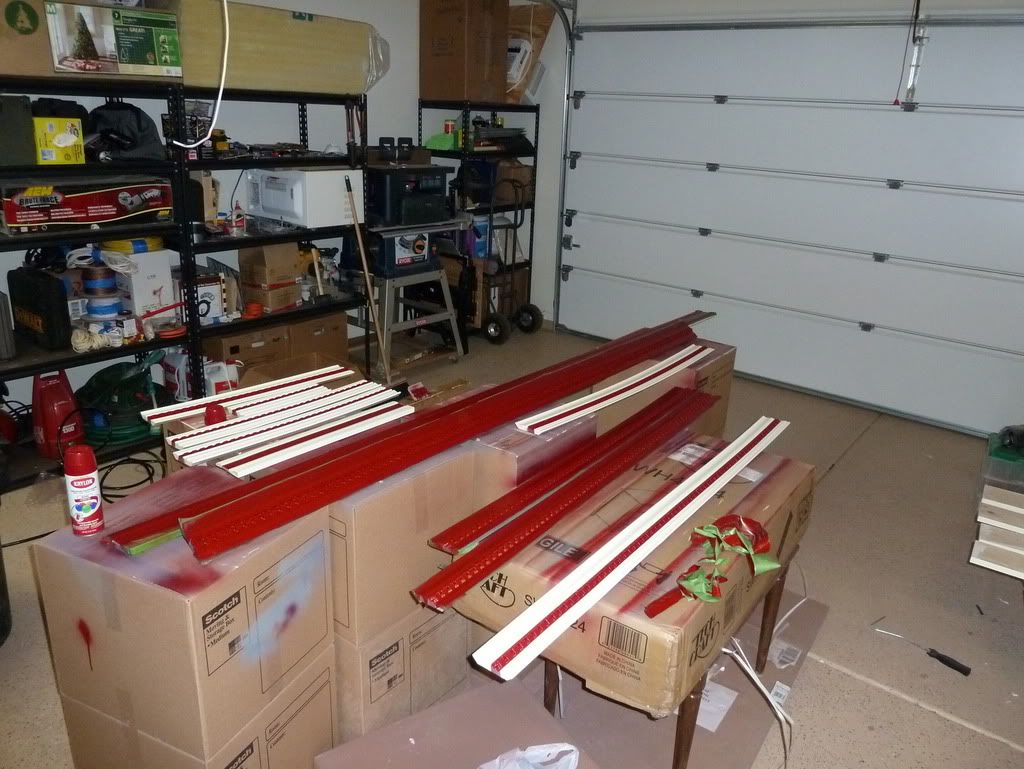

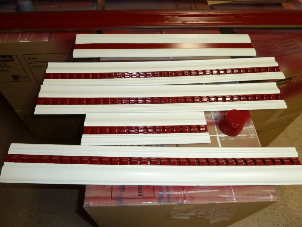

The crown molding was my second-most trying project after the velvet walls, but it was definitely the most satisfying when it was done. It looks amazing!
We bought 8' strips of decorative fake wood (some sort of foam) at Lowes, along with some decorative corner and center blocks so I wouldn't have to make any joints. It took forever to get everything painted. I painted the molding and the center/corner blocks the trim color and then sprayed a red stripe on the decorative blocks on the molding. I did end up making one joint in the molding because i had more than 8' over the screen area, but I got it perfect so you can't even see it if you know where it is. I also had to cope that one so it would fit around the vent in the ceiling, which took a very long time running back and forth to the garage, but I got it perfect too. :D
I put up the new light fixture (which I love) and put it on a Lutron Maestro IR dimmer switch. Excellent.
The projector shelf is positioned such that only my current projector will work, as it centers the lens straight on the screen. I screwed the back to the wall and hung the front by chains. the chains don't really work for me so I plan on wrapping them with wood by routing out a slot and sandwiching the chain between the two pieces. Without any weight on it, the shelf is kind of bouncy out at the end...

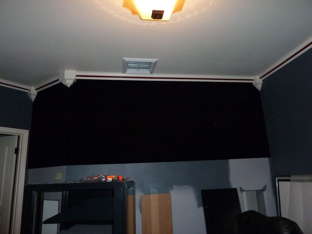

The velvet was hard. It took four people and it turned out excellent on the top part of the screen wall, but there were a lot of wrinkles and some slightly disappointing discoloration (from, I assume, being on a roller or cutting machine of some sort. There might be some dye I can fix it with later) on the angled wall by the door. Then came the bottom half of the wall. The adhesive backing was just too good. It stuck to everything and wrapping those speaker holes was sort of a nightmare. We have lots of wrinkles around the L/R speaker holes, the seams don't look very good and I am just not happy with how it all looks, up close that is. From a distance, it looks perfectly fine.
I wrapped the center blanking panel in the waxed paper stuff that was on the velvet and velveted right over itso if I ever go with the center/AT screen I can just slice and peel off the the velvet there and remove the panel, then just wrap the velvet into the hole.

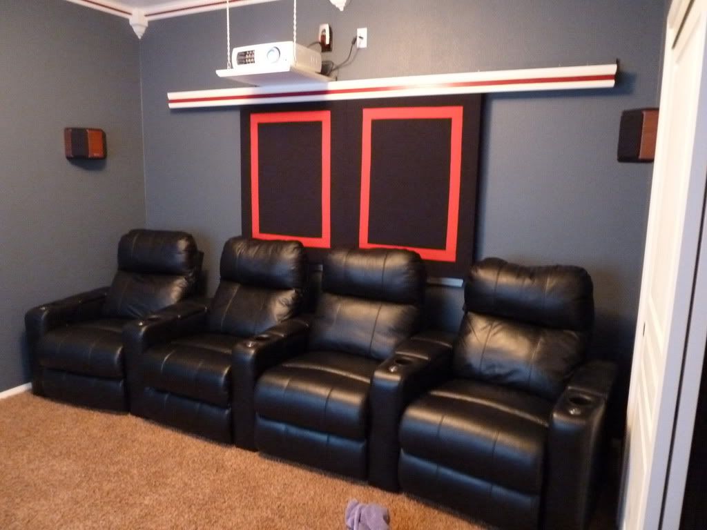

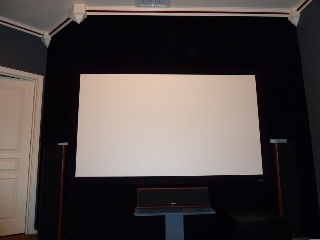

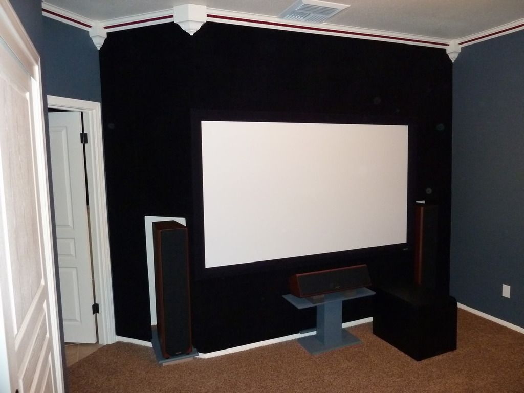

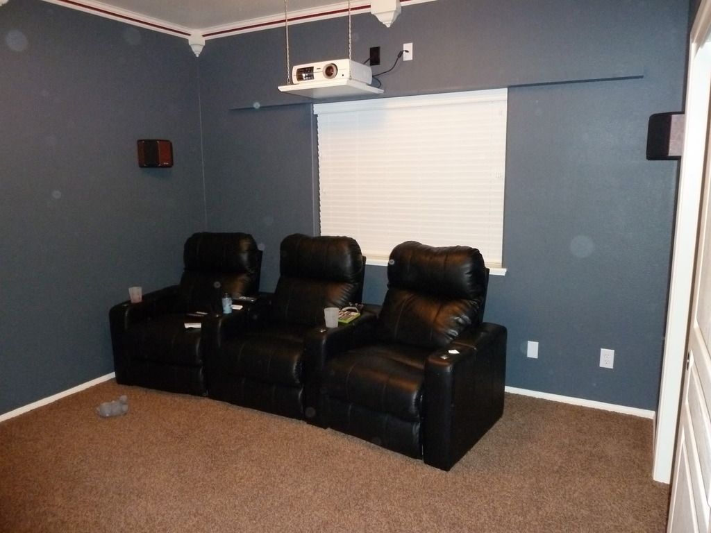

Semi-final pics:
The theater is operational, but not finished. I haven't got the speaker positions perfected, nor have I done any acoustic panels or the window covering. I probably won't run Audyssey until after those are done. Those are next on the list, but at least we can watch movies now. Woohoo!
As I said, despite my issues with it up-close, the velvet definitely had the desired effect. The screen just floats in space. I think at some point (probably post DIY screen if that ever comes to pass) that I will want to make some top and bottom masking panels for cinescope movies to round out the package, since those gray bars are now even more distracting. You can see the white walls of the closet behind the speakers, but you can't see them with the lights out, and I will have black acoustic panels back there at some point.
I also need to address the shelf vibrations because the projector noise is much more noticeable now (it was in a closet at the old house). Also I can hear the dynamic iris (that I couldn't hear before in the old house) clear as a bell and I hate it. It sounds like a 1990's hard drive. I haven't looked into it before now because I couldn't hear it but I don't think it should be as loud as it is. I am going to put the PJ on a big rock slab to increase the mass of the whole deal to start with and see if that helps at all.

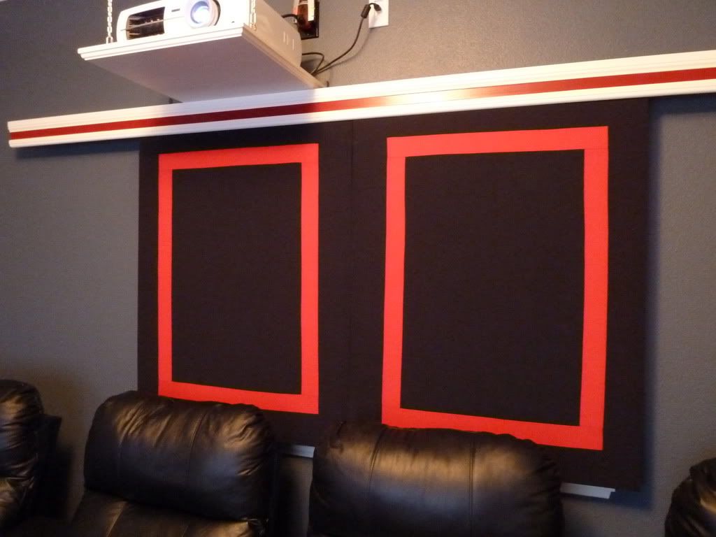

The window...

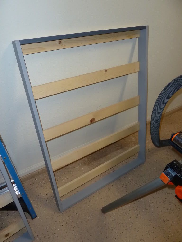

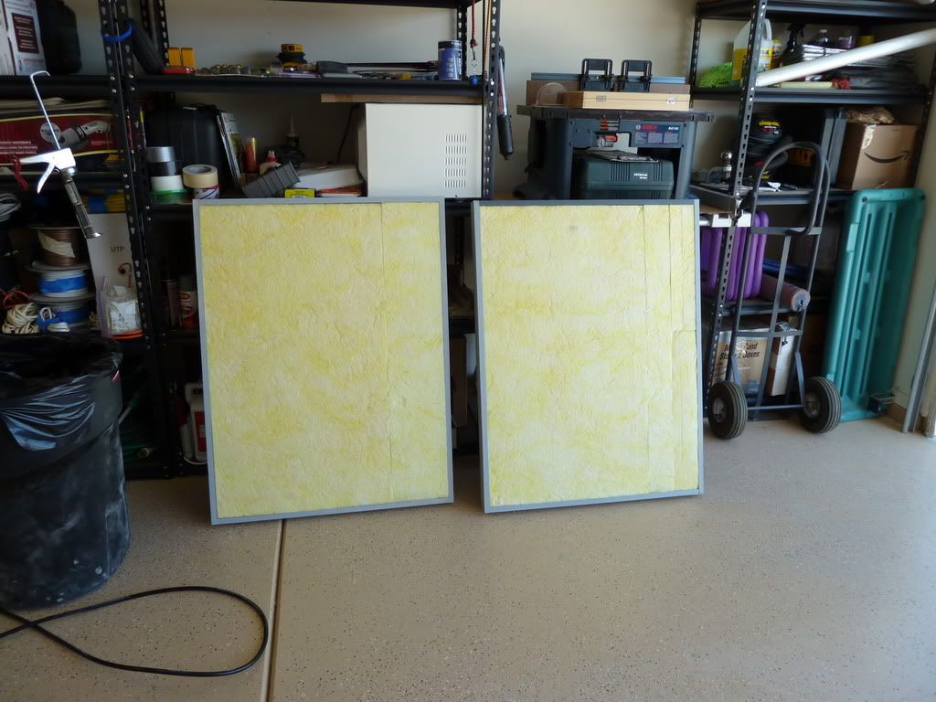

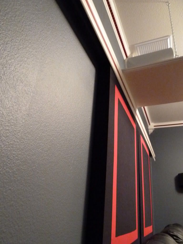

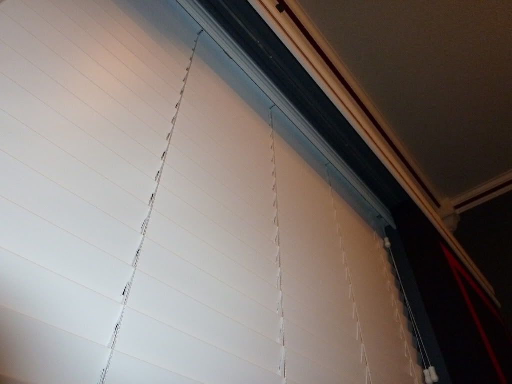

So, I came up with something I think is fairly clever to keep the light out for daytime movie watching. First, I built two acoustic panels with semi-open backs for a little bass trappage:
Since we were getting fancy, my wife broke out the sewing machine and put some nice red accents into black fabric, and we stretched them around the panels. It was a lot more difficult with the accents getting everything lined up, whereas blank fabric would have been very simple. The accents were the slightest bit wavy but I am happy with how it turned out.
Next, I put pocket/sliding door track on a header above the window and rollers on the panels, hung them, and put a valence up that hides the track.
...and now for pictures:
They glide nicely open and closed, not that I will need to open them very often.
What surprised me, as one who has never had acoustic treatments, is what a huge difference it made. The difference in channel separation and clarity was amazing! I am excited to get the rest of my panels done - I can now see what the big deal was (even though I already knew, but had just not experienced). I bought a 9-pack of panels down in LA and I have 6 left, so I should be able to do the room up pretty nice. We haven't decided if the red accent is worth the trouble for the other panels.
