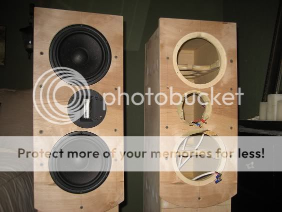

Where did you mount the crossover board? Did you run into any trouble as you installed it, and all the various wires?
Did you install the polyfill yet, and how much difference does it make in the sound? It would be easy to do a simple comparison after you've done one speaker.
How did you lay out and cut the hole for the tweeter?
Thanks Richard, that's encouraging. I showed Erin my wimpy 1/4" roundovers and she couldn't tell there was anything wrong with them. She liked it in fact.
I have not filled them with polyfill. I will do one with polyfill and the other without and report on the differences once I get these painted.

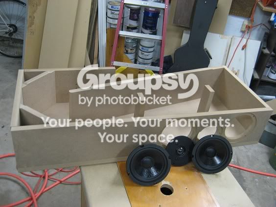

Here are just some of the issues I’ve had with the construction. I will try to add to this as my memory comes back to me.
One thing to look out for is the interference between the crossover and the port. One of the inductors is quite large and since the port sits so close to the bottom and goes so far into the enclosure (especially if using flared ends), it tends to interfere with the crossover. I actually have to mount the crossover on the side of the enclosure at the bottom. If I were to do it again, I might just make an external crossover box or try hard to make it as compact as possible.
The holes for the tweeter are a bit strange and to be honest, cutting them was simply a trial and error process. I actually made some cuts with the router, test fitted the tweeter, and made more cuts until I got it to mount properly. Not professional at all but it works.

I also wondered just where you could fit the crossover board. I couldn't offer any suggestions because I couldn't guess how big it would be. Can you remember what size board you mounted the crossover parts on?
I don't think there is any problem with where you did mount the board. It might have been easier to install it before you glued on the front baffle. But you managed anyway :D.

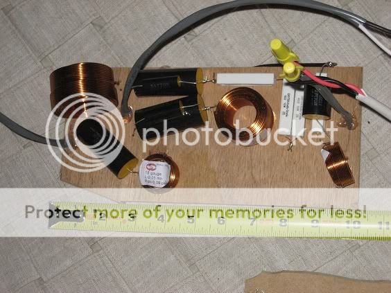

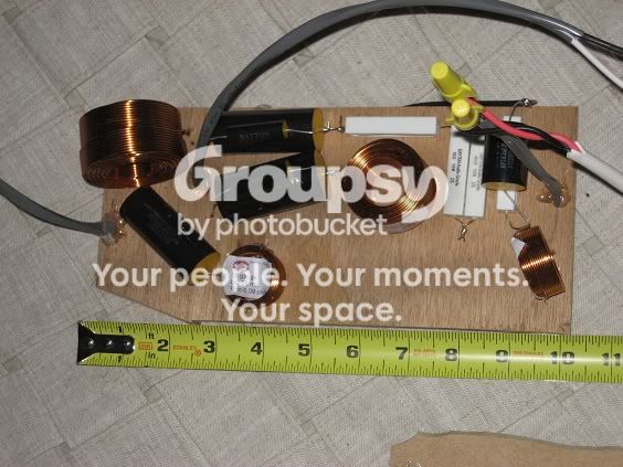

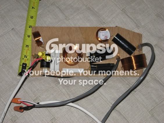

I would like to say that I built and installed the crossover after the enclosures were built for a specific reason, but I'm not sure I have one. On the other hand, by installing the crossover afterwords, you are guaranteed that in the event of a problem, you will be able to uninstall them and remove them out of whatever hole you installed them in. That's it!:D
Here's a shot of my crossover. You'll notice that I have about 12 inches worth of wire that installs directly into the crossover. I did this in case I need to remove the crossover, I would not need to take out the drivers to disconnect them.
Remember you don't have to keep your x-over components all on the same board. You could for example create one board for the tweeter circuit and another for the woofers. You could even divide that assembly up into a couple of sub components.
This is good advice. What method do you use to secure the crossovers to the inside of the enclosures? I was thinking of adding some small rubber feet to the board and fasten it using small screws.

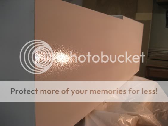

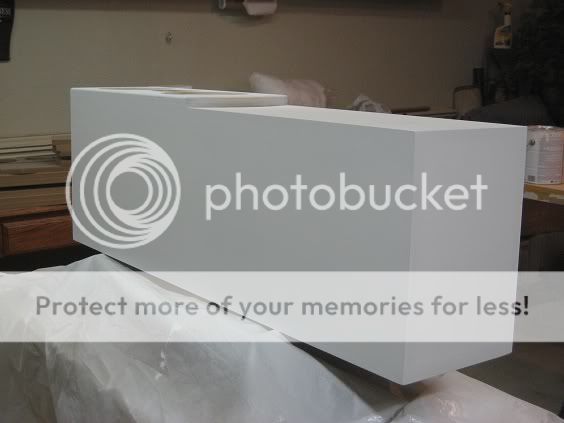

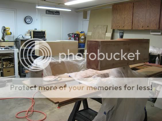

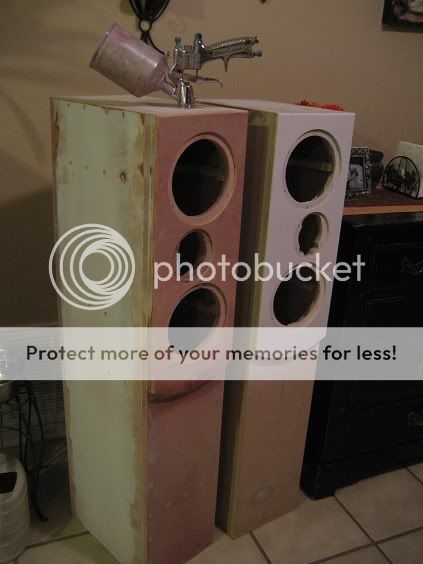

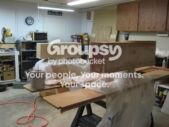

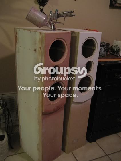

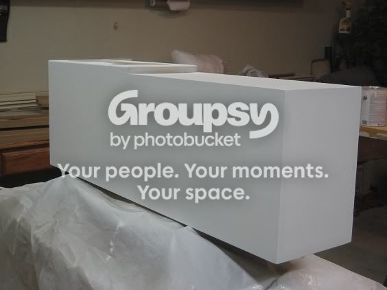

A little progress was made today. I am trying my hand at using an HVLP Gun for the first time. It's getting a little cold here and the bondo is not curing like it should. I'm letting them sit in the house for a while. Then it's off to shoot some more primer.

Where did the HVLP sprayer come from and what model is that? That toy will enable you to take the finish to the next level and beyond. A couple of my friends up here have them and I've been wanting to get further instruction on using them but getting somebody to give you that kind of time requires a worthy piece to work on ... like your speakers. ;)
Regarding the inside of the speaker I think getting as much of it sealed with anything (latex/acrylic/urethane) out of a spray can would restrict the wood from absorbing moisture from the air. I think giving it the same finish as the outside is the path to madness but spraying whatever you can hit through the port and driver cut outs makes sense to me and it's cheap and easy. Doug? ... just grow up, okay? :p

The HPLV Gun, Starting Line E-07, is a friend of mine's gun he uses for his cars. He's been kind enough to lend this to me but unfortunately, his time is very valuable and was only able to give me a quick run down on how to use/clean it.
I have done body work and painted a car back when I was in high school but it's been a while. As I recall, the majority is prep work and the painting only takes a few minutes.
I will take a brush and primer the inside the best I can. It will be hard to fit those pythons in the small holes though. :p

Sean - Thanks for the crossover board photos. 10 x 5 is plenty big. Smaller would also work, but no problems with what you made.
I used to buy those stick-on rubber feet and attach the board with a few screws. Now I make the feet with some large dabs of silicone caulk on the underside of the board.
All your work so far looks like it is carefully planned and thought out, so I hesitate to ask if you have the right tools to reach in through the woofer hole and drive in the screws to hold down the crossover board. I'm gonna guess that you have this figured out too.
Good advice on the silicone feet. I guess I'll just drill a hole on each corner of the crossover board, build up the silicone on those holes and after it sets up, screw them into the side wall with a right angle drill or a short screw driver.

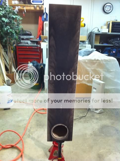

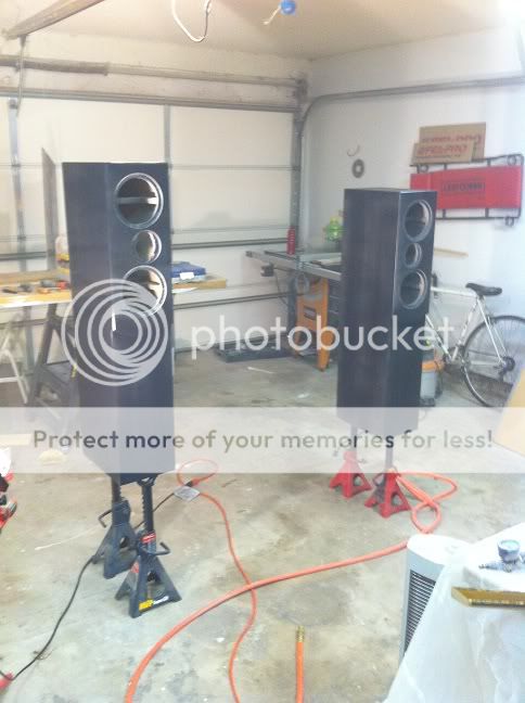

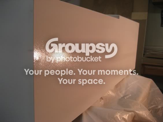

I made a little progress tonight with the HVLP gun. A friend of mine that let me borrow the paint gun went with me to Napa Auto Parts to get some good primer and paint for the enclosures. I started to purchase a quart of primer and a quart of paint but after the clerk so pleasantly informed me that my total was going to be $120 bucks, I decided to work with what I already had in the garage.
Surprisingly enough, and to all you wood finishers out there please don't flame me, I had relatively good success with using a latex primer thinned down with water (about 60% primer and 40% water) and a 1.3mm tip at roughly 25 psi. I put 2 coats on tonight and I feel like it turned out well. I think I will sand them before putting a third coat on though.
The lighting and camera are terrible but you get the idea. It's a lot rougher than I hoped for but I think I can manage. I hope once I build up the primer I will be able to sand it smooth before paint.

If the crossovers are heavy, think about using Goop if they'll never move from their final position. It sets harder than silicone and if you know what Shoe-Goo is, it's the same thing. A little goes a long way with that stuff.

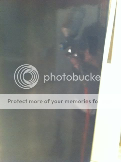

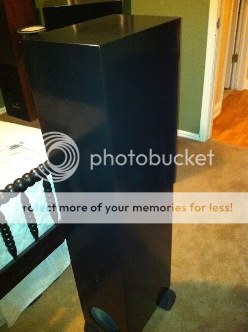

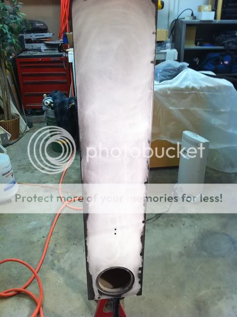

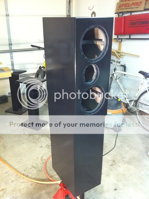

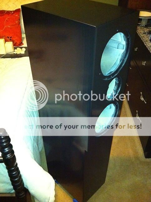

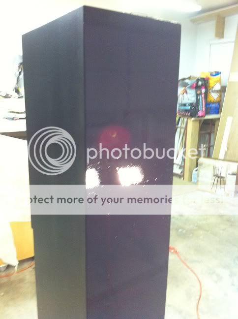

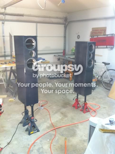

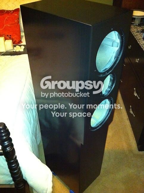

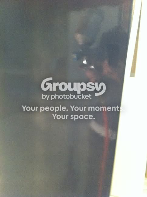

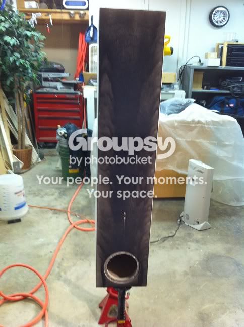

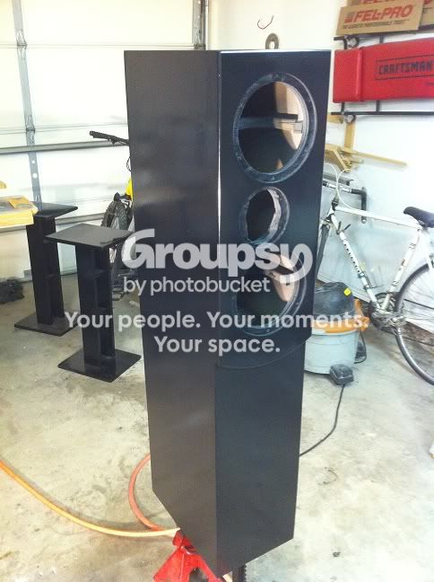

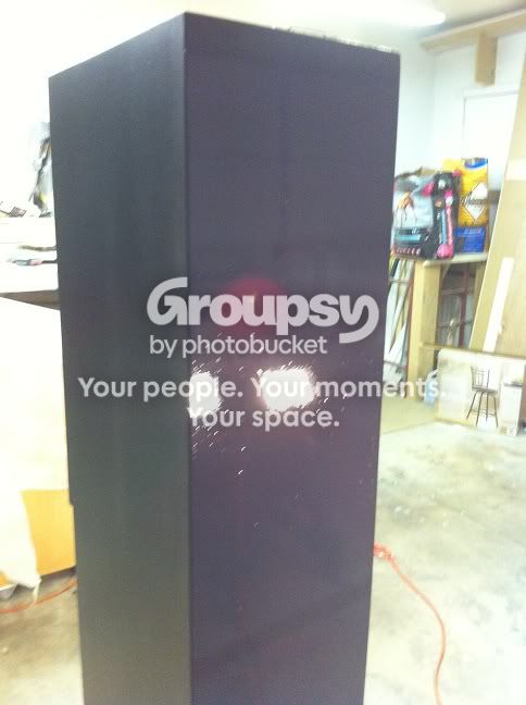

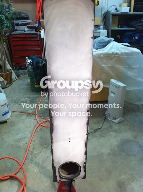

Well, it's been a while since I've posted any updates. I've been experimenting with finishes and I believe I've been somewhat successful. The two biggest accomplishments I've made in the past couple weeks are
1) Shooting primer and paint using the HVLP gun.
2) Obtaining a high gloss polyurethane finish.
The black paint I used is an acrylic, latex based, high gloss enamel. I was VERY pleased with how they came out but I was really wanting a high gloss clear coat finish. It took me a while to the water to paint ratio just right (I'll post the exact ratio next week when I get home from Utah). I started my experimenting with a 50/50 water to paint ratio on a test piece. 50/50 was way too much water and ran almost immediately. The problem I ran into, and you'll see it in the first picture below, is that the closer and closer I was to the optimal ratio, the longer and longer it took for the paint to run. So in the first picture, the ratio was just a tad too watery and even 15 minutes after I shot my test, the paint was fine so I decided to shoot one enclosure. Well, shortly after I shot one enclosure, I look back at my test piece and sure enough, the paint was running. Luckily, I did get it right. Here are some shots.
Here, I simply wiped off the paint and sanded with 220 after it dried sufficiently (it really looks worse than it is).
Here, the paint has finally dried and I am really satisfied with how it turned out. You can see the reflection of the bed in the paint. Enamels are known for being pretty durable but because this is a latex based paint and not something more ideal like oil based enamel, it is still not very scratch resistant.
