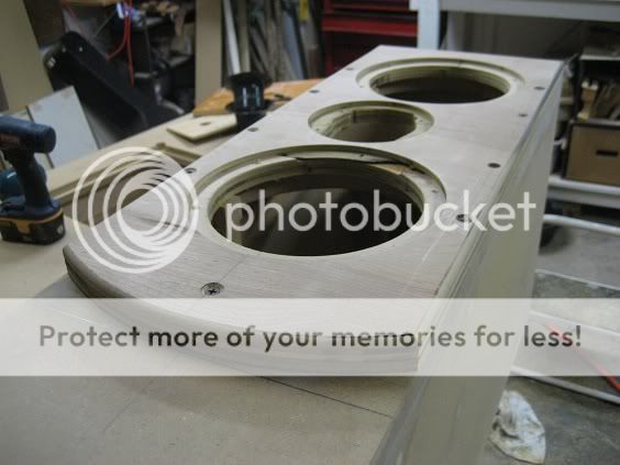

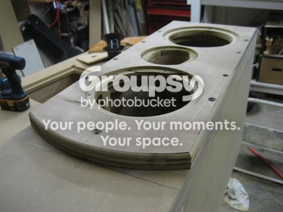

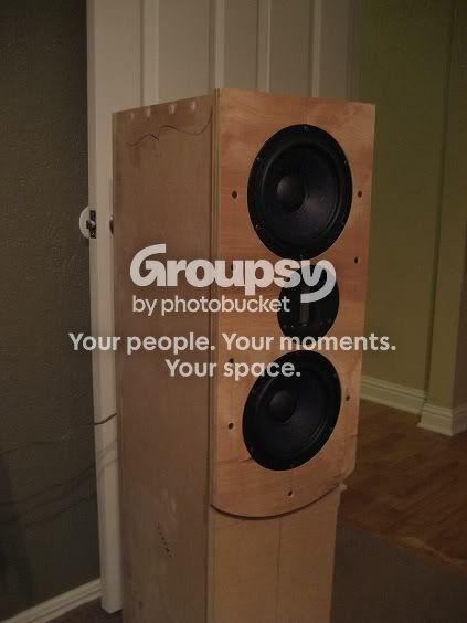

Also, is that 0.5" or 0.75" thick plywood?
I used 0.75" plywood. I think you could use 0.5" but I'm fastening the drivers to the front baffle only, so I wanted used a thicker piece.

Thanks, 7" or 8" radius for that curve will do. The front baffle of the STs was exactly what I was thinking of too.

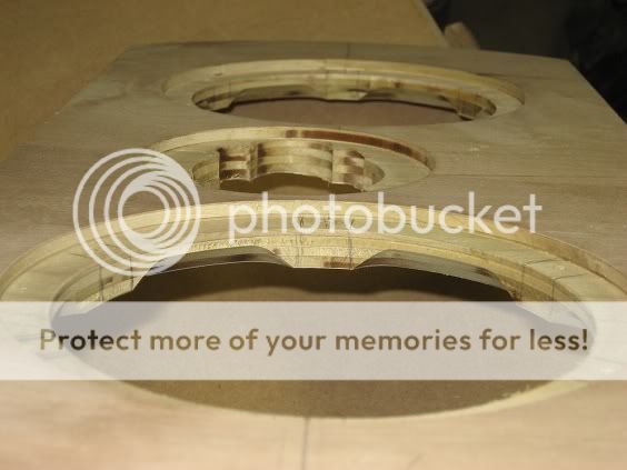

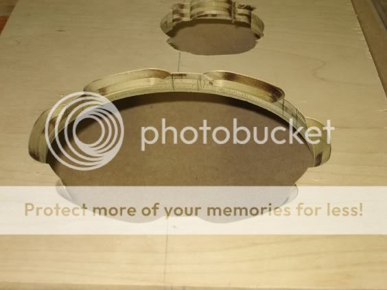

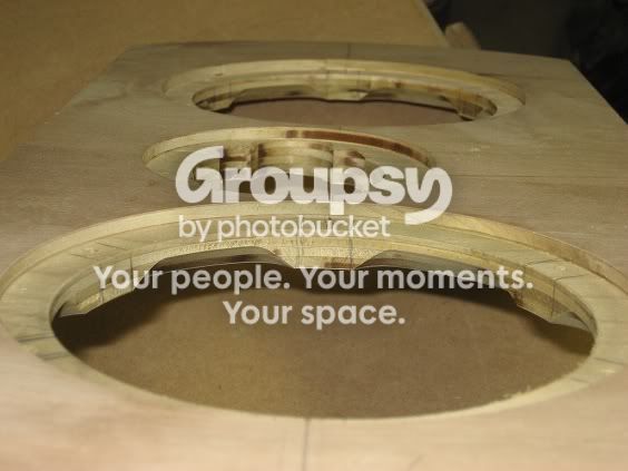

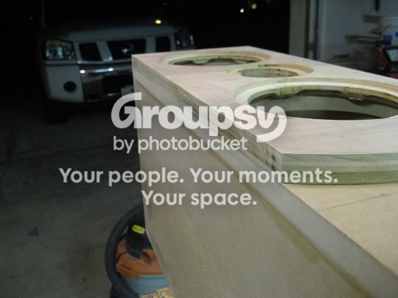

This morning I was imagining building the ER18 speakers, and I thought to mention that when you rout out the flush mount for the drivers, you have to go a tiny bit deeper than the depth of the driver flange alone. Include depth for a way to seal the driver to the baffle. Some drivers come with a compressible gasket already on the frame and others don't. It is important to mount all the drivers so there is no air leak. What have you got?
You can buy closed-cell foam weather stripping at hardware stores (PE also sells some) that has a stick-on backing. As you tighten the mounting screws, it compresses between the driver frame and the front baffle, but it won't compress to zero. So when you rout out the opening, include space for that.

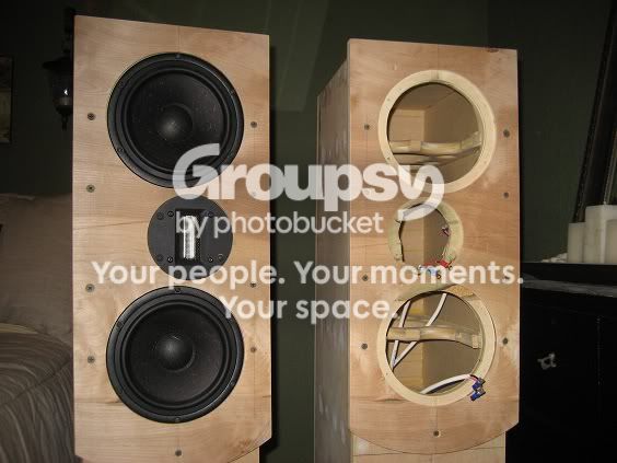

How will you fasten the drivers to one single layer of 3/4 inch ply, nuts and bolts with a larger hole in the mdf for clearance or shorter wood screws, I am very curious about this and also how the baffle will get fastened to the mdf?. I would also like to ask how the edges will be finished on that 3/4 inch ply wood baffle, thanks sawz.
Screws work fine- just pre-drill them, but I would use pan-head sheet metal screws. They have thread all the way to the shoulder of the head, unlike wood screws, which have a plain shank. For the baffle, screws work well but again, pre-drill so the sides don't split. If the baffle is inset, fastening from the sides/top/bottom will be a very strong joint. If you can, rabbet joints add glue surface and strength.
I was under the impression that the front baffle would be out proud of the sides by 3/4 of an inch since that ply baffle will be fastened to the mdf front and the drivers installed in to the ply baffle , am I wrong about that part of the design??
Will the mdf front be recessed to allow the ply baffle a flush finish with the sides ??
I would do it like highfigh said. Use black pan head sheet metal type screws. Parts Express sells both #6 and #8 3/4" pan head screws. Pre-drill the holes and drive the screws carefully. No slipsies allowed with a phillips head screw driver near woofers! If you hunt around you can find similar screws with a square drive head. They don't slip as easily as phillips head.
I imagined the front baffle as standing proud on front of the rest of the front of the cabinet, similar to the way Salk does it, and painted black. This requires a rounded over edge. With plywood, the edges will have to be sealed before painting. I would prime the edges with a 50/50 mix of wood glue and water, painted on in several layers.

I did route the hole a little deeper but honestly, unless I can find some thin foam, I think the drivers may be sticking out slightly. That's okay though, if I were a perfectionist, I would have gone to Salk himself and order the ST's :D. The ribbon does have some nice foam already on there but the others do not.
This may seem silly but it is very easy to slip up.....er... so I hear. I'm not speaking from...uh...personal experience or anything. Not to worry though, I did not slip up on these speakers, just my old ones :eek:.

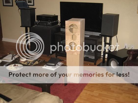

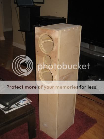

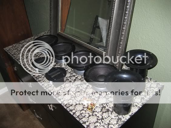

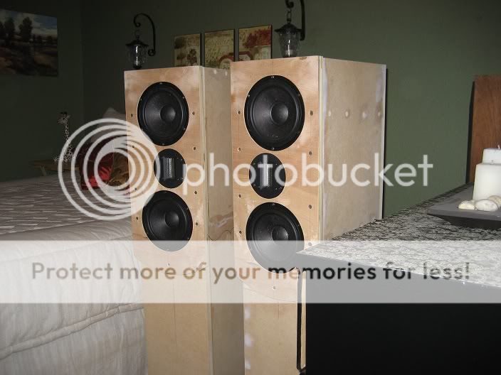

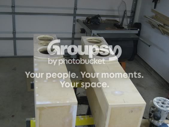

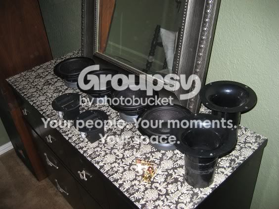

Well, sorry it's been so long since the last time I posted pictures. It's been very busy over here.
Last week sometime, I was waiting for some crossover components that were on back order, as well as the drivers. I really wanted to do something different this time and totally finish the enclosures before assembling the speaker, something I did not do on my last builds. But, curiosity got the best of me when the drivers and inductors came in the mail the same day. I stayed up until midnight assembling the speakers and was so excited, I left out the stuffing and fired them up. After about 2:00am, I realized that I still have to work the next morning and that my poor, sick wife was still trying to sleep. So as they sit now, the baffles need trimming, the drivers need foam to get a good seal, pillow stuffing needs to be added and the enclosures need some paint. The problem is I still can't stop listening. I'll get to the listening impressions later (when I can scrape my jaw off the floor). It's late and I need my beauty rest.
Parts Express sells two sizes of closed-cell gasketing tape, 1/8" × 1/2" and 1/8" × 3/8", and also sealing caulk which might be thinner. Probably the last thing you want to do is order more stuff from them ;). You may find some suitable weather stripping in a local hardware store. It is important to install the drivers with some kind of air seal behind them. I would avoid using silicone caulk as that seals too well, making it hard to ever remove the woofers.

Thanks for all the photos. They're looking good :D! Nice job chamfering the inside of the speaker holes in the baffle.

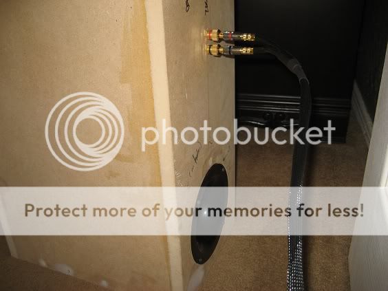

You can mount the port on the front or back without any problem, but its opening should be centered 3" above the floor of the cabinet with the tube parallel to the floor. If you change the distance between the top woofer and the port, you change the bass tuning of the cabinet. What you propose may or may not change it by much, I can't be sure, but I'd leave the port exactly where it was intended.
This cabinet design, with the rear port, has been tested as close as 2-3" away from the wall behind, and the bass doesn't sound significantly different than if 2 feet away from the wall. In fact some people who listened said they like the sound closer to the wall, saying it made the bass sound a bit tighter. These TL speakers behave differently than standard bass reflex designs, and one of its advantages is that it allows greater flexibility in where you can place them.
Also, the original design was intended to be mounted on a roughly 2" high platform or plinth (board and spikes) that puts the tweeter at ear level. If you make it taller, that would change things. Again, it may be a small difference, but if it ain't broke, don't fix it :D.

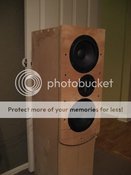

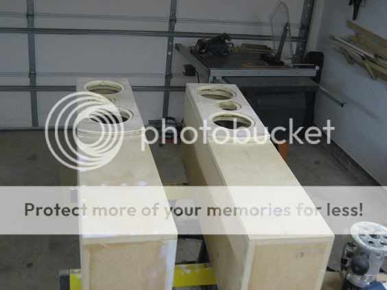

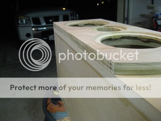

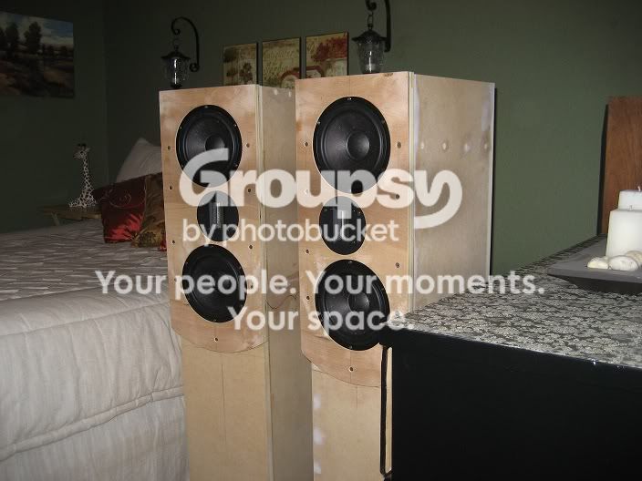

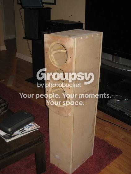

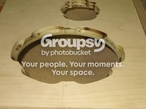

This was very hard for me but I finally got a spare minute to disassemble my speakers to start the finishing process. I made a big mistake when I was building these. I got a little ahead of myself and glued the front baffle on before I got a chance to trim it and put a nice round over on it. I did trim the baffles but was only able to put a 1/4" round over on them, not ideal but will do.
In this shot, you can see I used the flush trim router bit to trim the overhang.
Here you can see I've put a 1/4" round over on the front baffle. I could have used a larger round over bit everywhere except the bottom edge (would have looked strange though). The larger round over bit is too tall and comes in contact with the MDF.
In this shot, I have filled all the screw holes and now they're ready for primer. They say that whatever treatment the outside of the enclosure gets, the inside should get as well, otherwise there will be two different expansion rates. I'm going to say no thanks to that.
