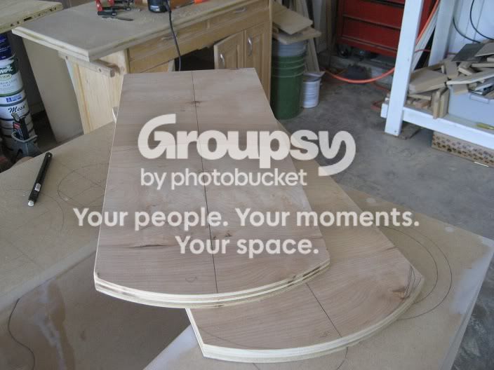

Here are some pictures of the front baffle.
Sean
On that outer front baffle piece, what radius did you use on your jig when you cut rounded lower edge? I like the look of that curve. When I made the diagram, the radius of the curve was shorter, and it looked wrong to me.
Also, is that 0.5" or 0.75" thick plywood?
I used a pensil and string and had to play with the center point and the length until I got the curve I wanted. I then measured the string. I want to say the radius is about 7 or 8 inches but I cannot be for sure. I'll have to remeasure. I had to look up pictures of the ST's to get my inspiration. The diagram you drew puts the diameter at 9 inches, the width of the speaker. It looks okay but it would be hard to actually do. Seeing as I don't have a nice circle cuttin jig, I would not have been able to make it look good where the arc joins the edge.
