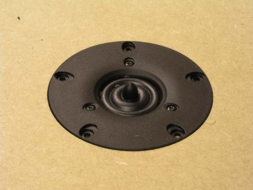

Flush mounted: does not hang over or protrude from the surface. Not change in outer thickness. Countersunk.
Swerd
Swerd
:) Sorry for that. As You guessed I mean- change the faceplate in neo cd 3.0 from round one into a shape of rectangular or square/ like it is in NeoCD2.0 or NeoX 1.0.
The crossover was designed using the Fountek NeoCD 3.0 with a round face plate, 110 mm in diameter. If you use any other ribbon tweeter, a new crossover must be designed. This requires measurements of the new tweeter installed in an ER18 MTM cabinet.
I want to keep all dimensions ( and flat front of loudspeaker/ not like it is in 882/880- tweeter deeper than woofers), but I would like to move the tweeter in the middle in one vertical line.
I heard that there is some program that can calculate what changes should be made in original crossover, so maybe it will be possible without loss of quality in sound.
Moving the tweeter to the middle probably will not make a major difference in sound.
I don't know of any program that could predict what crossover changes might be needed. Only real measurements can do that.
Ps. Sorry for my english :cool: what do You mean saying "flush mounted"?
A "flush mounted" face plate is sunk into the front of the speaker cabinet so its edge is smooth with the front of the cabinet, similar to this picture:

Thanks for answers. I don`t want to use other tweeter, but original neo cd3.0. As it is show on the picture, that tweeter is sunk ( drilled with router), so I think that it should not be a problem if I will use new rectangular/square faceplate on neo cd3.0 tweeter, because it will only change the overal appearance of whole loudspeaker. It will also be sunk, so the whole front baffle will be flat( like in this post #47). Hope that I am right with everything.:rolleyes:
