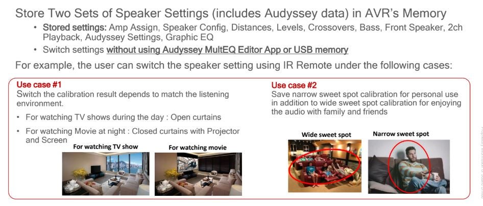

A new preset Audyssey memory mode allows owners to store two Audyssey configurations and switch between them on the fly, too.

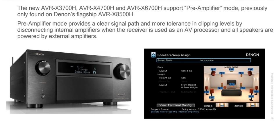

Last but not least, Denon has trickled down its ‘Pre-Amplifier’ mode from its 2019 flagship AVC-X8500H to the new AVC-X3700H, AVC-X4700H and AVC-X6700H. Pre-Amplifier mode provides more tolerance in clipping levels by disconnecting internal amplifiers when the receiver is used as an AV processor and all speakers are powered by external amplifiers.
This is exciting news!
Did you get the trickled down pre-amp mode from a reliable source? If true, I bet @gene may have something to do with that bonus feature.
Wonder why this took so Long. The pioneer that I use in my BR has had that for a long time.
Yes. Gene is going to talk about it in the live youtube video which starts in 1hour! :)
Audyssey uses FIR filters that requires more processing power so I suspect it would also require more storage space if multiple profiles are stored and can be selected at will. With storage and DSP engine power improves over time, I bet it won't be long before D+M add that very feature, that is, the ability to store multiples (>2) profiles.
