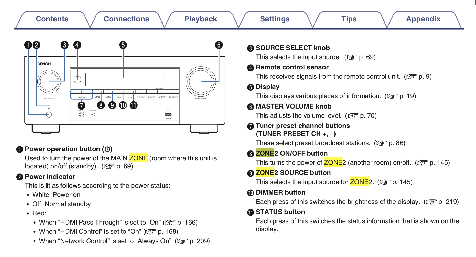

I have a 2700 and I can't see where to deactivate or turn off the Zone 2 :(
When you press zone 2 or zone 3 on the remote, you’re switching over to that zone and can control it with the remote. When you press either zones, you can press the power off button to turn it off. You should also be able to go into the receiver setup and disable those additional zones. Or download the HEOS app and you can turn it off there too.

I have the remote Denon App, but can't figure it out. The 2700 has 2 zones, when I turn it on or off, on the remote ou the App it only affects the Main Zone, the AVR keeps in Zone 2 and doesn't power off

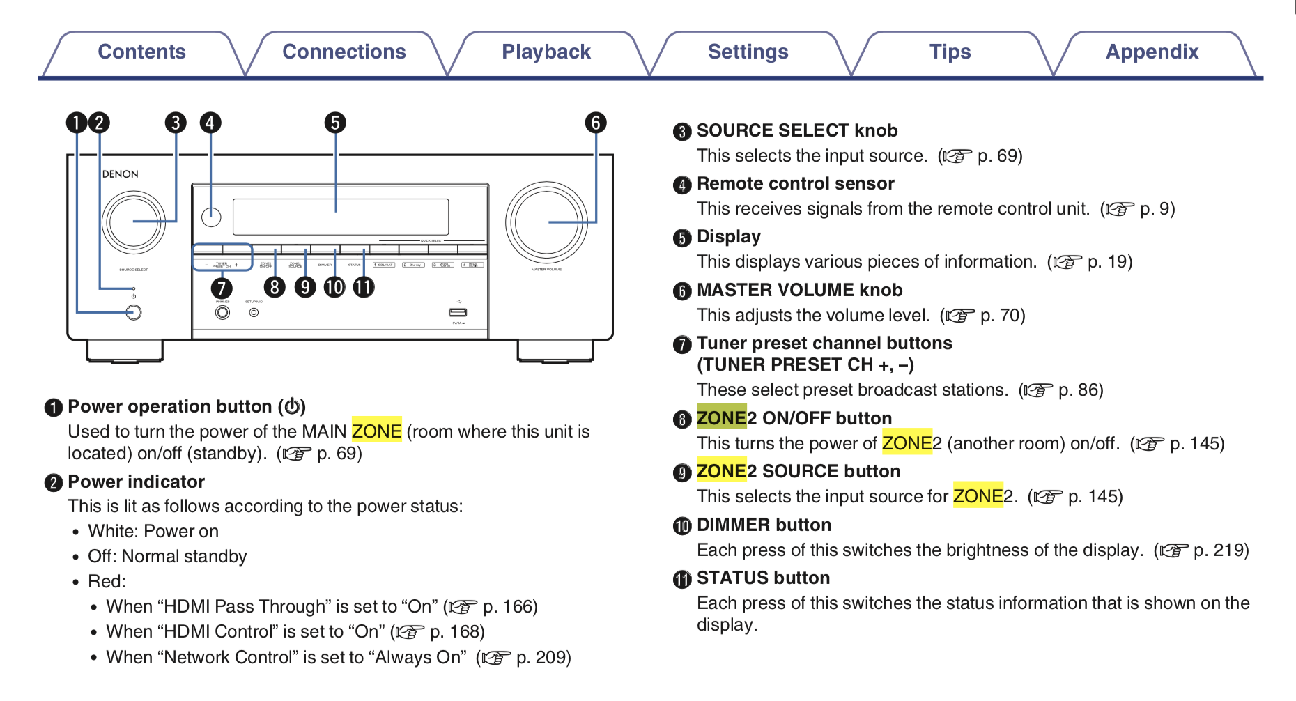

Page 17 of the manual shows an on/off button for zone 2. It's marked as #8 on the front panel.

Thank you very much for the help, I have it for 24 hours and it's my second AVR and my first Denon!
