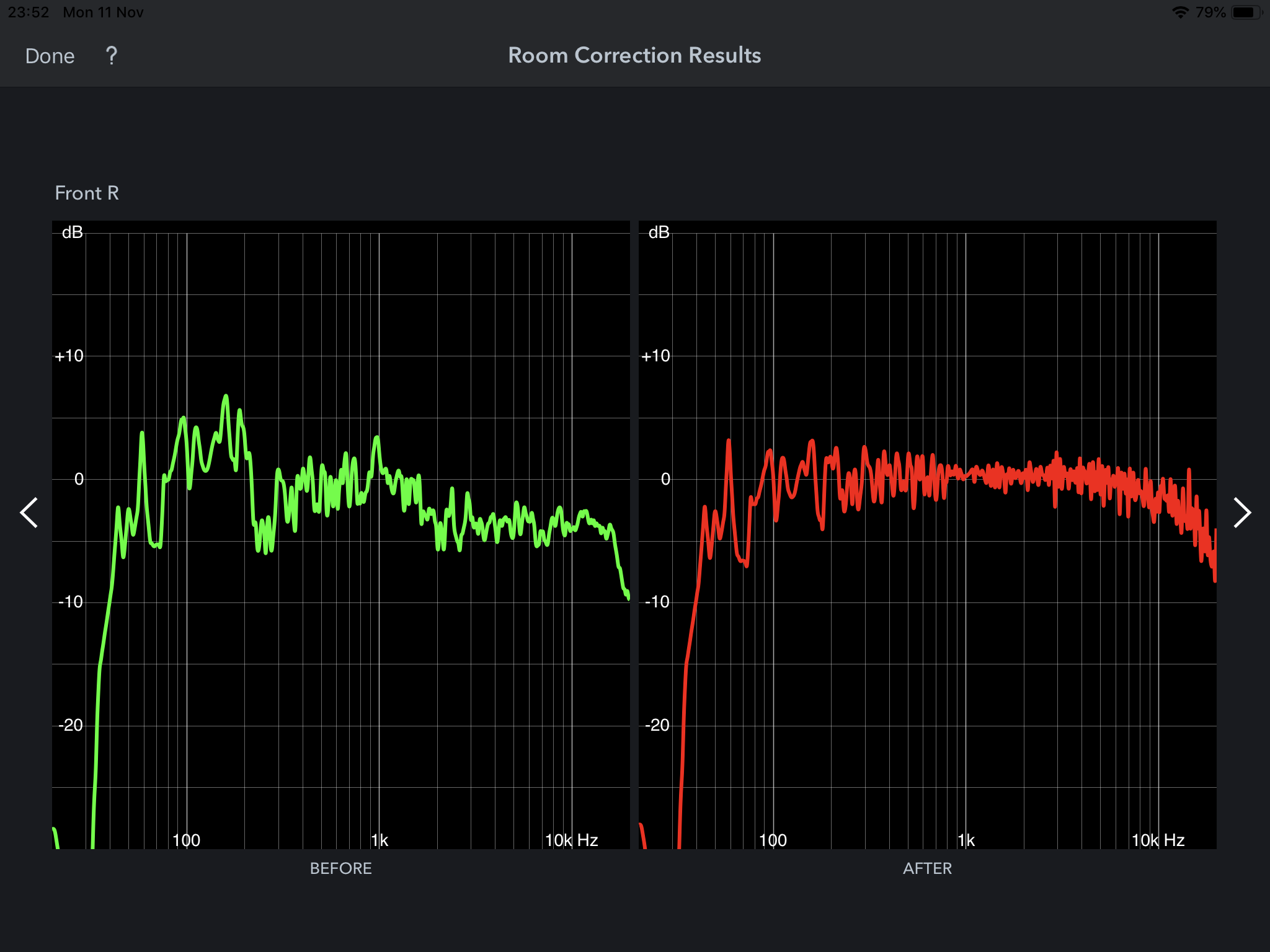

Now... you asked about the Schroeder Frequency. Look at your graphs, the green ones, what Audyssey measured. Though they are all rather jagged, you should be able to see the change that occurs on your center and mains right around 200Hz. This is approximately where the Schroeder Frequency of your room lies.
So what to do... but first, a side note.
Your left main is a mess. Unless you have connections crossed, I’m gonna guess that that is the one smack up against the wall. Compared to the right, you can see the diffraction in the measurements. Whether it is audible, I can’t say, but visually it is there. This is why many suggested that you try to rearrange some.
Ok, back to the other.
Your in room response, according to your Aud measurements, is rough. They all look jagged, but yours is a little more jagged than others I’ve seen. You likely are benefiting from having Aud work full spectrum. If your response was a little smoother, I would say you could experiment with using audyssey below the Schroeder Frequency, which you can set through your app.
Now, since you have the app... if you really wanted to look deeper, that is where Room EQ Wizard would come in. It’s not necessary, and will only be worthwhile if you want to tinker.
That said, my guess, based on poor memory to be certain, is that you have a lot of reflections in your room that are bouncing soundwaves all over the place. You could get a rug for the floor in front of your speakers. I would rearrange and get your left speaker away from that wall, and maybe even put some kind of absorption/diffraction panel on that wall at the first reflection point.
And yes, even though I said I wasn’t gonna beat the horse... I’m gonna nudge gently... that Subwoofer needs help. :)

As I said, until you can clean up your overall room response, I think you are better off using Room Correction for the full range REGARDLESS of whether it is Audyssey XT or XT32.
If you can get your room to be a little more friendly to the sound and are able to tame the Frequency Response you see up high, THEN AND ONLY THEN would I suggest using the XT32 App to adjust the Correction Range downwards. This is done using the "MultiEQ Filter Frequency Range" option when you are in the actual correction file. If you choose to use this, Audyssey will not correct above where you set the limit. I would shoot for 250Hz in your case, based on what I see from what you posted.

If you look at a speaker chart from the manufacturer, it is very smooth and pretty. Right? Unless you have a special room, you will never see that in real life.
When we look at these graphs that we create with our own measurements, they are never as pretty. There are many variables that affect this. We have discussed this with you before. Things like how close to a wall, is there carpeting, are there other hard surfaces that the sound is reflecting off of... these all contribute to the problem you are experiencing.
Little by little, you should look at your room from the speakers perspective. Some reflection is necessary, but too much is bad. an example using your Front Left: Sound will hit the left wall, the floor, the right wall, and the ceiling, all at different times, and then it will go to your ears, all at different times. To combat this, we have suggested getting away from that wall on the left and using a rug. These two actions would change the way the sound interacts with the room.
If I were to do this, I would first look hard at how I have my equipment arranged and try to find a better way to set it up. Maybe you cannot, but that is the FIRST thing. Once I did that, I would measure.
Then I would look for solutions to help smooth things out more. Carpet/rug with a pad underneath on floor in front of main speakers. Other room decorations to help absorb sound. And so forth.
Your environment has a very significant impact on your speakers. The absolute best, most expensive speakers can be ruined by bad placement. While mediocre speakers in the same room could possibly sound better.
