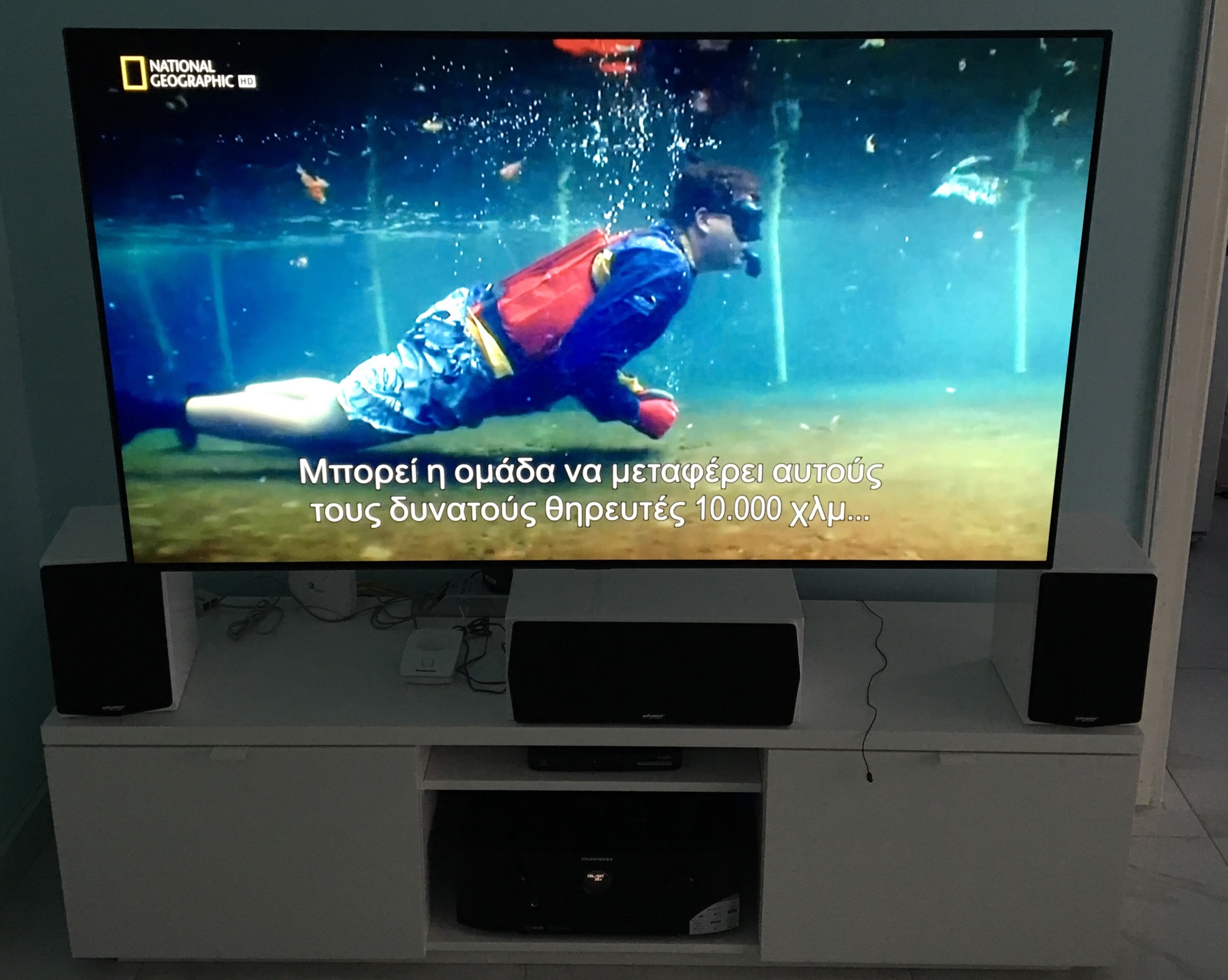

Hello. https://forums.audioholics.com/forums/threads/İs-my-subwoofer-faulty.115849/. My setup is this, check out info. And audyssey settings.

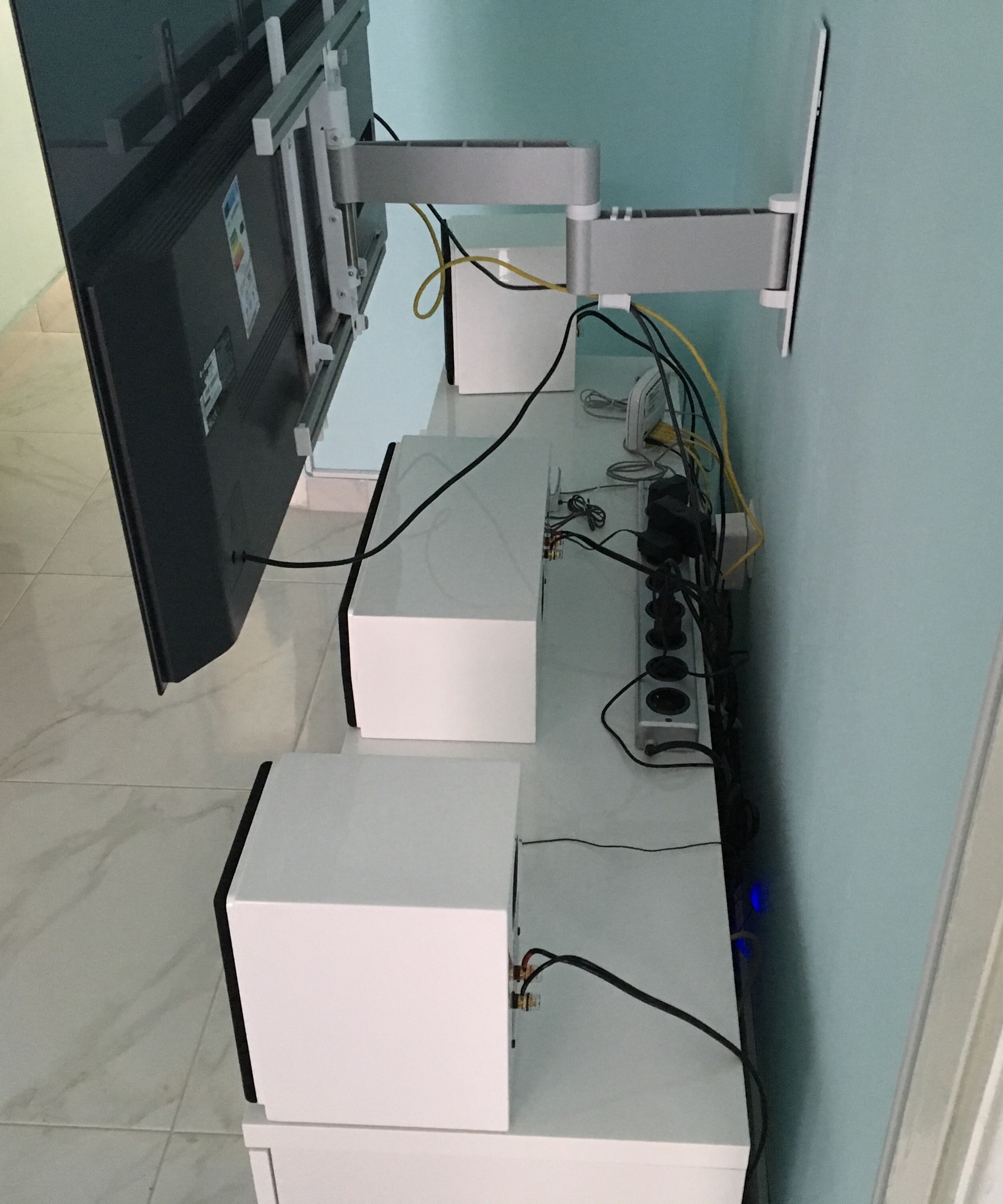

The left speaker is has 29cm distance from back wall, the right 27. The center something like this.
My sources are netflix(ultra hd) for movies and apple music(paid account) for music.
1) netflix doesnt play loud at all. My volume is at 83-86 out of 98 i think. I am pushing the volume to its limits almost. Is this correct to raise it so loud?
2)apple music plays some louder, something like 75/98 i think. But still the result at high volume is some “muddy” i think.
Any help plz? o_O

How high off the ground are those speakers? The tweeters should be about ear height. Did you run a proper setup? You have Audyssey, right? A good subwoofer might help things too, allowing your speakers to play more cleanly at louder volumes. What kind of a crossover are you using? How far away do you sit?

A throw rug in front of your setup might go a long way too. Is there a doorway to the right? I'd want my speakers spread a little further apart and up higher too. You might even consider moving some stuff around and relocating your setup. Also try a higher crossover.

The tweeters are not on my ear height, they are 30-50cm lower, depends how i seat. What am i gonna do now buy bases? Or different tower speakers and put to the ground?

The distances are on the link 1#post, i have picture from audyssey. Genrerally 2.7- 2.8 meters from speakers.
What is this throw rug tour are talking? Can you show with picture? My english not that good. I cant spread them more, i can place the right speaker, 3meters away from tv, and it will go away on the other corner of them room, with a 10meter cable.
Yes dooorway to the right and in front of the left speaker another one. Check out the second picture you can see it.

Yes, higher than 80 hz. Yes, I'd recommend stands for your speakers so the tweeters are at ear height. That's going to make a pretty big difference, imo. Here's what I mean by a throw rug.
That will help absorb early reflections that you're getting from that tile floor. Might help clean things up. The rug, a higher crossover and raising your speakers up should help quite a bit.

This speakers are front ported, do i need this to avoid walls? The first post i say the distance from wall.

Well, you don't have to get those exact stands. I just posted the first image I found to give you an idea of what's available. Front ported speakers will tend to behave a little better than rear ported when closer to a wall. Almost any speaker is going to perform better the further from the wall you can get. Not everyone has the room tho, I wish I could pull mine out a little more too, but we work with what we have sometimes.
You have a hard tile floor. The sound from your speakers is bouncing off your floor and walls as well as coming directly from your speakers before reaching you. This can muddy up the sound because it changes how it reaches your ear. A throw rug in from of your speakers will absorb that and prevent some of that bounciness from happening. If you have a thick blanket or something you can experiment by spreading it out on the floor and see if it helps. Maybe fold the blanket in half or something.

Pogre is on it... you do want the Tweeters to be as close to (or just below) ear level as possible. The soundwaves from the Tweeters are much more directional than lower frequencies from Woofers or Subs.
In terms of clarty of sound, it is common to recommend the Crossover (XO) to start at 80HZ, but important to know is that you also want to consider the lower frequency of your speakers. Example: if your little speakers are rated at 60Hz on the low end, you should consider 100, 110, or 120Hz for the actual XO.
LPF for LFE @120Hz is perfect, no need to change that.
Now the mouse in the room (not an elephant!)... Those speakers are TINY! In a small room with moderate listening distance and SPL (volume), they may be fine, but you will likely have a very difficult time pushing those to Reference level with good quality sound. I hope I am wrong! But is would be worth exploring in the long run, how you can upgrade because my instinct tells me you undersized yourself.
One last note is diffraction. Pogre suggested not just raising the height, but also changing distance between the speakers. IF POSSIBLE, this is a very good idea and will help eliminate the soundwaves diffracting off the TV Screen which may also help you attain better Sound Quality. Also, a Rug or Carpeting on the floor between your Listening Position and the Speakers!
