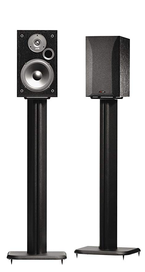

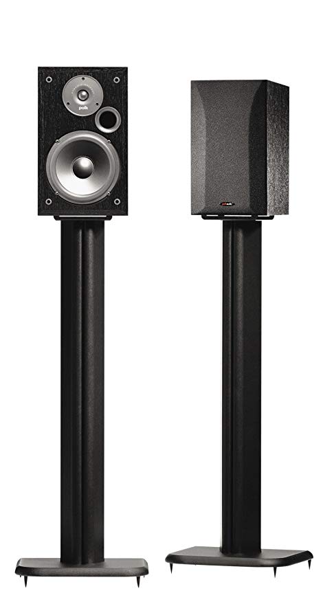

Yes, higher than 80 hz. Yes, I'd recommend stands for your speakers so the tweeters are at ear height. That's going to make a pretty big difference, imo. Here's what I mean by a throw rug.
View attachment 31607View attachment 31608View attachment 31609
That will help absorb early reflections that you're getting from that tile floor. Might help clean things up. The rug, a higher crossover and raising your speakers up should help quite a bit.

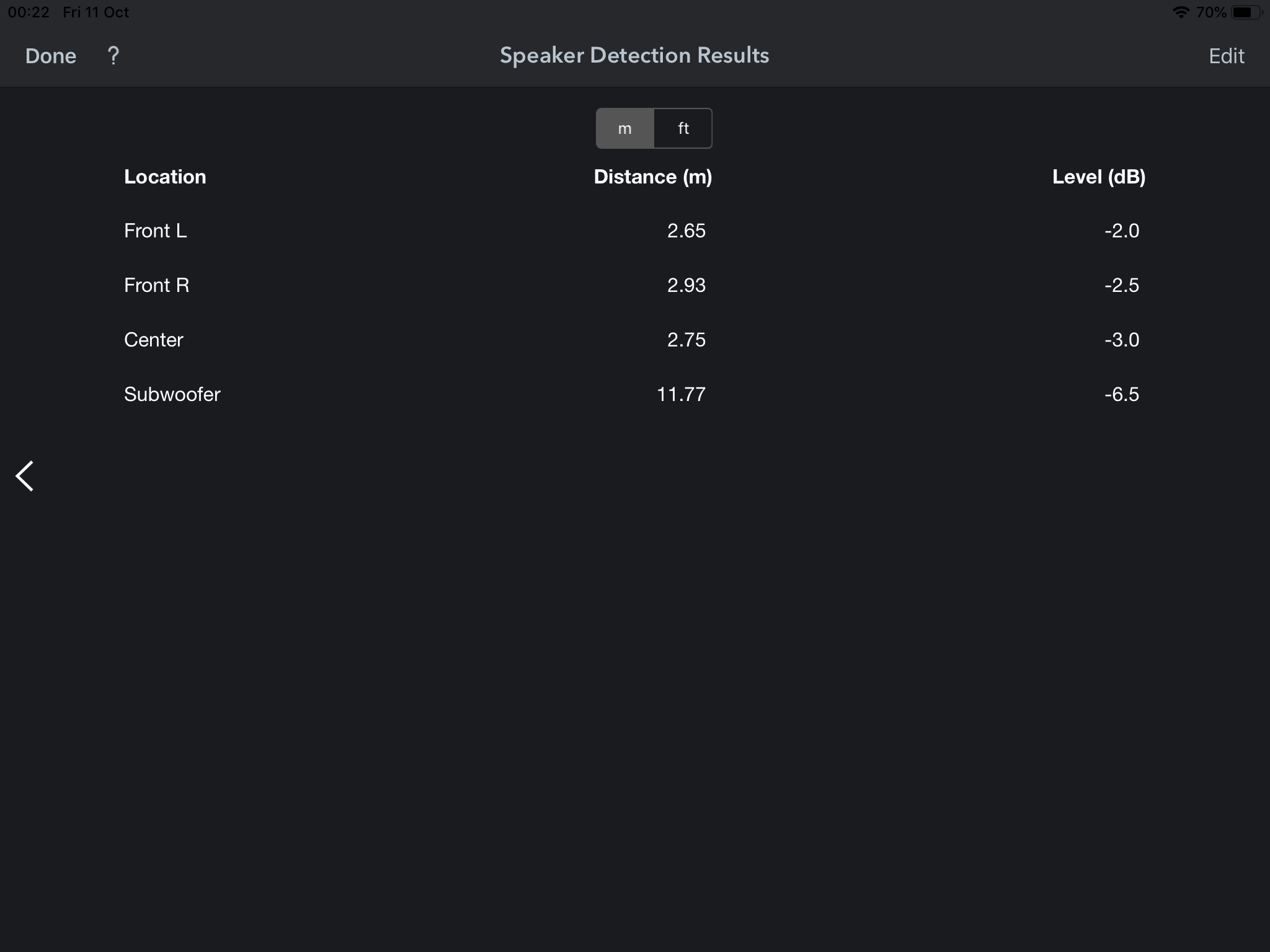

What am i puting? Tell me new numbers
Go into your AVR and try raising the levels of just your front three speakers by 3 dB, maybe. All of mine are In the negative, too. but it might help.
Also, even if just for the short term, change your volume display to relative instead of absolute. This will put it in terms of decibels below and above reference level. It will be easier for us to talk SPL. If you are turning it up to +10, whereas most of us listen at -10, say...
G
Grandzoltar
Audyssey calibrates for reference volume levels that’s why Audyssey gave each speaker its dB value. You don’t need to add dB to individual speakers so you only have to turn it up to 60 out of 80. There is nothing wrong with 80 of 100 it’s not hard on your receiver. Keeping Audyssey dB values you are less likely to blow a speaker when you turn the volume to reference levels because of Audyssey target SPL

This is what I wanna know.
@killbill13 Why are you showing us calibration levels? If it's not loud enough, turn it up...
I am answering to both of you. I am raising the volume to 83-85 to enjoy a netflix movie. Out of 98. I wonder if this is normal or i have bad settings or a faulty speaker or a faulty aplifier.
I am showing levels because i dont know what to put instead of audyssey numbers. Someone proposed me to add 3.
And yes i did. It breaks the sound and i get a volume increase also.
