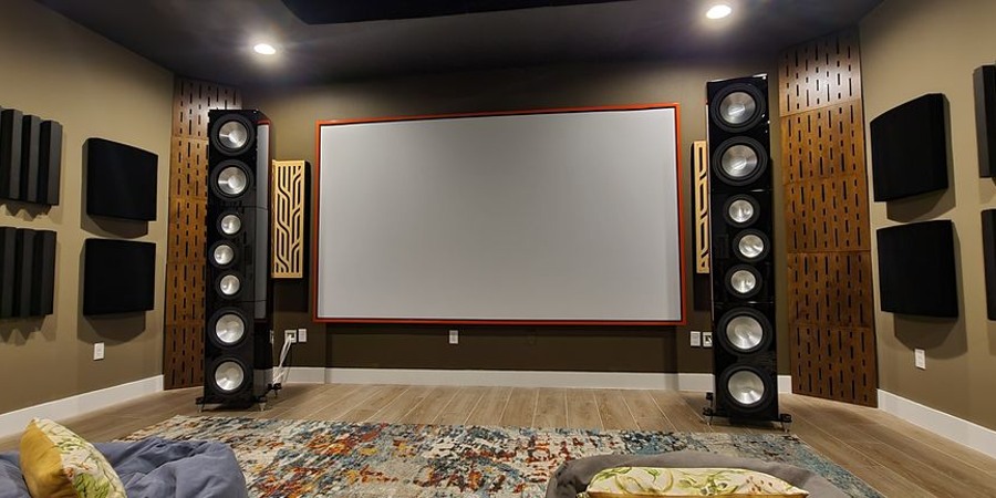

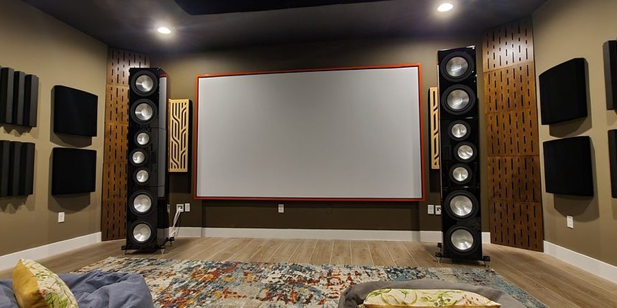

Even a high-quality home theater can deliver underwhelming two-channel audio playback, but it doesn’t have to be that way. Here we discuss some of the common problems that Audioholics founder Gene DellaSala has come across when helping others achieve audiophile level two-channel playback from their home theaters. We’ll also look at how to build a home theater around an existing two-channel system.
Topics of Discussion Include:
  1. Bad Speaker Positioning
  2. Excessive Room Treatments
  3. Bad Subwoofer Integration
  4. Bad Seating Locations
We also discuss how to expand an audiophile 2CH system into a great home theater.
Read: Can You Get Audiophile 2CH Sound from a Home Theater?

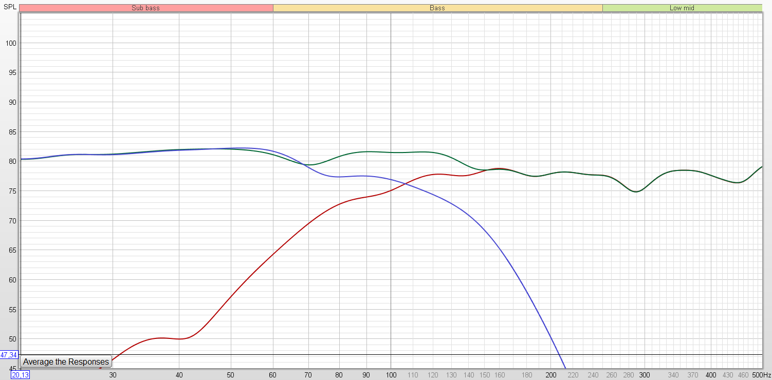

I think you have raised the fundamental issue. The crossover between subs and the rest of the system, and especially the mains, is to all intense and purposes an "off the shelf" crossover. The likelihood of a bad result is much higher than a good one. If you have three way main speakers, when you add a sub you have a four way system, and if two way mains you have a three way system. That means speakers and sub need to be designed as a single system from the start. That has always been my approach, and it is an absolutely crucial issue in my opinion.
Sigberg audio seem to agree. They are designing their subs as a total system. That is the correct approach.
Look at their sub integration. The crossover execution is superb.
I find the Sigberg design approach refreshing. In many ways, it is because they a going down many of the same roads I have travelled for years, sans the cardioid venting. However to return to the issue. That is how the cross to a sub needs to look!
