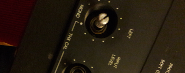

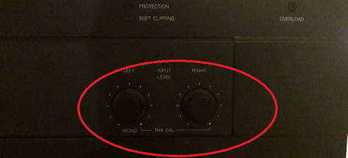

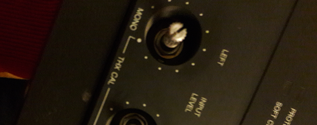

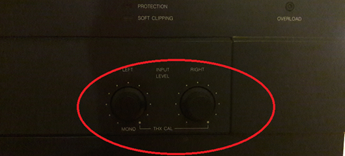

1. The Problem
These two potentiometer make so little contact that the channels loose signal for most part. You can barely find two or three positions where the speaker picks up the signal.

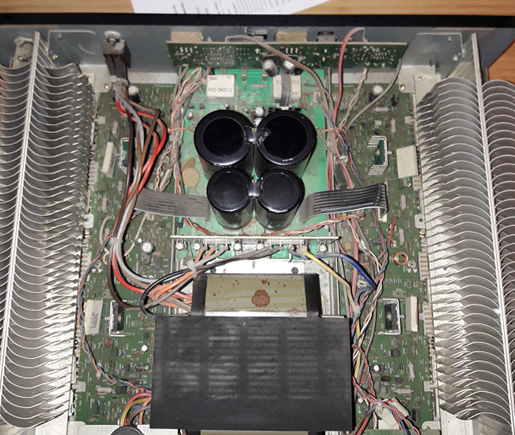

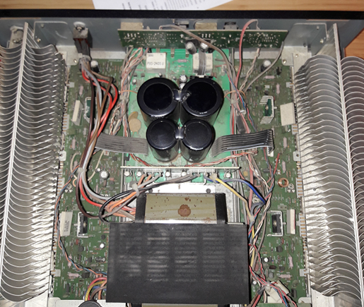

3. Under the hood
The hot glue gives it away; I’m not the first one to open this amp.

1. The Problem

3. Under the hood

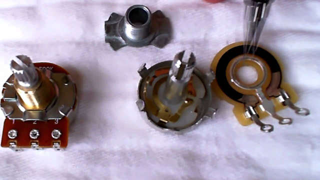

Thank you for the advice. I'm opening them, though. As I said, I have a long experience behind me of all sorts of different shops doing what you recommend, charging it, only to have it behave exactly the same after 3-6 months. I'm just tired of that. When I brought it in to the shop for like the 8th time to be cleaned (you might remember it, it was the old Technics which I wanted to use as a power amp because of this exact same problem - to bypass all the knobs) they started with some story about the metal inside the pot simply been worn thin over time and that's why they can't do anything (which sounds like bollocks to me, but... until I prove it).

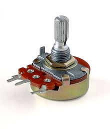

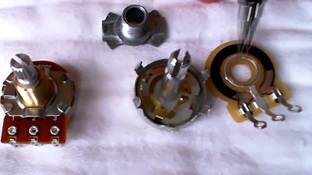

It roughly looks like this:
So the bottom basket should be easy to remove. I am aiming at this:
This is what would satisfy me the most. Clean like new.
