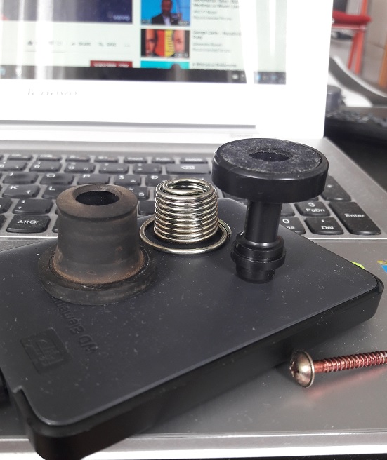

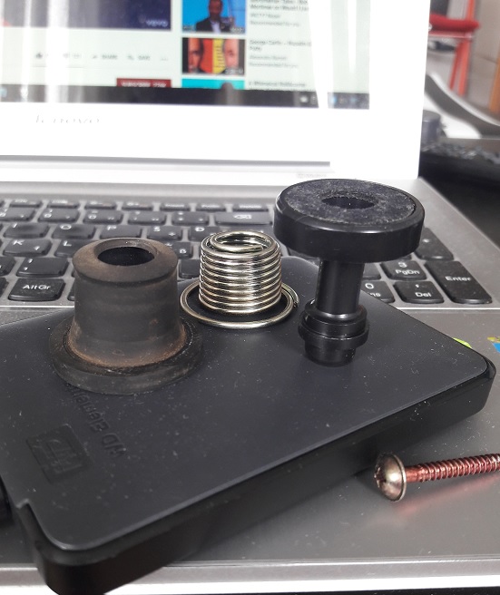

I doubt it, this is what I have beneath:
A spring, a foot and a rubber bell to go over the spring.

As far as the pics go, can't enlarge them to where I can see any details of the feet. Description of construction sounds a bit different altho probably not a lot but don't want to take mine apart (can't see the whole mechanism without doing so). Like these https://www.ebay.com/sch/i.html?LH_CAds=&_ex_kw=&_fpos=&_fspt=1&_mPrRngCbx=1&_nkw=technics+1200+foot&_sacat=&_sadis=&_sop=12&_udhi=&_udlo=&_fosrp=1
It's a thumbnail, just click on the image.
Now I can expand them, might not have given enough time for the photos to fully load the first time....slow internet has made me see many a video as only a still....
Looks to be a different type.

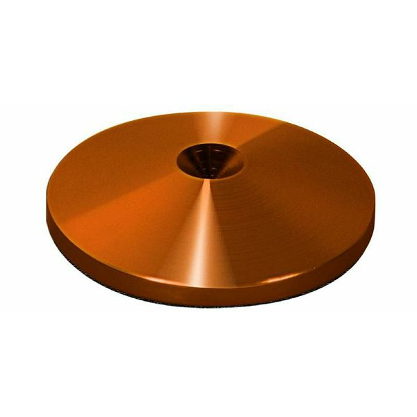

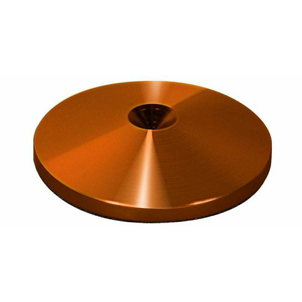

Sometimes I really enjoy when it ends up like this; it seems we were both right, but speaking of different spikes. Sharp spikes underneath the speaker stands and underneath SW are meant to anchor the speaker. But then, there's this type, which I was talking about;
