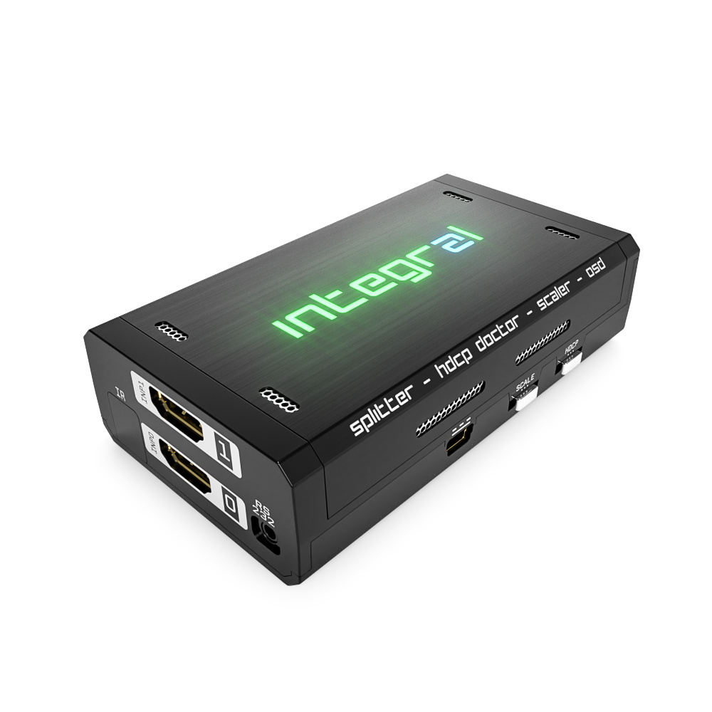

Something like this could help though it may only pass 4k60 to your tv and not higher frame rates.
There may be cheap splitters at Monoproce that could do it too.

There are a number of splitter/scalers on the market which may work out nicely for you. The EZCOO stuff is also recommended and does a good job.
But, I would probably just use the optical audio output from the TV to the receiver for the time being. See how happy you are with the sound, then decide if you want to spend more on a HDMI scaler/splitter unit.

This is the splitter that Outlaw was making for the 975. It's currently discontinued. I guess I would need one that does the same thing that this one did? Are any of the ones you guys recommended above like that?

I haven't tried the EZCOO stuff but that looks like the best value. I have used the HD Fury devices but those cost at much as buying a proper receiver.
