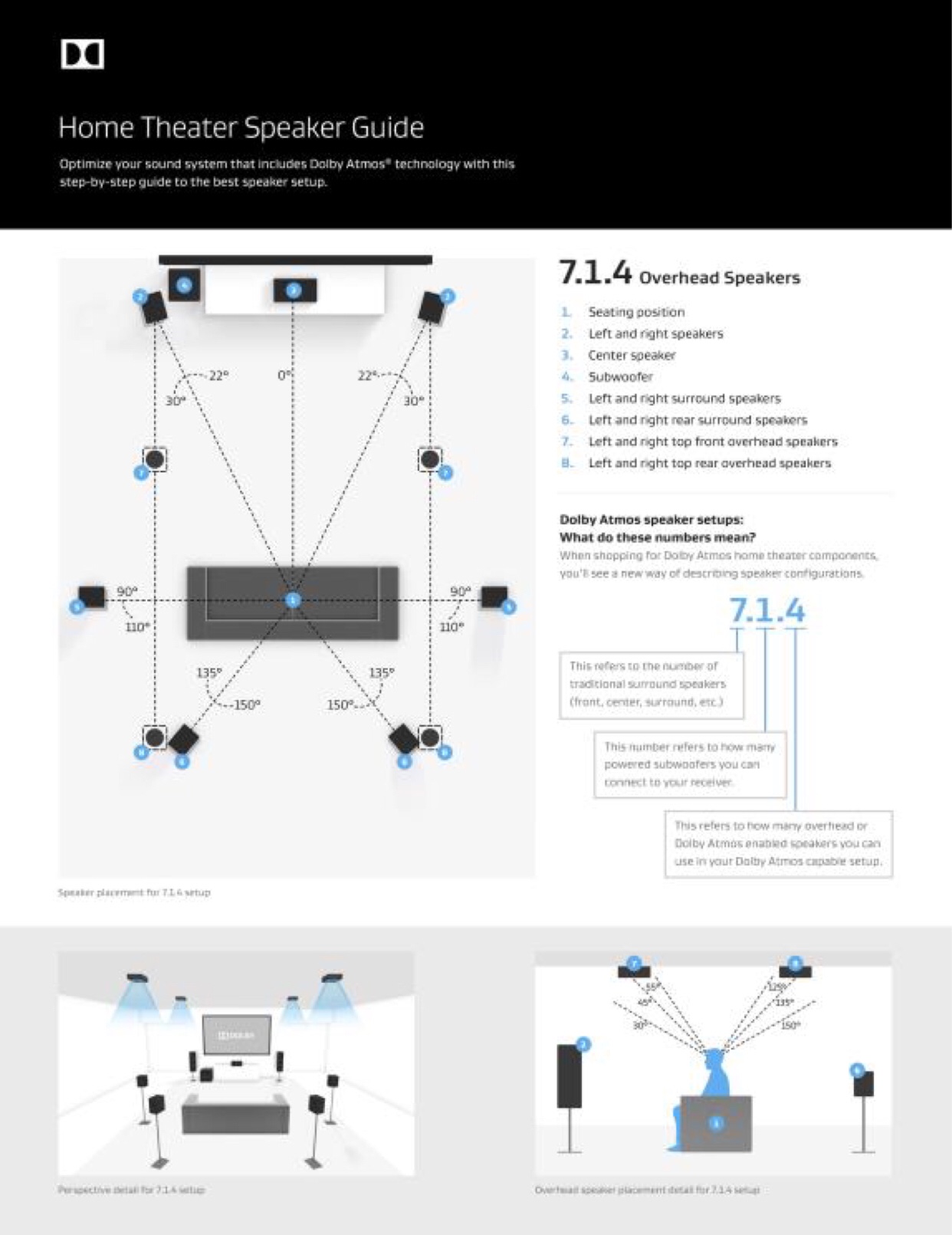

If you have not done so already google Dolby Atoms White Paper dated July 2017. I think this will answer most of your questions.
fwiw, without knowing the speakers characteristics I would mount them in the traditional locations as marked on this pic and if possible aim them at the LP. If you have a higher ceiling you can aim them straight down and get wider coverage over the listening area(if that matters). Do you have enough processing, and amplifier channels available to do this?

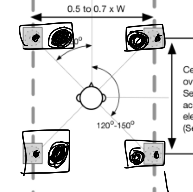

So I looked in detail at everything provided and did my own research as well. I still don't know how the speakers should be mounted. I am using standard rectangular speakers not in-ceiling speakers. They have a tweeter at the top and woofer at the bottom. Does anyone know which direction the tweeter and woofer should be facing? If it is mounted firing straight down on the ceiling, should the tweeter (top of the speaker) face the listener (back of the room) or other way around? I'm assuming the top of the speaker would face the listener. If using 4 then the back ceiling speakers ,the top of the speaker again would face the listener. I included a diagram to help. If this is common knowledge I apologize, but I want to mount these speakers correctly. Thanks again.
I think I might mount them the opposite way. The reason(in my little brain) is since the tweeters baffle is at a pretty good angle. To me, having the tweeters closer to the center of the room(opposite of your diagram) would put them too far off axis, and they would not jive either the bed channels as well as they should. I would mount them so as to point the tweeter more squarely to the LP. I also think looking at 5.1.4 is better than 7.1.2. Hope I’m making some sense.

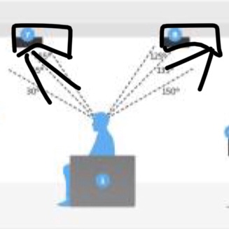

So please forgive my archaic iPhone art. I would mount the speakers so the back of them is flush against the ceiling, so the front of the speaker is pointing straight toward the floor. Since the front of the speaker has the tweeter and the woofer at different angles(vs one flat baffle) it’s important to aim the tweeter towards the LP. In this example the tweeters are to the outside edges, therefore pointing them at the LP.

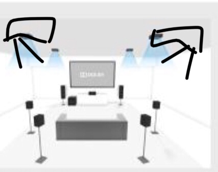

Alternately, having the speakers mounted so the tweeter is fore and aft, the tweeter would fire like this.
Does that help any? I can doodle up some more HD diagrams per request LOL!!!!!
I think I got it! In your first diagram the speakers are basically sideways from my diagram. In your second the speakers are opposite of my diagram. What would be the advantage to this set up as opposed to the other? Just curious.
