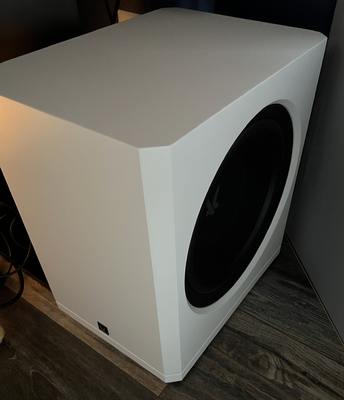

Went with a pair of the Arendal 1723 1S’s and they are INSANELY good! Thanks for everyone who steered me that direction.
