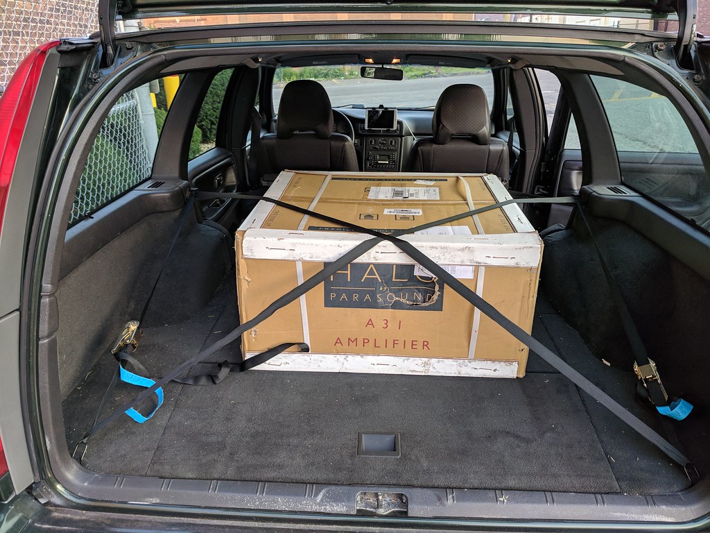

Well, the monolith amp was on my short list, but instead I had a momentary lapse of judgment and went crazy in the budget department....
I may need help...
