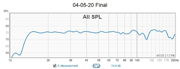

You have some measurements or something to back this up? Here's what I can achieve in room with my Hsus.
A single FV15 will not outperform a pair of MK5s, and I don't think there's a huge difference even 1 on 1. There's no magic sauce in Rythmik subs that make them markedly superior.
These are all variable tuned subs, and the Rythmik subs have deeper tuning frequencies than the Hsu subs, so it probably could produce a lot more output than the Hsu subs below the Hsu's tuning frequencies. However those tuning frequencies are so deep that it scarcely matters, and when you do tune a sub that deep, it gives up output. Also, the deeper you tune a sub, the sooner it will run into port turbulence. I would guess that the HV15HP has an advantage over the VTF-3 MK5 below 20 Hz, but not so much above that point. Even two VTF-3s would probably have a difficult time matching an FV15HP below 16Hz. On the other hand, two VTF-3s would smoke an FV15HP above that point.
I totally agree from 40-100hz a pair of Vtf3 would have 3-4db more max output than a single Fv15hp.
I personally owned Vtf3 mk5 when it first came out 6-7years ago. Loved it. I had at the time a pair of Fv15hp and I could easily hear a difference when I played at higher levels. Down lower though or even mid spl Vtf3 was good. Vtf3 just struggles when pushed, especially if you plug a port. You’ll definitely get chuffing but setup right Vtf3 is great sub.
Last Christmas I bought my son a pair of mono 12 to replace that Vtf3 mk5 that I gave to him. He really wanted duals and hsu was unavailable. We tried one mono 12 vs Vtf3 and mono 12 shakes room better and has deeper sound. The mid bass though on Vtf3 has more slam. Now 2 mono 12 made things so much better.
