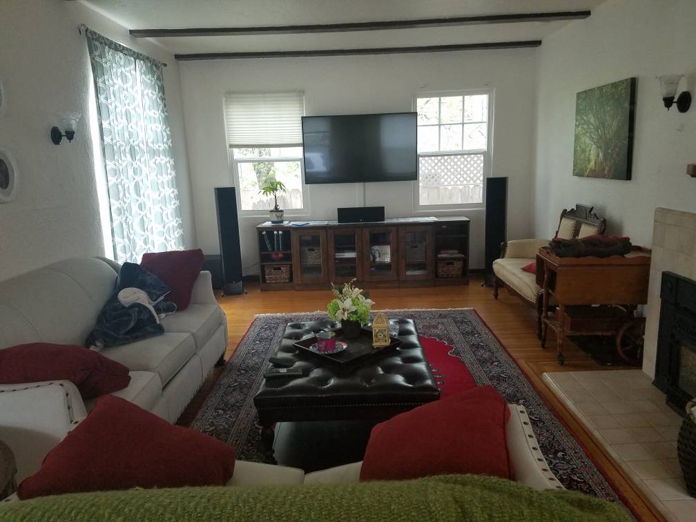

Ignoring the outdoor/garage stuff, I would want to know a bit more about where the speakers are placed in the family room and address that independently from the rest of the system.

Now, when you have the picture of the family room, for some reason there are two speaker holes that appear to be side by side. I'm just not sure if that's correct and mirrored on both sides or what is going on. It almost looks like it may be a stereo setup, with a 12" woofer and then some other speaker for the other hole. So, perhaps a 12" woofer, and a 8" 2-way would work in those locations. Weird, but it may work and be acceptable at a budget price. Crossovers would be... tough.

You aren't way off, but there's a few things to consider. The 40+ year old custom in-ceiling speakers are certainly an issue because they go against all current designs and will definitely be a project to address properly.

Don't know if you saw this angle. It does look like they're mirrored on both sides.
I suspect the second hole is for the light that's beside the speaker in the first pic.

Yes, those empty holes next to the speaker boxes are recessed eyeball cans I had out while I was spraying gloss white to get rid of the yellowing that looked so poor against the white ceiling. Look much better now paired with some 4000k 15W LED's. Even better at the end of the month when all the walls are freshly painted matte white!

B) From looking at the pictures you supplied (thanks BTW) the wood piece inside the fabric cover (with the 12" cut out and the additional small hole on the bottom) should be easily replaced (use MDF) and cut it out for the budget in-ceiling or in-wall speaker you select.
- The speakers come with a template, it is easy to do.

Cool makes sense. I already had reservations about throwing bass through built-in cabinetry but figured I'd ask. I'm going to purchase everything tomorrow. Four rectangular speakers, the 2-channel volume adjustable switch box and some CAT6A cables that will be handy when setting up my home network and automation devices.
This is my living room, mind you this is some ehat budget equipment, that I spent more then a couple of years shopping for to get the best deals on, and I am over 3 grand in...
Sent from my SM-G930T using Tapatalk
