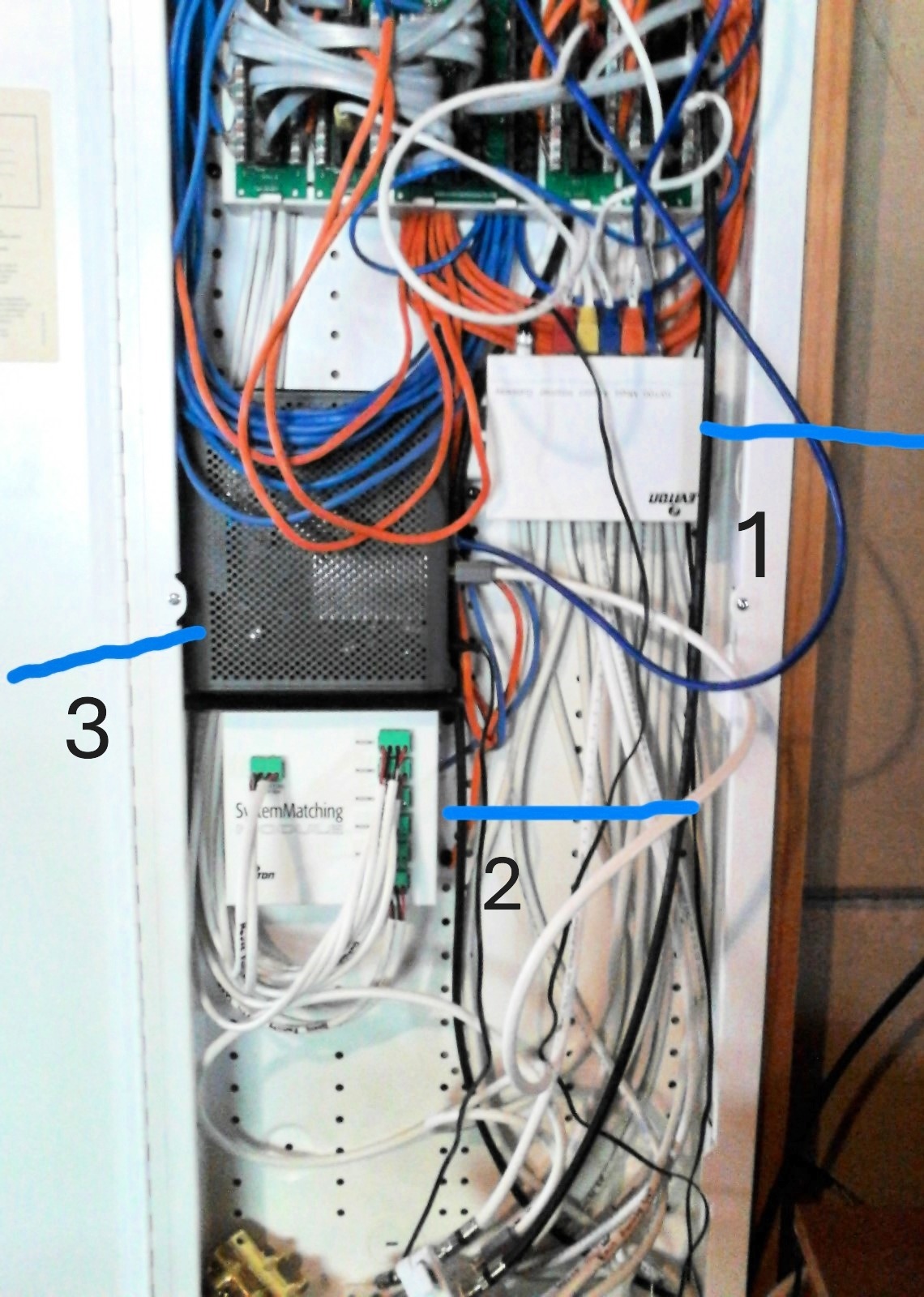

Attached are photos of SMC (Structured Media Cabinet) which is pretty simple.
SMC.jpg is whole unit. 1 = 4 port wired gateway 2= System Module 3=Cable/Internet router

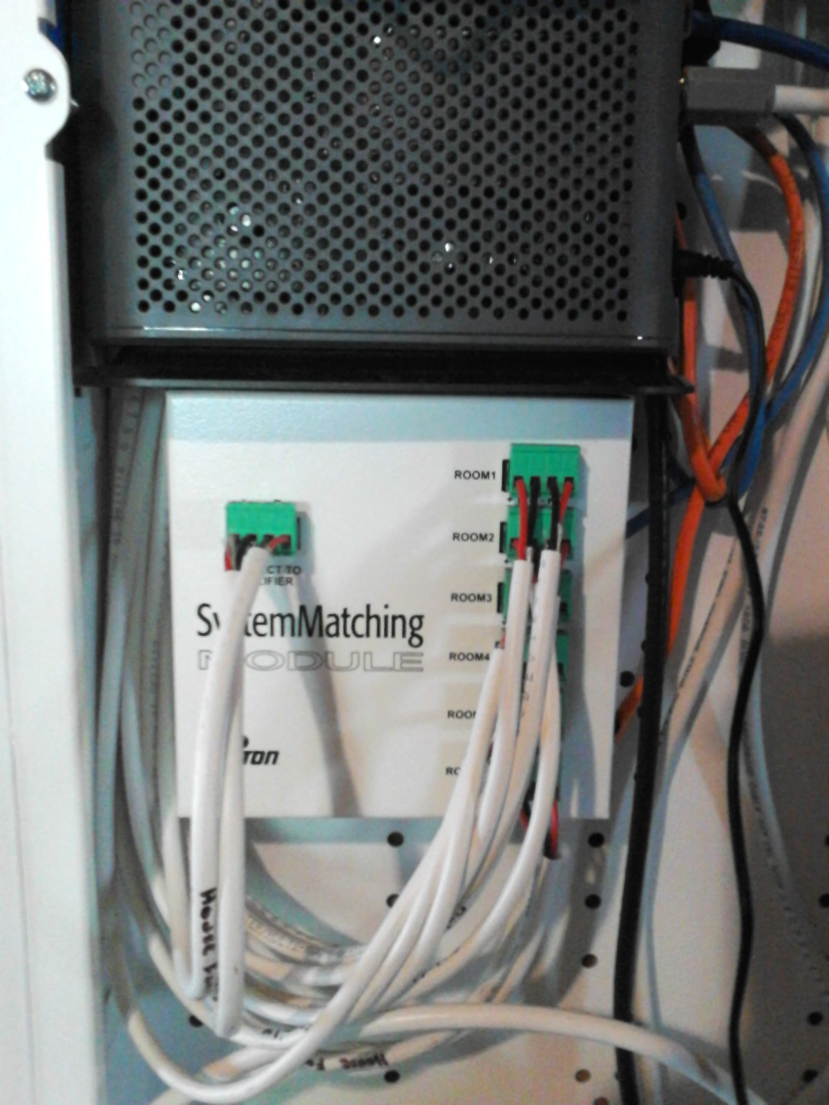

SMCSystemModule.jmpView attachment 72750 is close up of Ceiling/outdoor speaker hookup. Left connector goes to speaker screw wall terminals (received speaker wire from amp) The 6 right connectors go to individual ceiling or outdoor speakers (each has its own volume control in a wall plate).

From your picture I suspected that this was a complete system. If it does not work as is, it is broken. There are no parts and it needs scrapping. As I suspected it has and am, and there is an impedance matching module. There are individual controls in each room.
As I have said, this is a complete system and totally proprietary. So it should work.

I had a feeling there was a power amp in the picture. So now you can see there is a good picture of that impedance matching module, and all those wires going to the green connectors in fact speaker leads, as I suspected. This is a complex system, and not something that will be driven from an AVR or domestic Hi-Fi equipment.
This is Leviton's current equivalent system.
The OP should contact Leviton or their agents for further advice.
