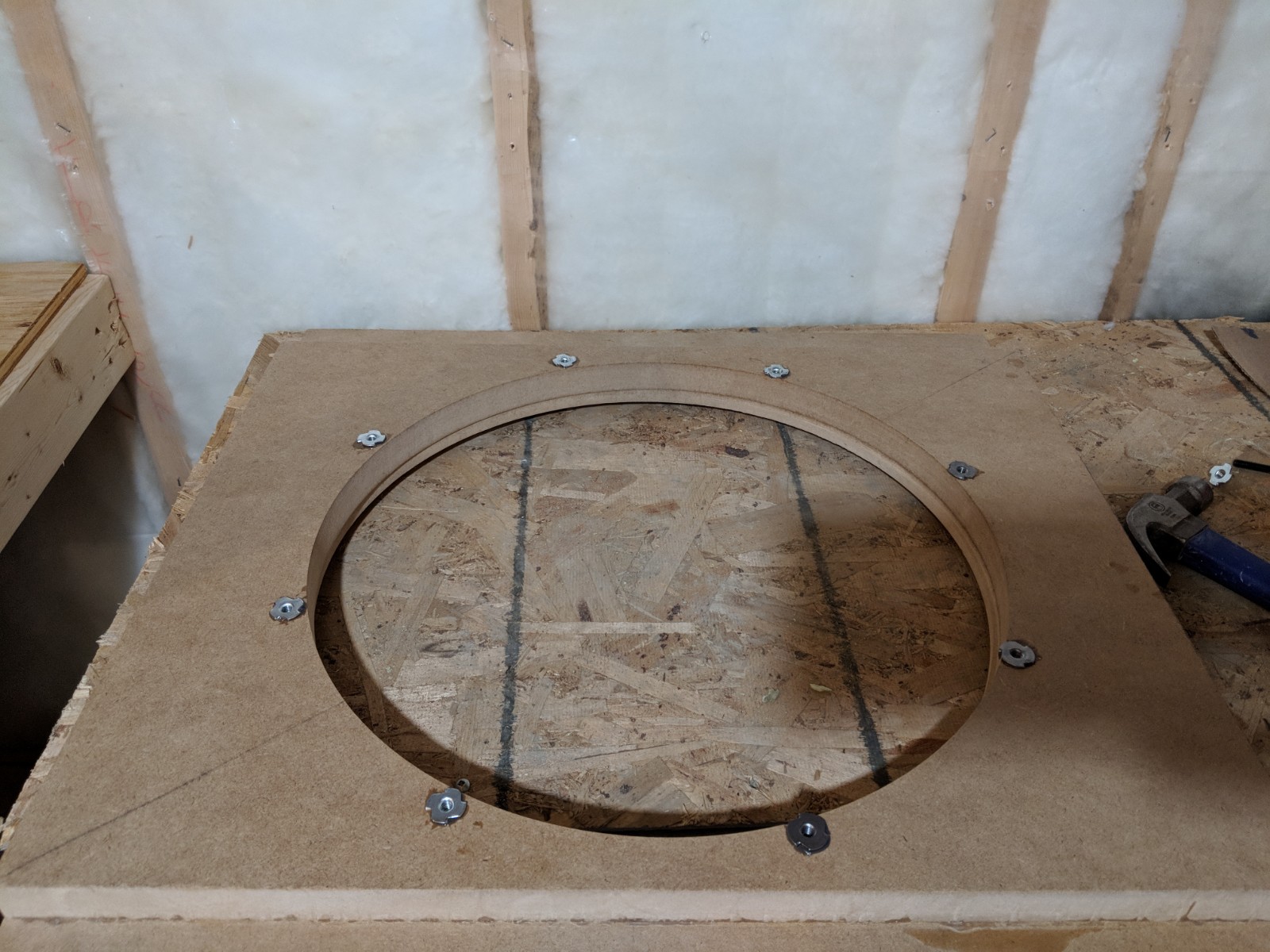

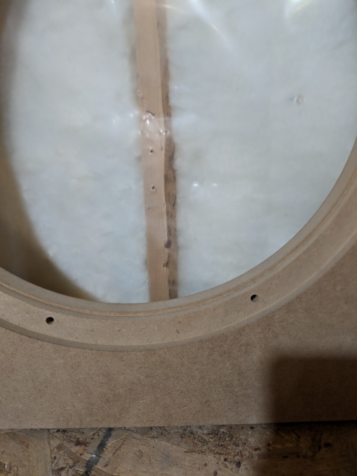

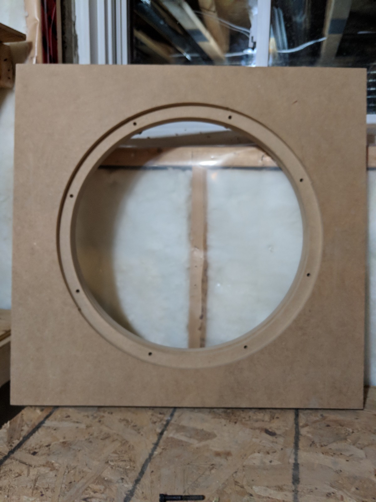

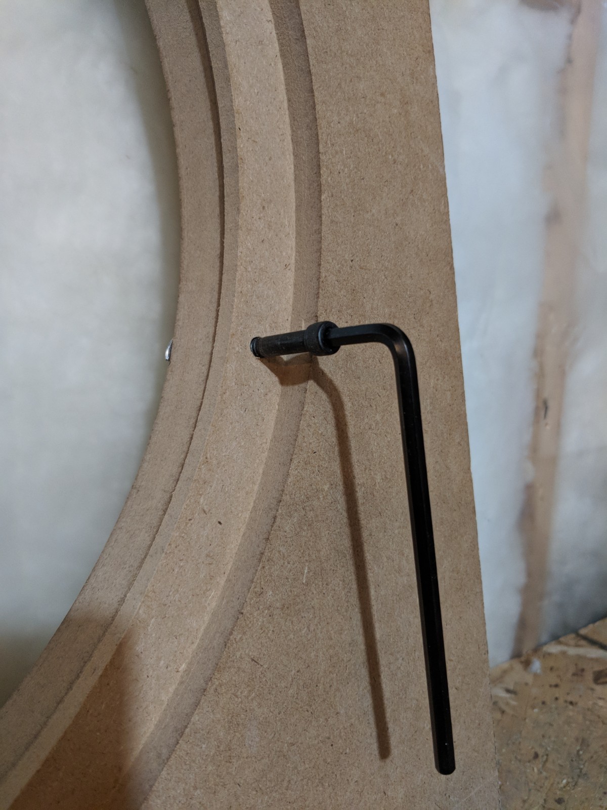

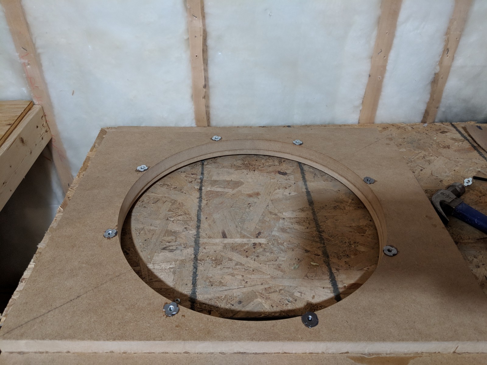

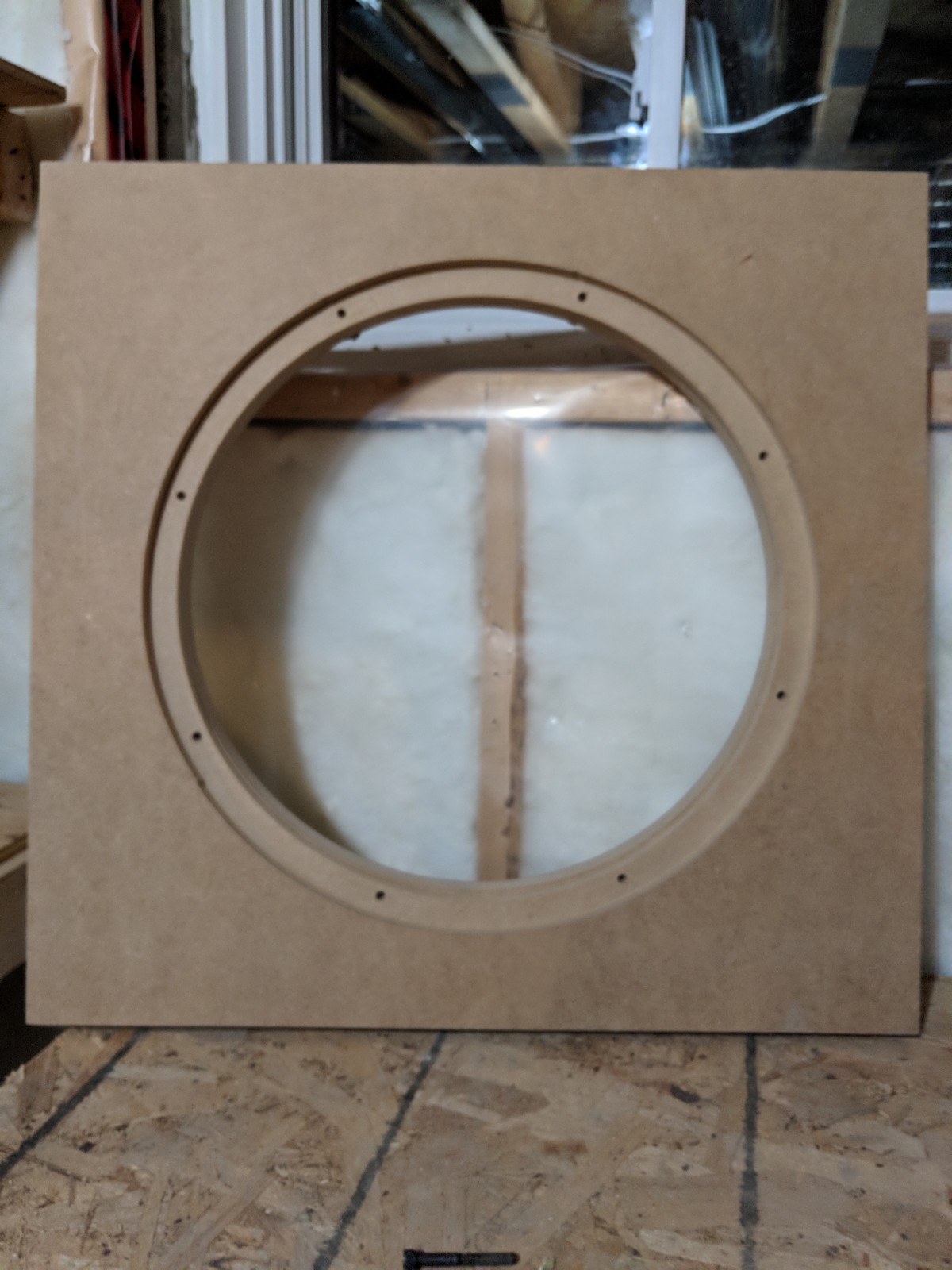

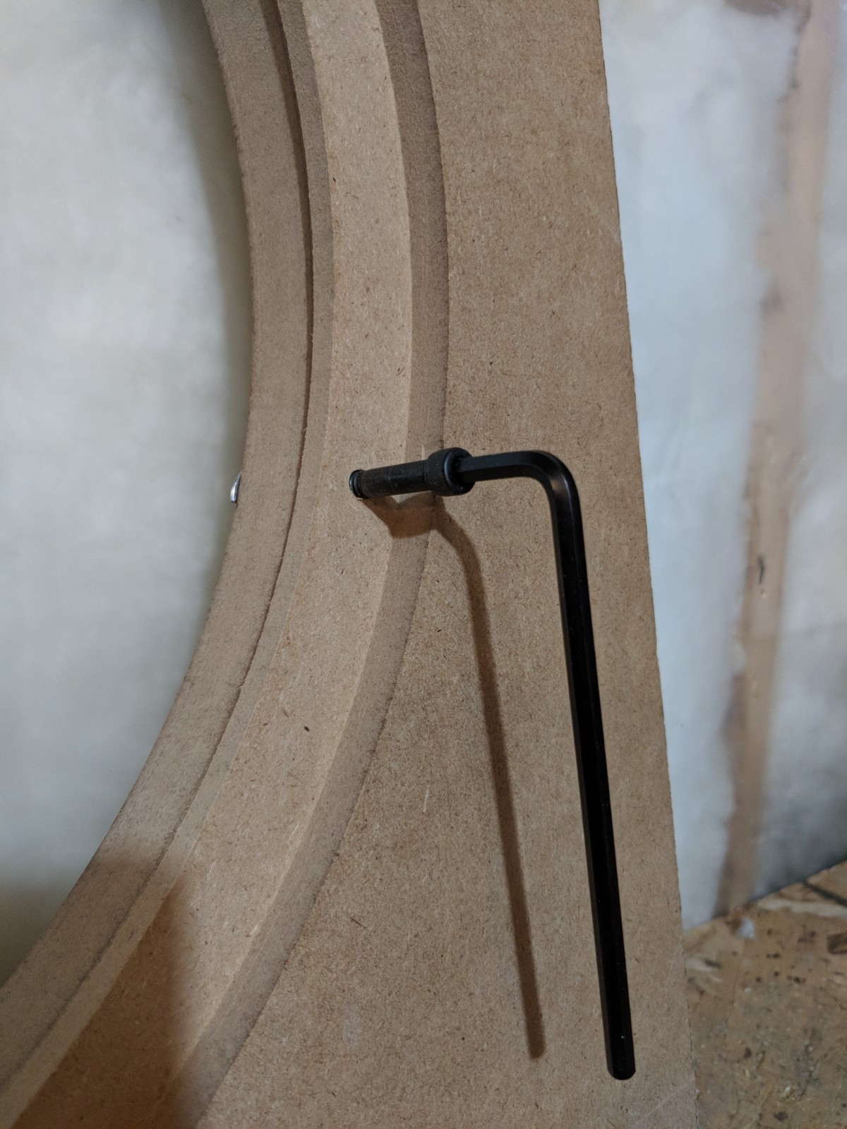

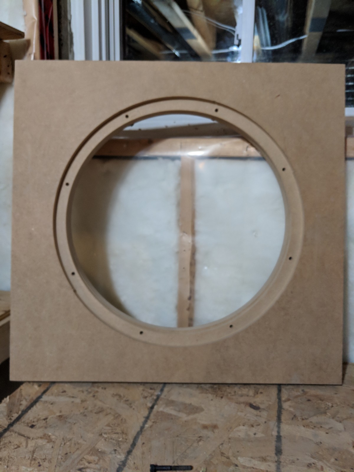

Here are some pictures of the baffle and the T nuts. (You can see my other thread on installing T nuts because I had some basic questions but I think I have it figured out) The baffle was tricky to cut with the router because I couldn't get through the 3 inches of MDF from one side so I had to flip it over and cut through. It is a touch off as you can see from the pics but I think it'll do. You can see some a one prong over hang because of the mistake from the cut but I used 3 prong nuts for those 2 holes and extra epoxy. It's tight. I still have to cut the perimeter of the baffle to size. Just a couple inches off of each side and it'll fit nice. I'll do that tomorrow and then glue. Enjoy!

Well that is the way I have always done it. Do not use butt joints building speakers.
View attachment 27331View attachment 27332View attachment 27333View attachment 27335View attachment 27336
This build looks as if it is going very well.
Correct! The butt joint will not be as strong. The rabbet is the way to go with dadoing the braces.
I just drill the pivot hole for the circle jig thru multiple layers with the stack just clamped together. Then the same center works for all the circle cuts on the pieces individually.
Here, I had the stack just tacked with brad nails in place. The baffles were first flush trimmed and sanded to the sides so the centers would be exact, finished centers. Here I am prying them apart after the outside has been routed.
Nip the brad nails about 1/4" and leave them, and they become pilot pins when you go to put it back together and keeps it from sliding around when you glue it.
