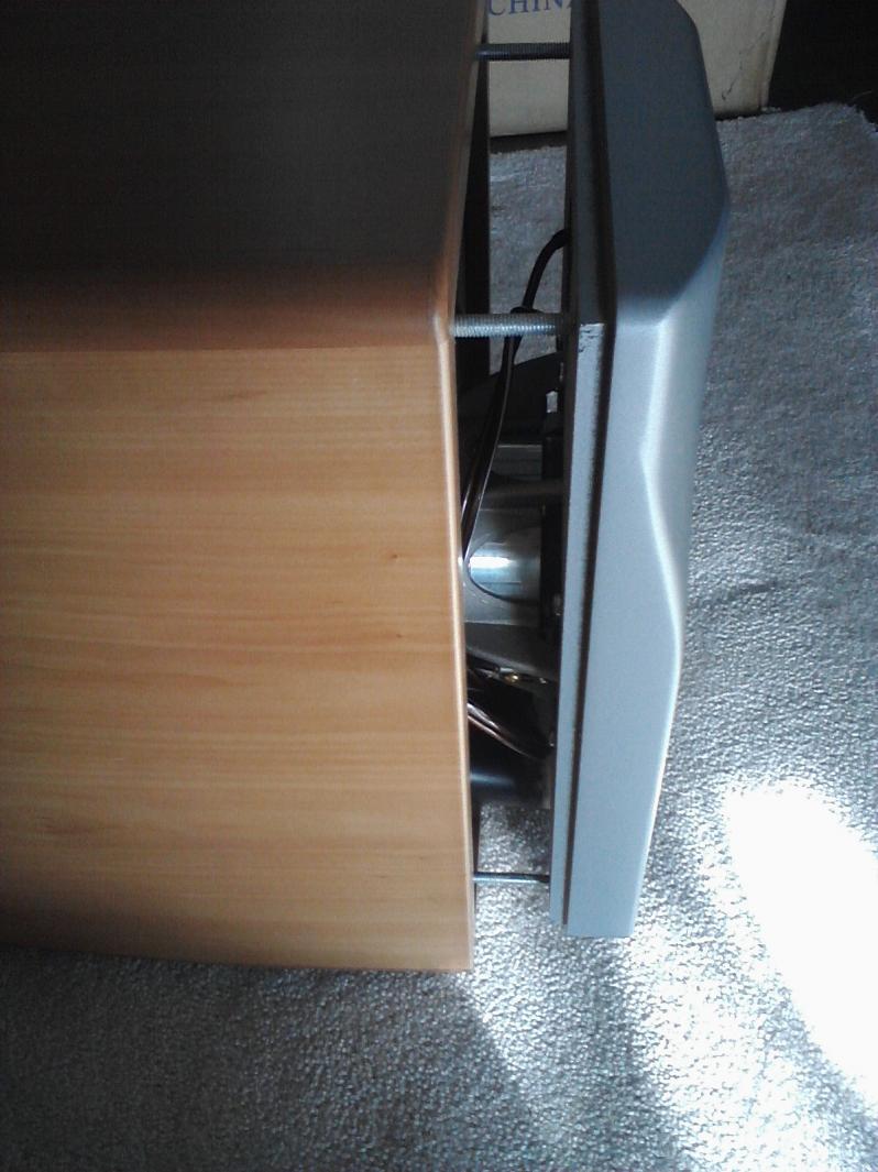

Here are some speakers. Yes, I was very carefull. These speakers were very easy to pull apart. Those who own them might want to check the tightness of the four nuts on the back panel. Mine seemed to be a tad on the loose side.
I did that early on

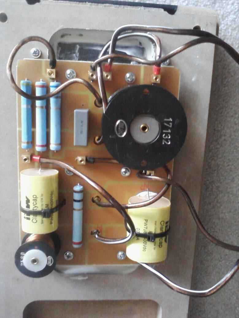

If you get a chance, take and show the picture of the crossover network -
there are some big crossover parts
The spider for the woofer, I think is in the middle of the 3 inch voice coil!
There is no way that the Vera has the look of a $500 speaker - I have
opened a whole lot of speakers, and the build quality, drivers and the
network of the Vera, is a step above many out there.

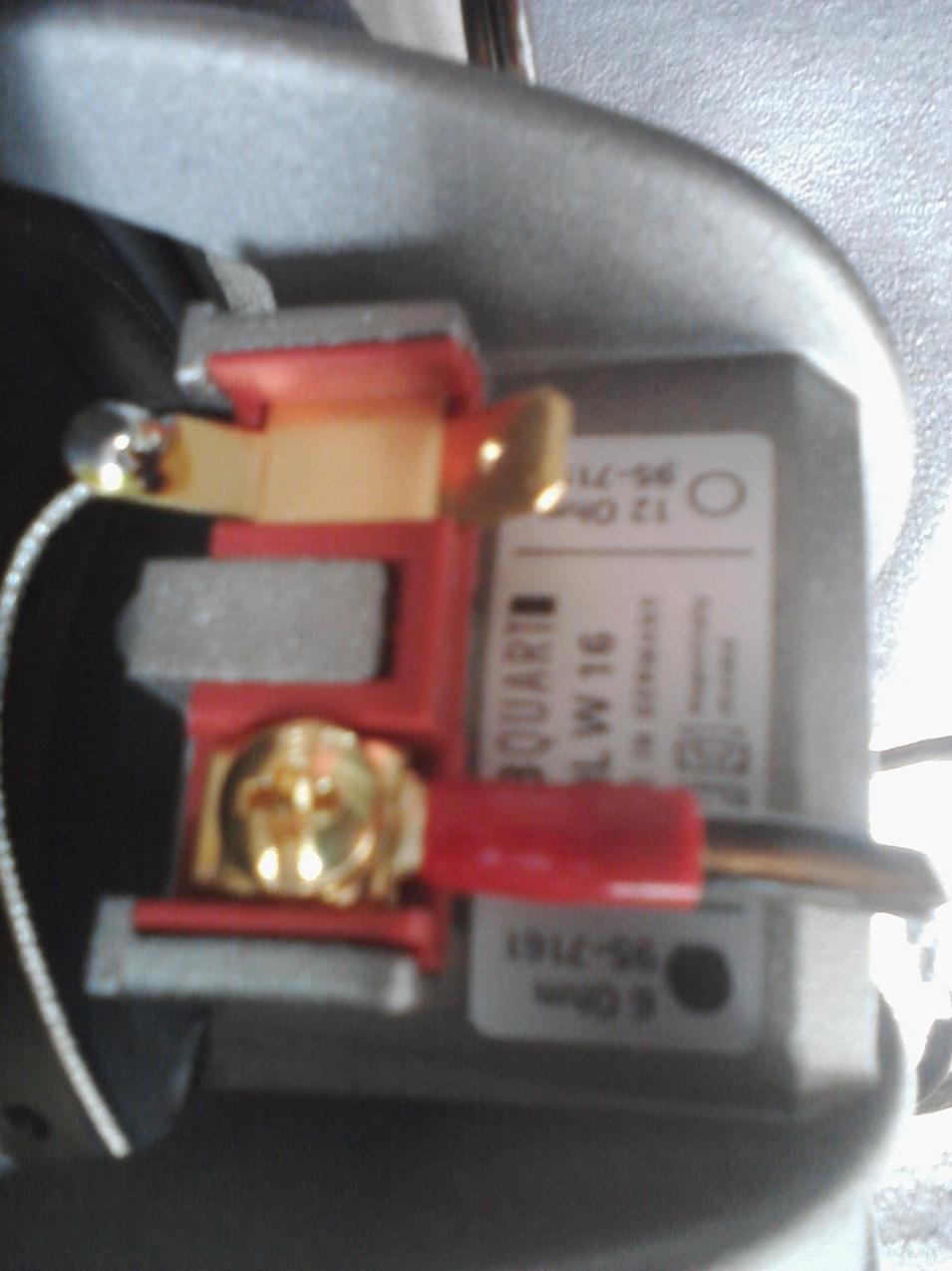

It's interesting how they go together. Four long rods sandwich the cabinet between the front and back panels. Nice that they used long strands of speaker wire between the crossover and the drivers. It also looks like the woofer can be connected as 6 ohm or 12 ohm. Every part seems to be of very high quality. I had a few other pictures but they somehow vanished while up-loading. My fault I'm sure.

I'm not sure how/why the picture of the crossover wound up on this reply but there it is!

Nice picture of the crossover - good job, now I do not need to buy a cell phone
to take some pictures.:)

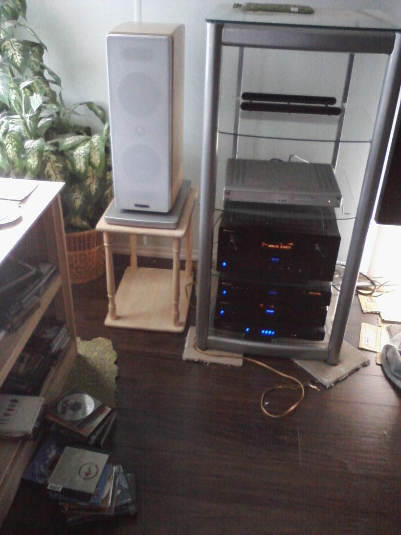

I removed the base from the two that will be used as fronts. I also peeled of the logo's from the grills and re-mounted them on the bottom's of the grills. Very easy and quite successfull. Looks like they were supposed to be fronts now except for the mounting holes on one side of each speaker. I positioned the speakers so those mounting holes are on the outsides and I really can't see them unless i look specifically for them. The only other issue is the very small logo's on the speaker themselves. With the grills on you can't see that one is on the top but up-side down. With the grills off this would bother me. The solution would be to dis-assemble the speaker and flip the front face-plate putting the logo on the bottom. I have a feeling the center speaker would be a little harder to re-assemble (it has 6 rods instead of 4) so I doubt I'll be doing that unless absolutely necessary.
The other thing is the speakers height. On 24" stands the speaker is a bit brighter, the tonal quality of the midrange a bit higher and a little bit less bass response. I trying out different heights by removing parts of my speaker (plant :p ) stands and using (or not) the speakers base plate. It really does make a difference. View attachment 13418004.jpg

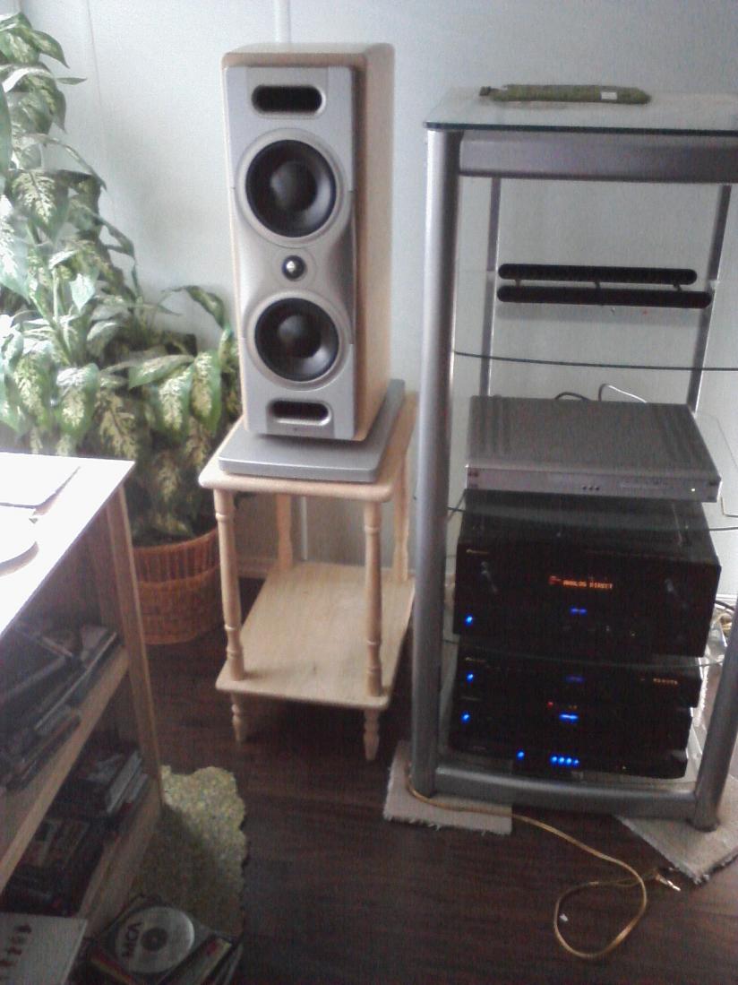

Here's a couple more. First one is the stand fully assembled with the Vera's base. In other words, as high as it can go. The other is with the grill on with the logo in the original place.007.jpgView attachment 13421
