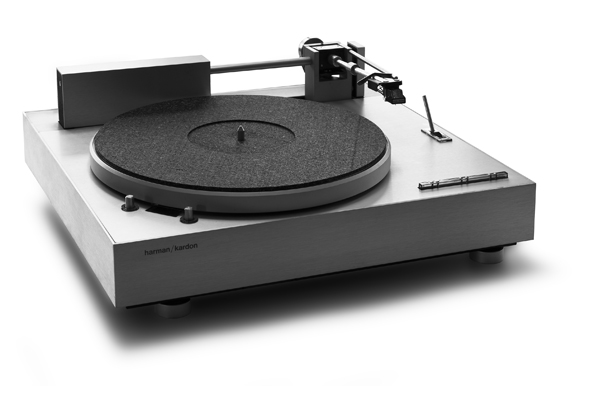

It is surprising that linear tracking tone arms never became the standard.

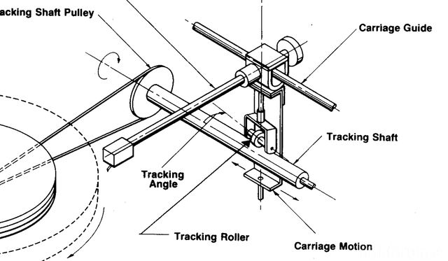

A friend has one of these Harman/Kardon - Rabco turntables which worked great aside from the tracking roller wheel turning to gel about every 8 years. He no longer uses it because he no longer could find a replacement wheel. But that is a problem that should be easy enough to deal with by choosing the right material.
It is elegantly simple. Any time the arm is not perpendicular to the carriage, the roller will carry it sideways to square it back up:
There were plenty of other versions by other manufacturers that also seemed to work well, this is just the one I am familiar with.
