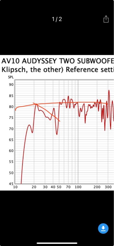

OK, take a look at the unadulterated AV10 implementation of Audyssey (I did this with the AV10, not the iPhone app) USING ONLY TWO SUBWOOFER OUTPUTS. The problem is fixed! YAHOO!
I will still adjust the bass up a bit, but not 12 dB.
Now who's going to explain this?

Did you read my most recent post? The 12 dB deficit in bass disappears when when running 2 rather than 4 subwoofers.
I am using the App but, as you suggest, probably not effectively. But I'm not finished yet! Now that we've solved this problem, I can get started on the details.
Again, I don't need 'a lot more plots', the 2 versus 4 subwoofer problem is solved.
Thanks for your help and encouragement Peng!

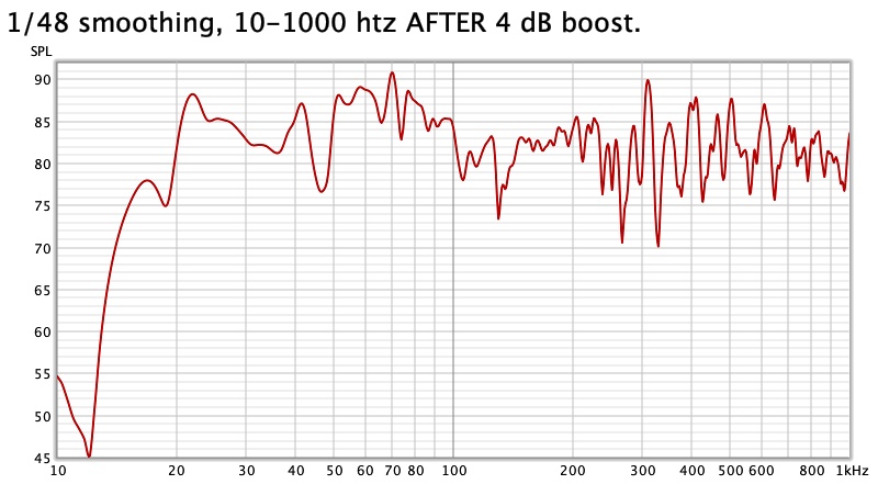

So I believe the 2vs4 was the right thing to do. Oddly though, the depression is still there, albeit to much less a degree. What’s interesting is the trough from 20-40 has the same basic shape as before.
Would you humor an old guy and post the new graph from 10-1000?

Hey, old guy to old guy, no problem.
Everyone, please ignore everything below 500 htz. For one thing the chair platform for my computer blocks the tweeter midrange output from the right Revel front, for another, I will soon set a 500 htz limit for Audyssey correction. That jagged graph above 500 htz cannot be a problem of my Revel Performa F226Be or the AV10, surely!

That looks more like it. Just to be sure, is that with one svs, or two svs but connected to just one subout? Two svs sub should be better, imo.
Paul McNeil
That's two SVS (sub 1 output AV10) and three Klipsch (sub 2 output). All individual subwoofers adjusted independently with Radio Shack sound meter, for equal output on each side.
Now I've got play around with things, using REW for feedback. Maybe the Klipsch should be set higher, to fill in that 40-50 htz depression you pointed out. Maybe humans cannot hear the difference, they are very inaccurate at low frequency resolution, really bad. And I can't hear anything above 10k htz.

Perfect! By the way, my comments about needing a lot more REW sweeps is only if you, or us haha, want to find out what might have caused the unexpected trough the way you use the 4 subouts before.
