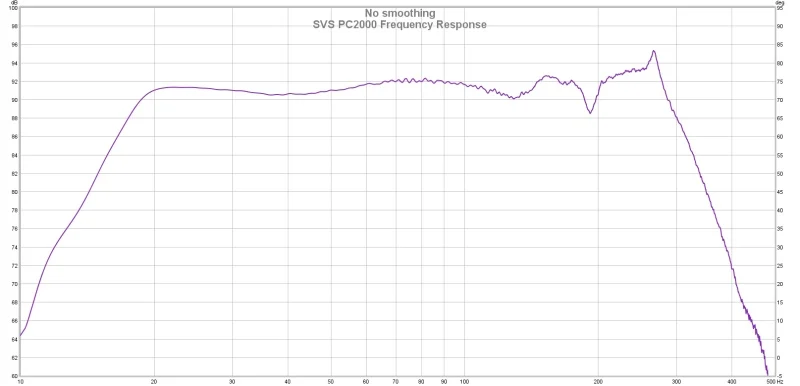

James did not measure those but even the PC2000 that are a couple notches below has the following:
That's without room gain!

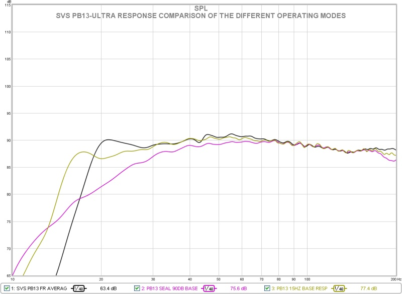

The PB13U was measured, it should behave about the same as the PC13U in terms of measurements:
Regardless of the mode, those big SVS just don't drop so rapidly from 22 Hz down, even in quasi-anechoic, let alone in room, and with Audyssey XT32 SubEQ HT incharge.

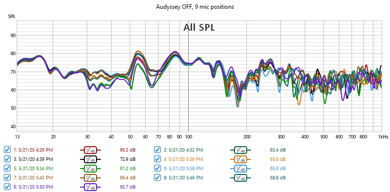

Here's my own, 9 positions, Audyssey OFF, for the front left+right+sub1 and sub2 (SVS subs), no such big loss below 20 Hz, we both know it is room dependent, but the OP has a large room so it should only be smoother, probably with less peaky room gain than my smaller room, but should have no major dips either.

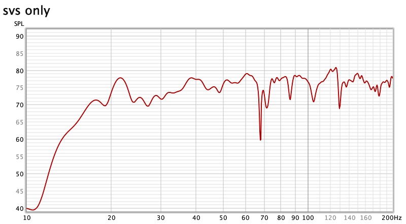

The SVS are in the 17 htz mode, no smoothing (the lowest tuning mode, with the updated amps). Here are the SVS alone. It looks like the Klipsch are interfering, to me, below 20 htz. But I'm not sure I need 17 htz...

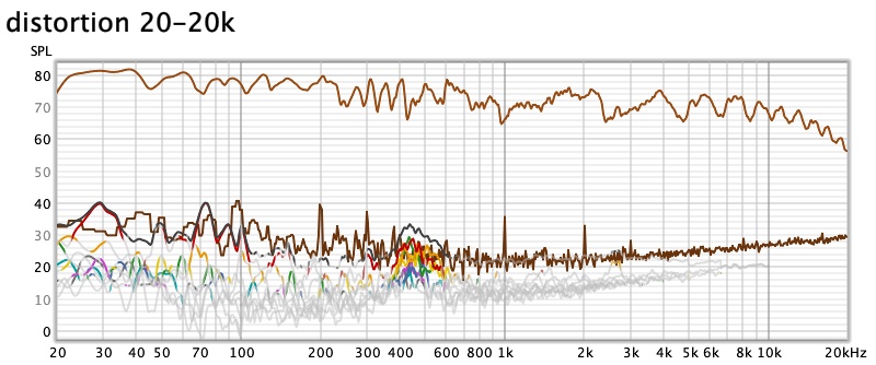

Also, there’s. Lot of distortion in his graph no?
I am not familiar with interpreting distortion, the only comparison I have is Peng's above. There's a larger gap between the SPL in my graph and the distortion lines (~ 40 dB) than in Peng's. I'm just guessing that's good..
In my setup, I found that 20 Hz mode gave me the best extension, down to about 10 Hz, but in a larger room I guess 16-17 Hz may be better, though I think setting it to 20 Hz is still likely to be better as it will give you more output in the 20-100 Hz range for sure, according to SVS anyway.
I would say distortions in his graphs look great for the bass range up to the 200 Hz mark as shown. I do expect it to be a lot better at above 300 Hz or so.

Here's the full spectrum with distortion....View attachment 66213
Speakers have much higher harmonic distortions than amplifiers, below is one for the Klipsch RP-600M with 10 Volt input. 10 V will be just about the maximum your AV10 can do without clipping too badly.
The RP-600M is a low cost speaker (relatively) so higher distortions is probably expected.
KEF (except their entry level ones) and Revel speakers typically have lower distortions than some of their competition's.
