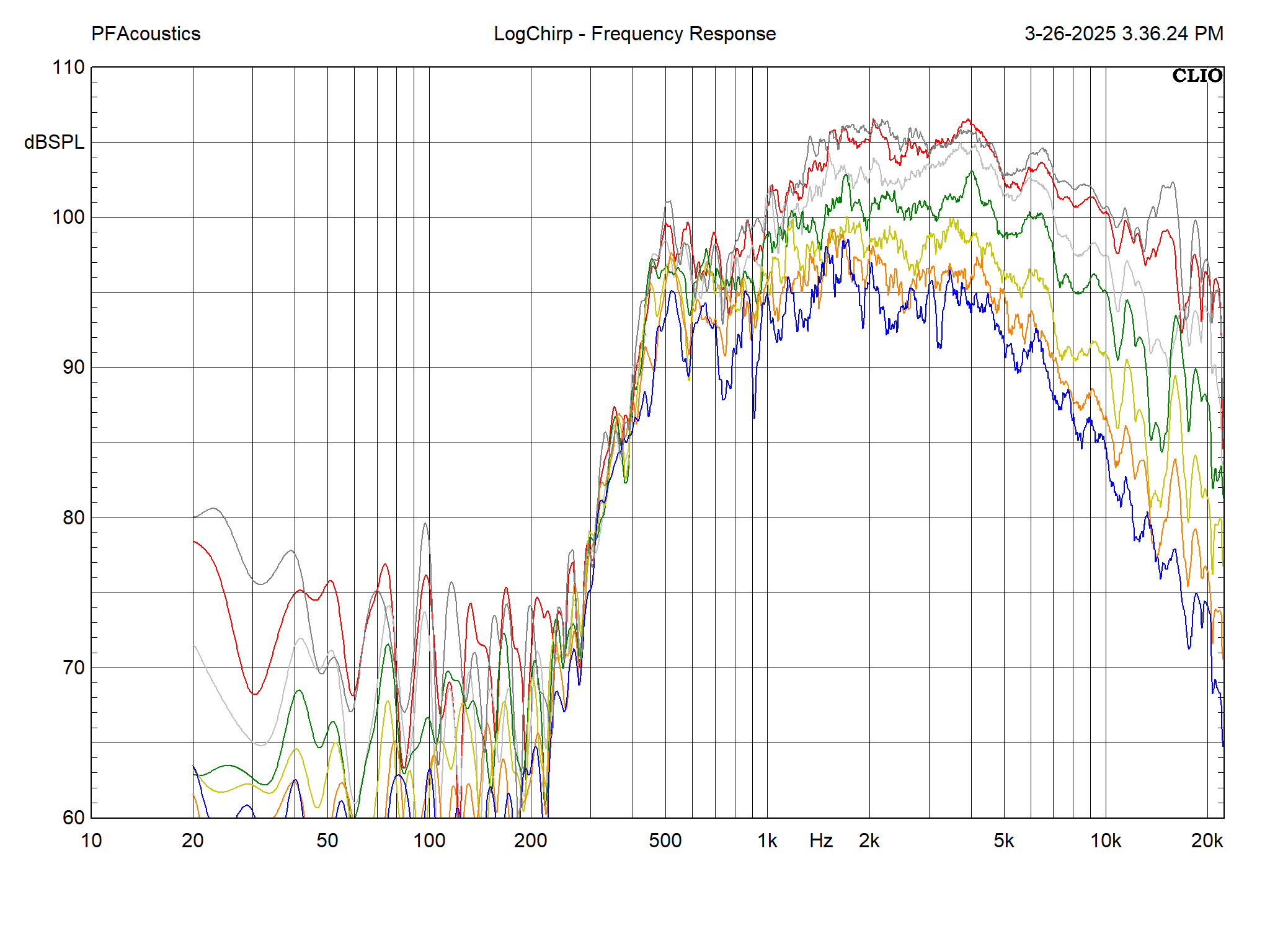

So, I have been tinkering with the levels and crossovers for the last several days. I have been taking multiple measurements with Omni mic at the MLP which is a long way from the front speakers. No Audyssey is engaged.
The measurements were made from the Omni mic disc. Now this has 5 bedlayer channels, but I used the Dolby Atmos upmixer, so that all 11 channels were driven including the two sub channels.
This is the room response at the MLP.
For an in room response with 1/24th octave smoothing. For an in room response at the MLP that is pretty good and the FR slope what you want for a realistic sound field at the MLP.
This is the response of the sub 1 and 2 outputs, and so this is the response of the long transmission lines of the main right and left speakers. The drivers are two 10" SEAS Excel drivers in each line, so four drivers total.
20 Hz is the lower limit of omnimic, but you can see the output from those lines is well maintained to 20 Hz. No wonder the things shake the floor and rattle the crockery downstairs when the grandkids are watching action movies. Actually large organs do it as well.
So, you don't need 18" or 24" drivers to get that response if you correctly harness natures physical laws.
I am very happy with the way it sounds now and will leave well alone.
