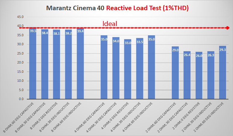

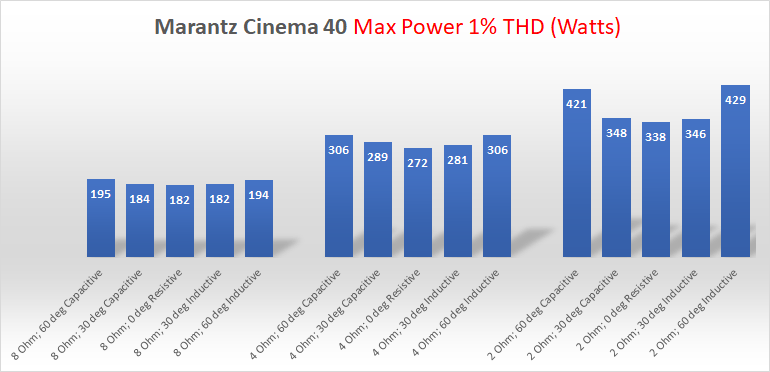

I don't disagree with what you stated, but I do feel the point of using resistor vs reactive load that most speakers are, seem not relevant if and when tests are done at well below the DUTs output limits, such as those found on ASR and Audioholics.com. For example, even an AVR such as the mid range Marantz Cinema 40 can do a very transparent job if test and measured at output up to their published rated 125 W, so if compared with any other integrated amps or separates at say the typical 5 W that ASR uses, and up to say 50 W, then who it won't matter if the load is a resistor or a simulated reactive load such as one used by the Stereophile.
Here we are looking at a mid range AVR, the matching power amps for the AV10 and AV20, the amp10 and amp20, obviously should and I suspect would measure even better when connected to reactive, even highly reactive loads.

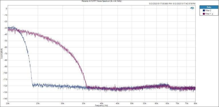

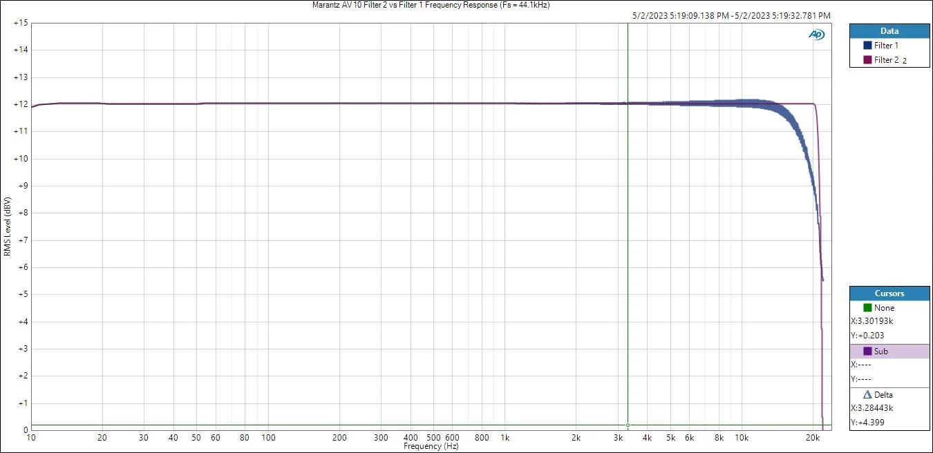

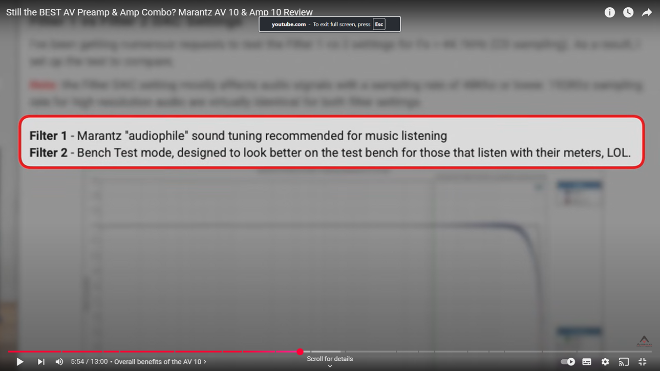

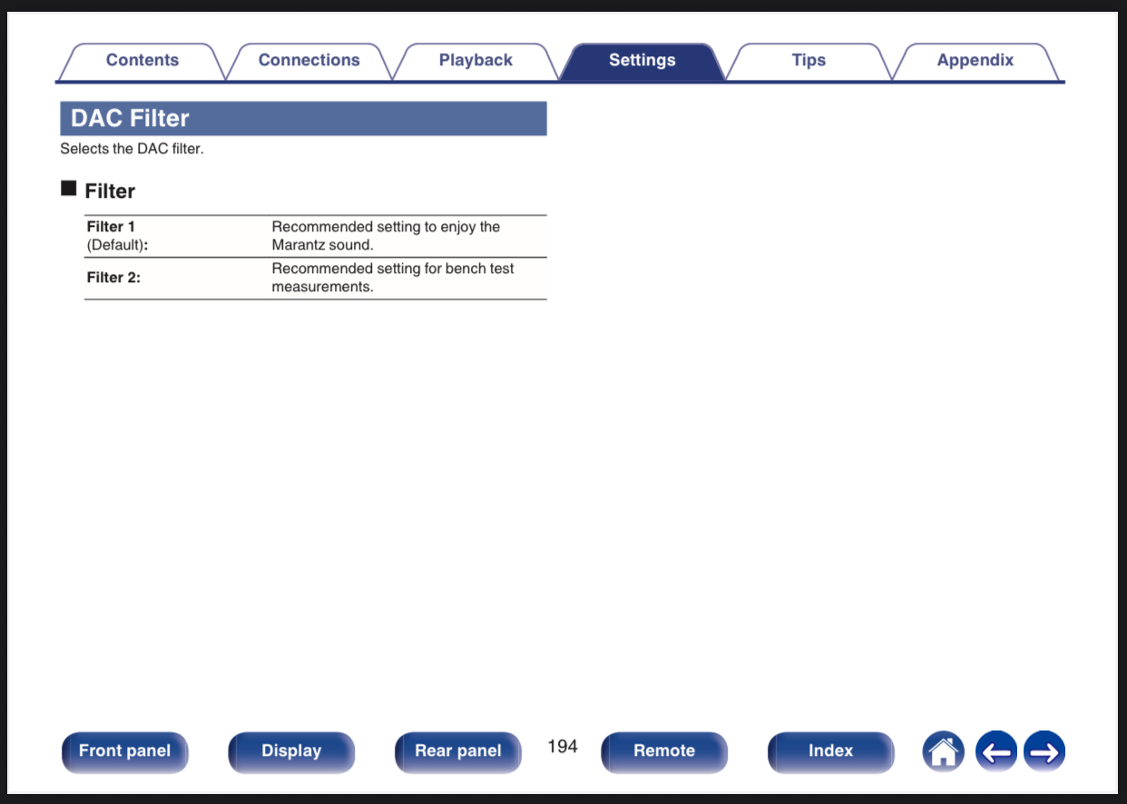

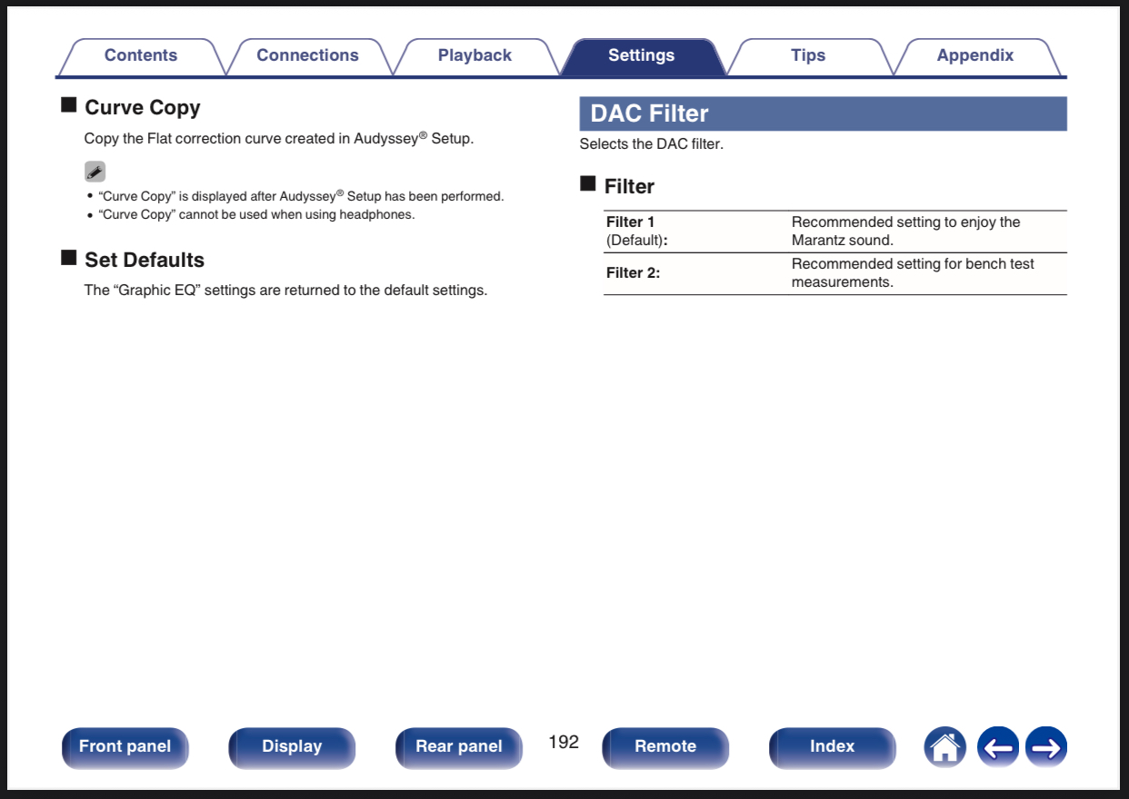

What is a DAC Filter?
Marantz models such as the AV10, CINEMA 30, MODEL M1, and MODEL M4 offer a “DAC Filter” option within Audio settings. These DAC Filters adjust the roll-off characteristics of the audio signal.
  • Filter 1 (Default): Recommended setting to enjoy the Marantz sound.
    • This filter has short delay slow roll-off characteristics.
  • Filter 2: Recommended setting for bench test measurements.
    • This filter has sharp roll-off characteristics.
This particular claim while just a claim because "audible" or not is debatable and it certainly depends on the individual's hearing ability, or discernibility in the high frequency range as well as being subjective in nature, it is however, at least 100% logical, even when bottleneck analysis is correctly applied.
Bottom line, @TLS Guy has already confirmed the AV10 has superior surround sound performance, and is very audible to him, I hope he will try "Filter 1" and "Filter 2" and report back on whether he could easily hear a difference and then which one he prefers.
If I remember right, Gene said he could, or he thought he could? hear a difference and he prefers Filter 2 (NOT 100% SURE IF I INTERPRET THAT CORRECTLY FROM HIS TALK), that means he would have been just as happier with the Denon (A1H, A10H) sound too.;)
Finally, @ryanosaur , can you please also try Filter 1 and Filter 2 and gives us some feedback, thank in advance.
NOTE: Gene told us his preference between Filter 1 and 2 but he used the term that he prefers the one with the "wider bandwidth" so while I am somewhat confident he meant filter 2, there is an outside chance he might mean filter 1 because filter 1 will result in a roll off of about 2 dB by 20 kHz and about 2.2 dB at around 22 kHz, filter 2 will drop more at 22 kHz as it would act more like a brick wall at that point (ref: Nyquist criteria)
So at up to 44.2 kHz sampling, one can consider either filter as having wider bandwidth, I lean on believing Gene meant he prefers filter 2 because a) at 88.1, 96 kHz or above sampling, filter 2 definitely and clearly has wider bandwidth, and Gene mentioned it looked better on the test bench, since most bench test measure 20-20 kHz, and on that one, Filter 2's FR looks like a straight line vs Filer 1's roll off from about 12 kHz, so Gene most like meant Filter 2 look better on measurements. Marantz basically has the same narrative on that too:
Regardless, if @gene happens to notice my post, please clarify that your preference is in fact filter 2, or 1 (edit again: just realize in his review on this website he did make clear the one he preferred was the Filter 2), and thank you again for such in depth review plus a even more in depth review in the Youtube follow up video.

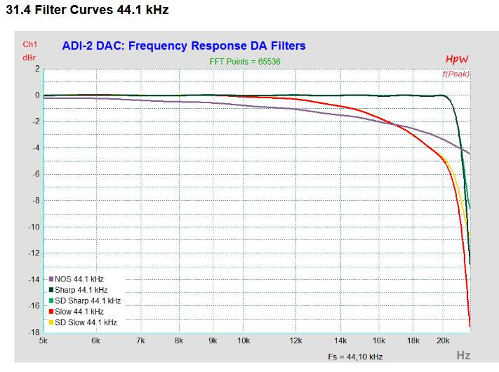

This particular claim [DAC filter roll-off characteristics] while just a claim because "audible" or not is debatable and it certainly depends on the individual's hearing ability, or discernibility in the high frequency range as well as being subjective in nature, it is however, at least 100% logical, even when bottleneck analysis is correctly applied.
Is the actual FR roll-off shown by D&M? With the expected age deprecation of hearing it's almost certainly inaudible to him.
Perhaps D&M could take a page or two from RME Audio. Below is the FR response for the filters for one of their converters, and they're likely not the same but probably close enough to not matter in this context.

AV10 DAC filters:
I prefer the filter 2 for all sources. Filter 1 is too soft to my old ears.
There is also a Cinema EQ control in the AV10 that softens the high frequencies. I prefer the sound with this control turned off.
Filter 2, and Cinema EQ turned off.
Various DAC filters don't just have rolloff differences. They also have delay and ringing differences. People have preferences.

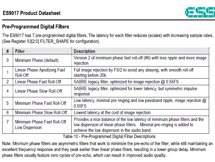

The different roll off characteristics are build in by the DAC manufacturers, TI, AKM, ESS and others offer such features in some of their models.
Marantz simply choose to implement their preferred roll off.
For example, the AV10 uses the reference DAC ES9018 that has the following roll off filter response option:
- Sharp Roll-Off
- Slow Roll-Off
The newer IC, the non reference ES9017 that Marantz Cinema 30 and Denon AVR-X6800H use offer more choices as in addition to the slow and fast roll-off, they also have the choices of linear phase and minimum phase:
The pros and cons of the linear phase vs minimum phase part is beyond my pay grade, at the moment anyway.
- Sharp Roll-Off
- Slow Roll-Off
The pros and cons of the linear phase vs minimum phase part is well beyond my pay grade.

I am not sure if they did publish it in the Maximo YT reviews but both Gene and Amir measured the responses for either.
Gene's measurements show the FR below, that are consistent with ESS's published on the datasheet of the ES9018:

AV10 DAC filters:
Sadly, we don't have any measured FR response on those two filters, or any other filter specification, as far as I know. That there is delay and ringing differences does not mean that it's readily audible, except in special cases by some.
Of course, there are preferences, if you can hear the difference.
PaulBe
See the post above you by @PENG for the measured response of the 2 DAC filters.

PENG
Thanks for that! Not exactly audible, depending on age and content.
Agreed, that some people might, but some might not. IIRC, Gene sort of said he could hear a difference but subtle, I think, definitely just my interpretation of what he said...
