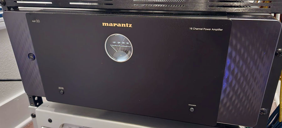

I used to think that as I routinely have rack mounted my various D&M AVP/AVRs over the years. With the AV10/AMP10, I'm using Navpoint rackmount shelves and they work perfectly and frankly is a hell of a lot easier than racking with rack ears on these beasts. So don't let the lack of a rack mount kit deter you if you're seriously considering this setup. It's a nothing burger at this point - buy the shelves - sit the AV10 and AMP10 on said shelves - listen, watch, and be happy. :)
