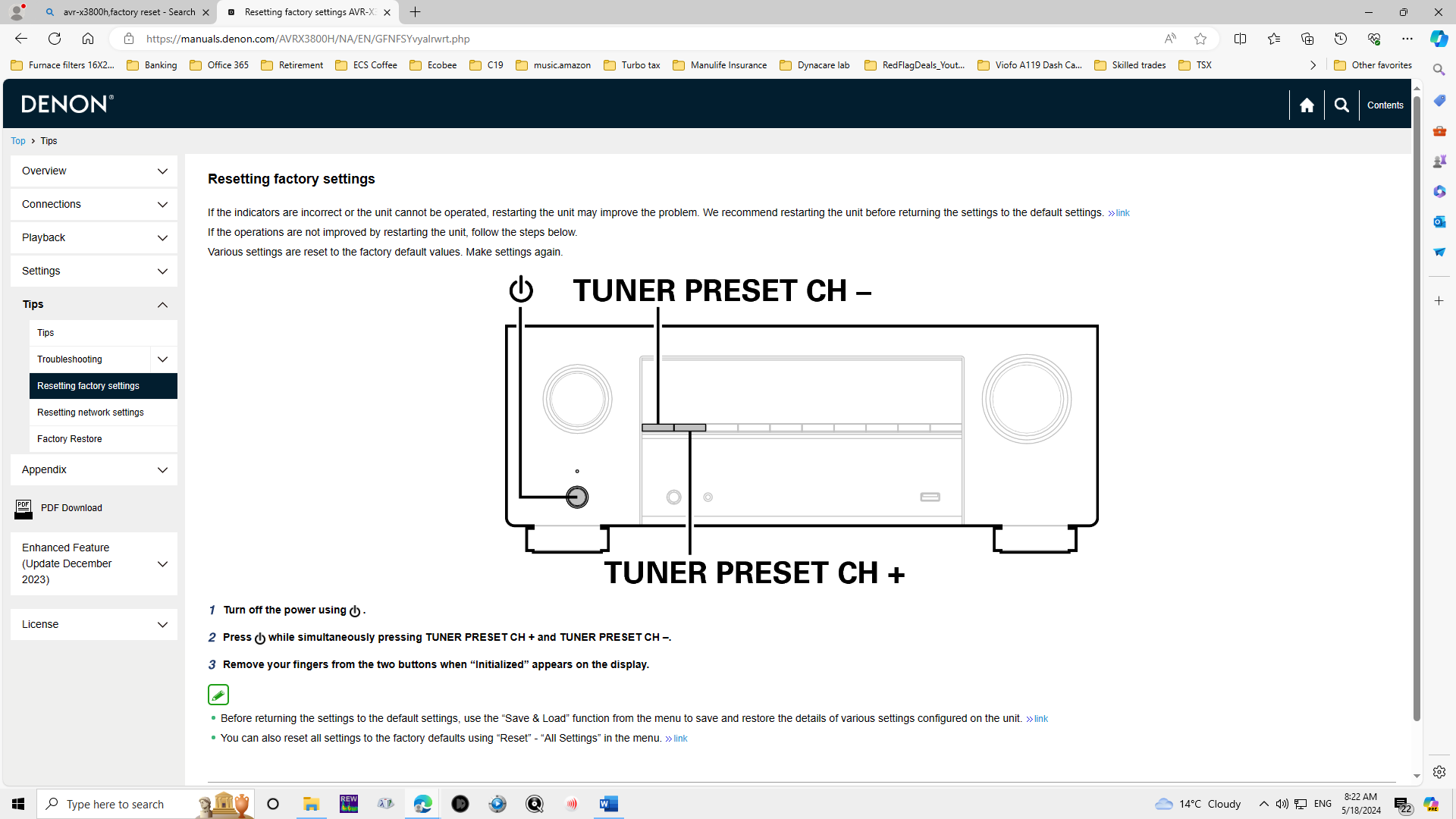

Just git the receiver. Connected everything like it was on the onkyo and when I started doing the 8 position withthe mic, no sound at rear back speakers after and the trigger switched off my amp.
What could be the fault
How do you factory reset the unit
PENG
It is in the owner's manual:

Thanks it worked after that.

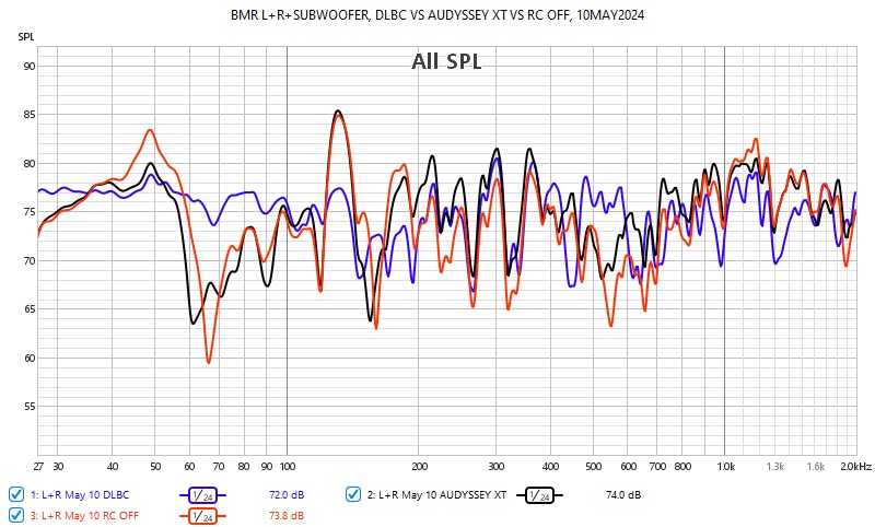

I know most people just trust their ears, but I also know if they checked with what a mic hear (they of course would hear differently, that's another story obviously), they would likely be surprised. Since you use a minidsp, you must have a mic and might have used REW. I have been playing around with my $550 Denon AVR bought when Denon went on sale a couple weeks ago and below is quick comparison of the results achieved by running Audyssey XT and Dirac Live with Bass Control just once, without any tweaks at all.
As expected, DLBC definitely did better, though I know if I spend hours on tweaking, Audyssey, yes, even just the XT version, could come close, in the bass range (10-200 Hz) anyway.

You don't have to get the bass control right away because D+M has upgraded the bass management such that even without the BC license, you can do the basic management that includes setting crossovers that you cannot do previously with the bass $349 ($244 if the 30% off deal is on) full range license.
Unlike Anthem's, Dirac Live Bass control does work very well, though again, now that you can set crossovers without it, you can probably expect great results even with just the $349 version. In fact, I am not sure if the $499 bass control license is worth it. Surely you would get prettier graphs, but I doubt it would be audibly better as such.
See that with bass control active, from 25 to 100 Hz it looks almost like a straight flat line. That's for my bookshelf DIY speakers with 1 cheap 8 inch failed Energy subwoofer now powered with a very cheap $80 class D amp. If you use 2 or more subs, expect better results.

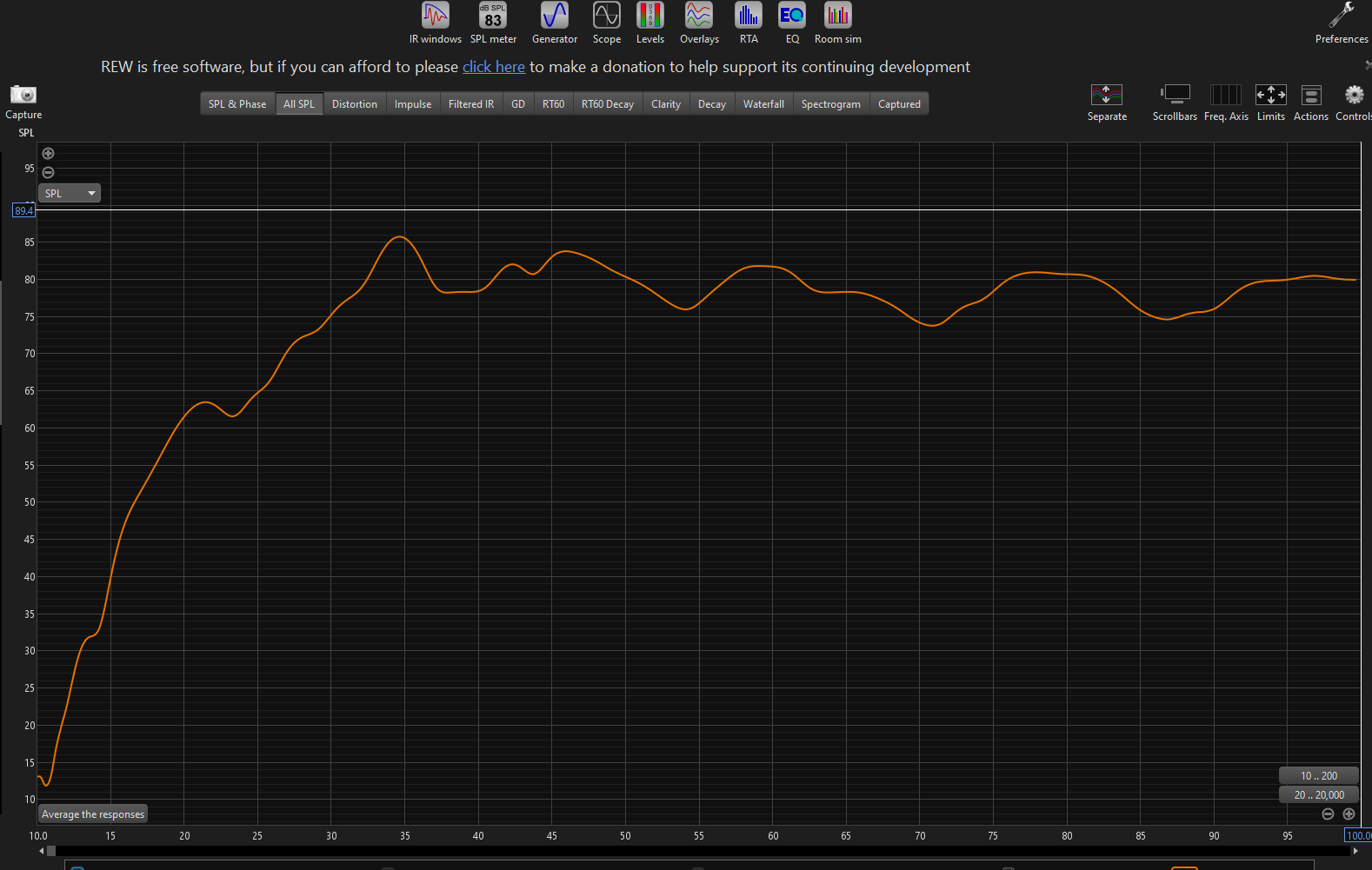

Orange was with 5subs on the old receiver with mini dsp
Green is 4 subs on the Denon
I need to find my notes I can't remember what spl levels and microphone levels I used when I calibrated previously.
PENG

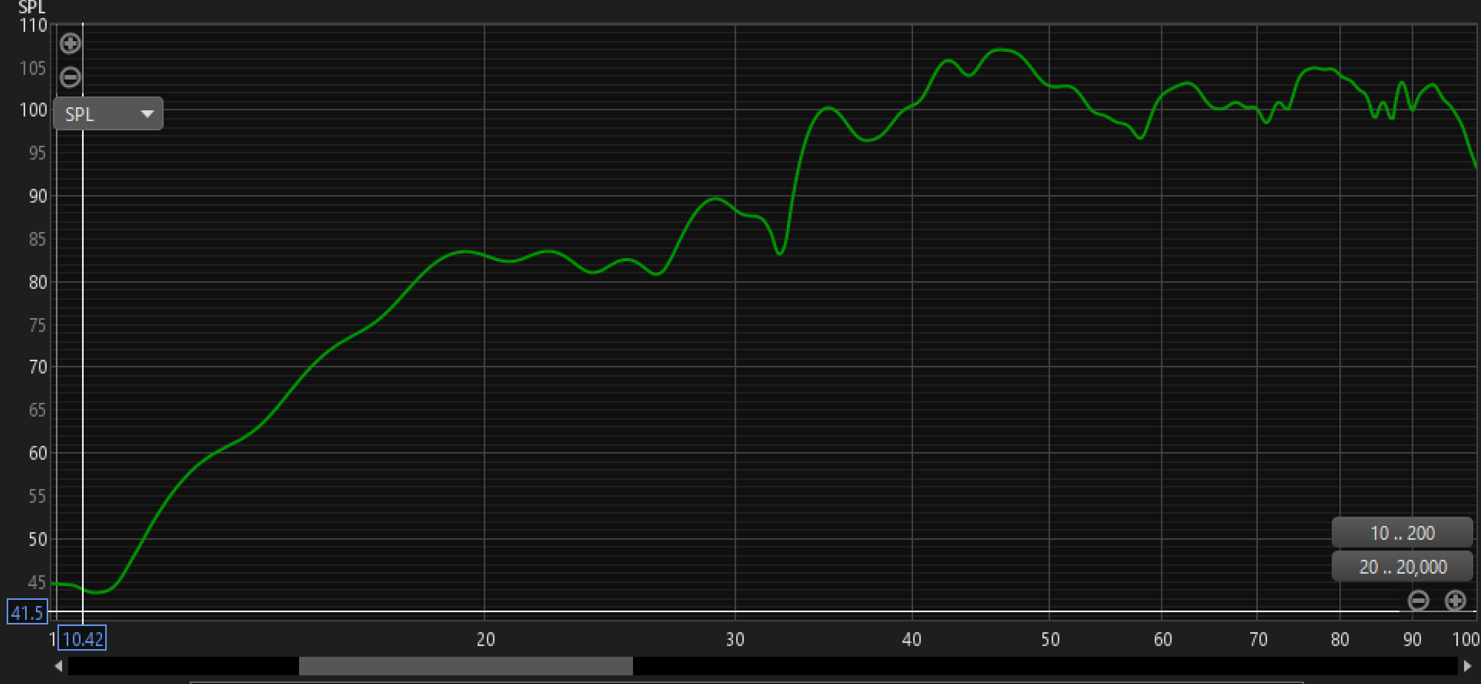

View attachment 67609View attachment 67610
Hard to compare as the graphs have different scales. Overall, I would say the minidsp (which model?) did not bring audible benefits to the table based on the two graphs you provided. With the App, especially if you are willing to spend a few hours using the 3rd UIs (freeware), you can improve the response a lot quite easily, without bothering hooking up the minidsp.
Without tweaks, you can expect +/- 5 dB 20-200 Hz reasonably easy, and with some tweaks, you could get +/- 3 dB to +/- 1.0 dB (1/12 smoothing), depending on how much time you have. There is no way any minidsp could approach such smoothness, unless you get the one with DLBC on it (I doubt they are compatible with the BC license though, but not 100% sure).
Below is one that shows how Audyssey, with the App did for me, it approaches a flat line from 20-150 Hz at the mmp, but obviously not as good in the 9 position average FR below, still within +/-1.5 dB 20-120 Hz, 1/12 smoothing:

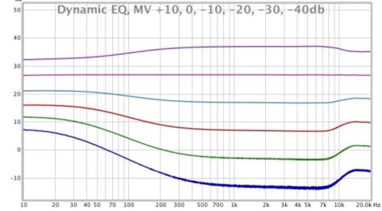

HD asked a good question since its effects are reduced as volume goes up. FWIW, I don’t like deq st all. It raises surround and rear top volumes too.
This is what dEQ looks like on paper.
Then there's what you can do with Reference Level Offset, too.
