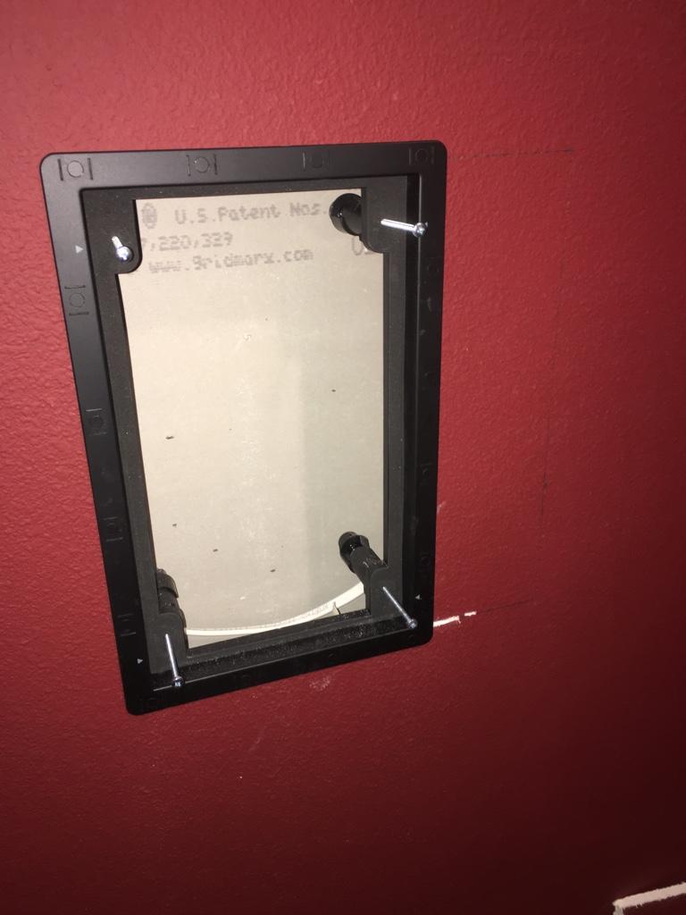

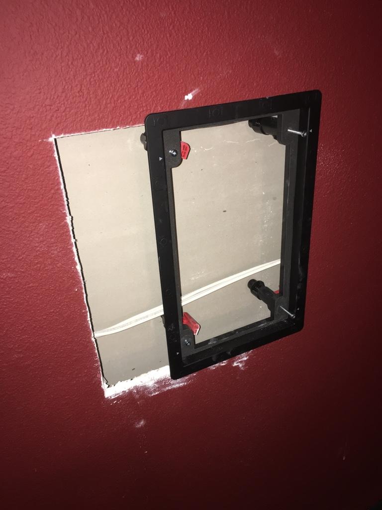

Damn 2x4’s not popping up on a stud finder, had to move both 4 inches forward...now I gotta do a bit of patch work
panteragstk
panteragstk
Had the same issue with my large front in-walls. Ended up working out fine.

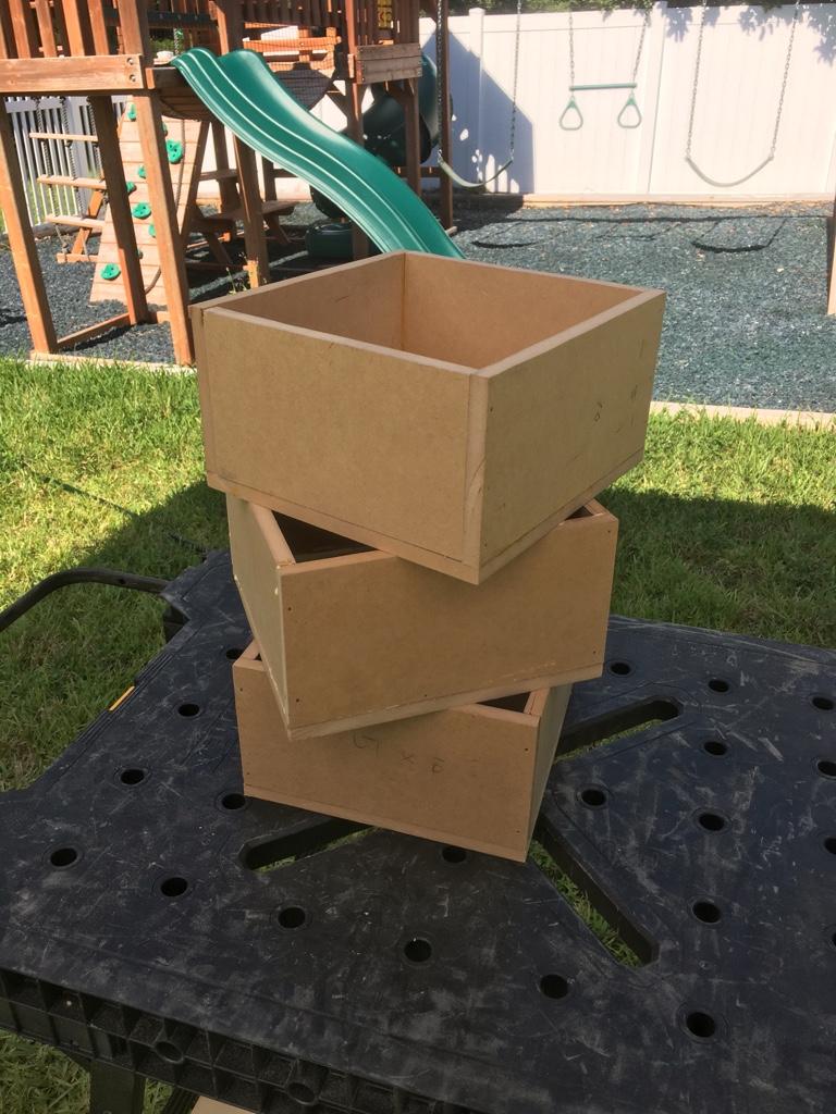

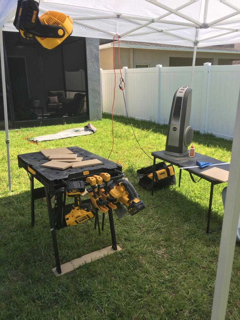

My wood working skills haven't been used in over two decades and my first of four boxes is quite rough haha. Don't want my atmos speakers making constant contact with fiberglass insulation and will lay these over them so not too worried about their appearance. Finding that circular saws are difficult to keep a nice straight edge but I guess that's what sanding is for while leaving it slightly larger than final dimensions. Think I'm going to buy a nail gun after work...

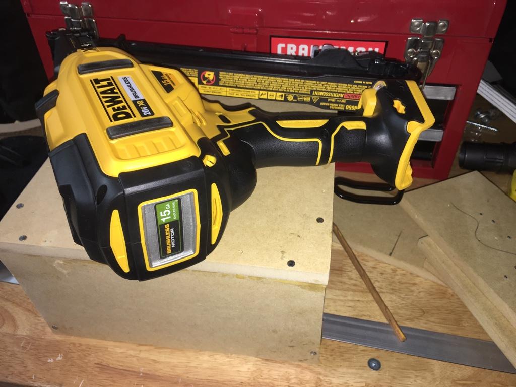

Got a new toy to finish up the boxes and use for some other projects like some built in cabinets in the family room
Ended up finishing three boxes in around the time I took on the first

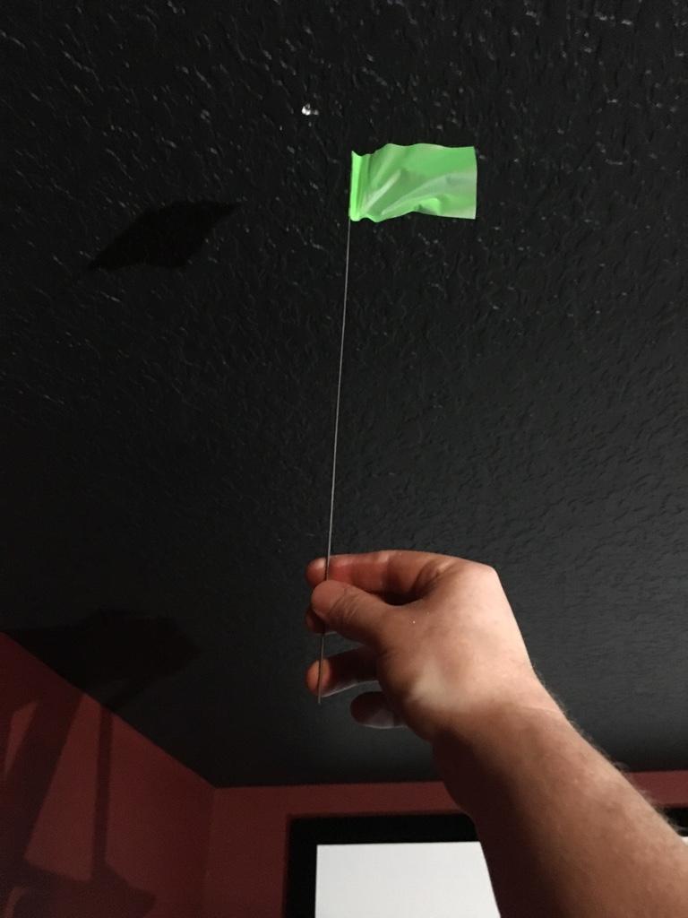

Little trick I’m using to find where to put the boxes in my attic. Trying to avoid insulation dropping down from above by putting the boxes in place before cutting the circles. Drilled holes then put the flags up through them so I can easily spot them in the attic. Anything that makes my life easier in a my sauna is great in my opinion.
panteragstk
panteragstk
I really need boxes over my 5.0 in ceiling setup in the living room. Way too much leakage into the attic. Yours look good. Might just steal that idea. Too hot to do it now for me.
