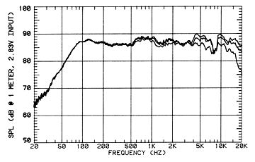

That just what frequency response curves tell us. They graph frequency (horizontal axis) against loudness or SPL (vertical axis). Several unidentified examples follow:
The first is bass heavy. The second will be shrill sounding while also having a deep bass response. The third looks very good. Note how it's flatter looking.
You can predict which speakers will be perceived as sounding good by looking at these measurements. However, you cannot predict what some people prefer.
