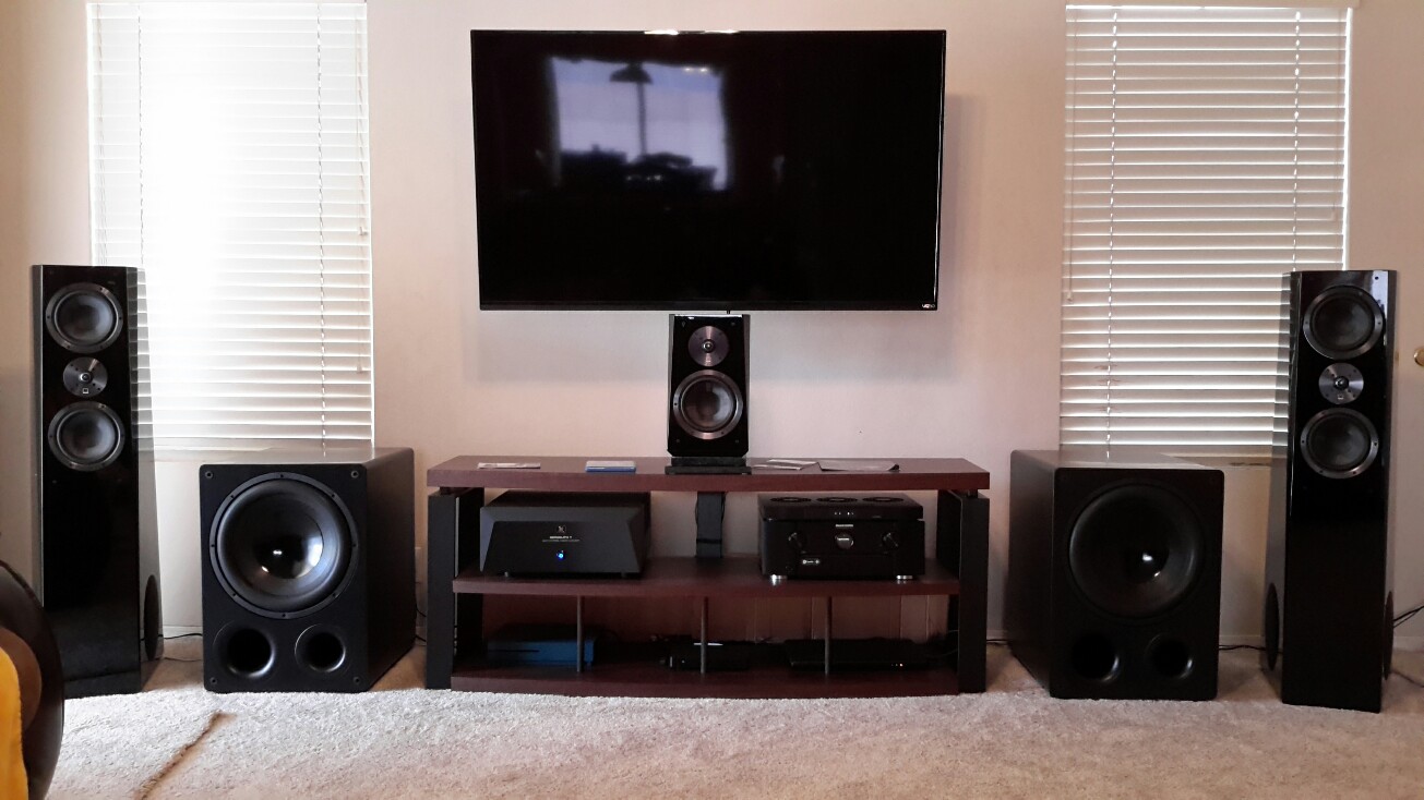

I said it might be the problem with speakers. Maybe not. All agreed that speakers are more important, right? So...
All of my speakers are from the SVS Ultra line. They're awesome speakers and sound fantastic. Very articulate, transparent and good for hearing tiny differences and subtleties in music.
Oh, and I played drums for 10 years. My dad was in a band. I used to hang out at his practices every Thursday night because practice was at our house. I know what to listen for and have the speakers to do it.

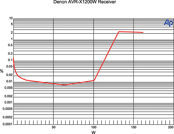

I don't know it still to be true, but in the past, the SR60XX and SR70XX series shared the same amp section as revealed by Bench testing (they only claimed less power from the 60XX series to try to help people feel like they were getting more for the extra money, but it was features that made the difference, not watts)
Here is the distortion chart for the SR7011:

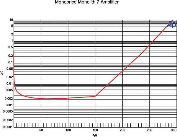

The ATI Monoprice Monolith:

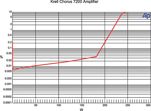

$9500 Krell amp:
Low to mid level Denon ($600 MSRP):
Interesting that the $9500 Krell and the $600 Denon are the only two that never get below 0.005% distortion!
Admittedly, these charts are probably at a specific frequency, but I'd still expect a pretty high correlation between single frequency distortion performance (which I guess is what this is) and full range distortion performance!

To be clear, I don't mean to imply that this is your guide to better sound quality as all charts show low levels of distortion that would not be detected, and for the low listening levels under consideration, any of these have adequate power. My point is that replacing the SR6011 is unlikely to be a wise investment as it is a fine unit and will do a great job unless he is challenging the power limits.
