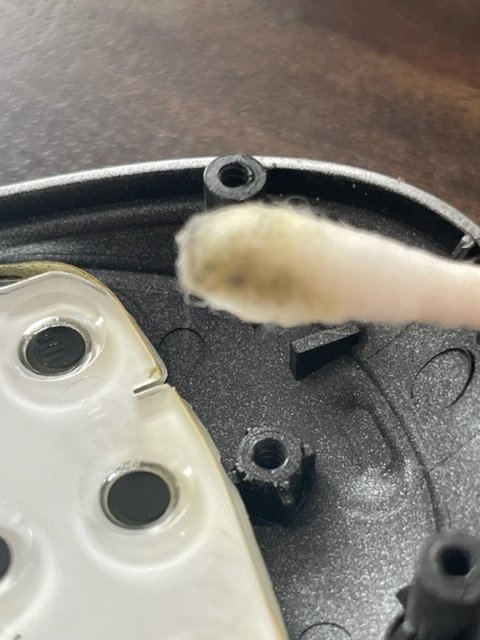

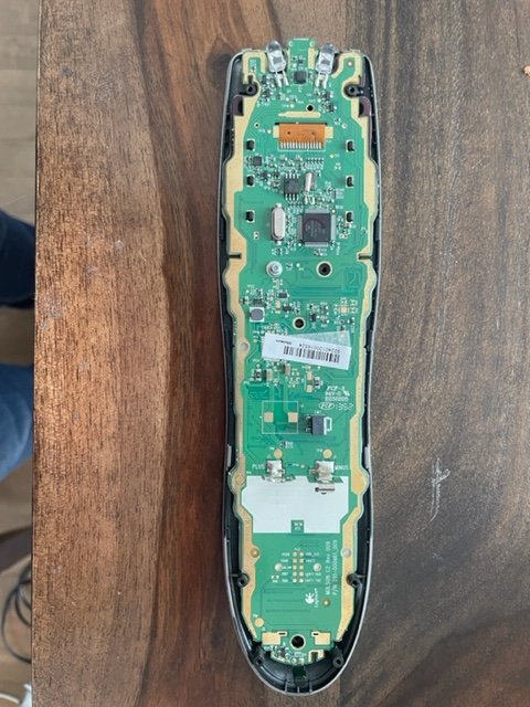

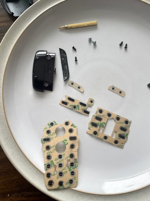

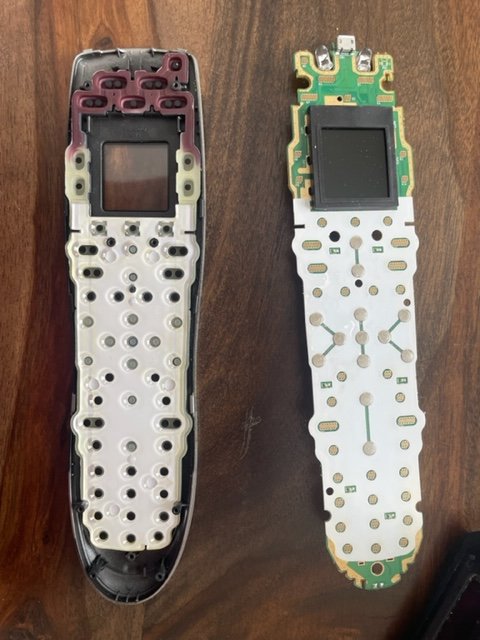

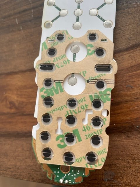

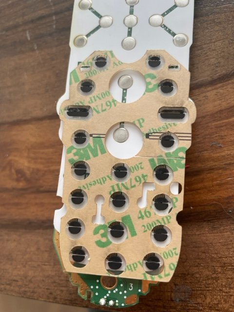

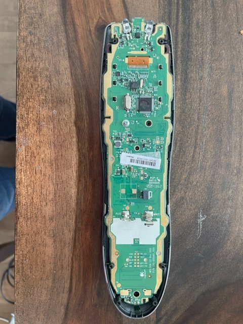

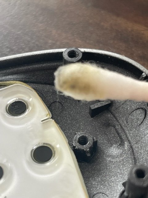

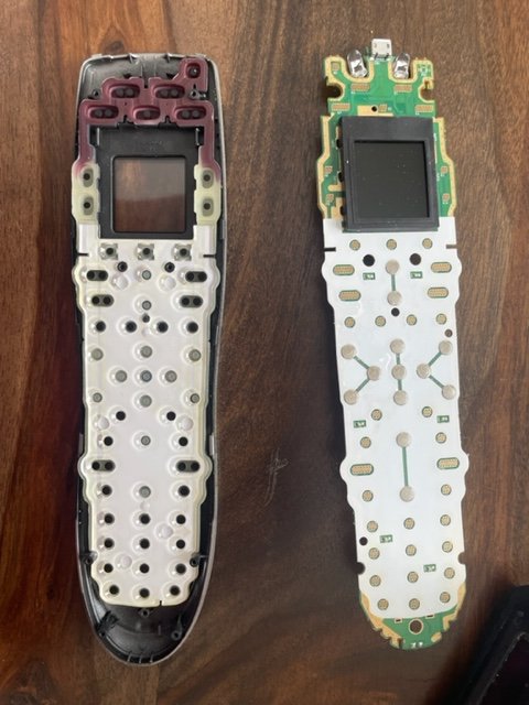

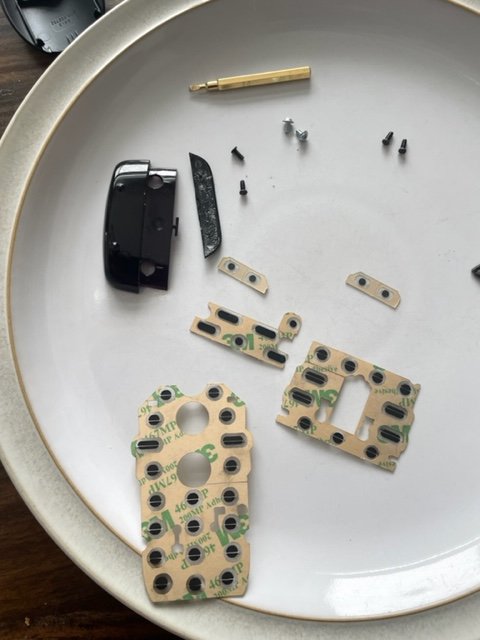

Yesterday, I decided to "fix up" two Logitech Harmony 650 remotes
The remotes come apart which are held together by 6 screws.
Remove the 3 screws holding the circuit card down.. Take Isopropyl alcohol and clean all the circular and rectangular button contacts on the right side of the pic.
peel the brown backing off the pressure pads (bottom left of right pic) and placing it on the contacts carefully aligning it with the button contacts.
I'm surprised how dirty these contacts get even though they are relatively sealed.
View attachment 60935View attachment 60934
View attachment 60939View attachment 60936

What I did was to fix the buttons on the remote. I dont what to do in your case. Have you googled to see if there is a factory reset of some sort?
