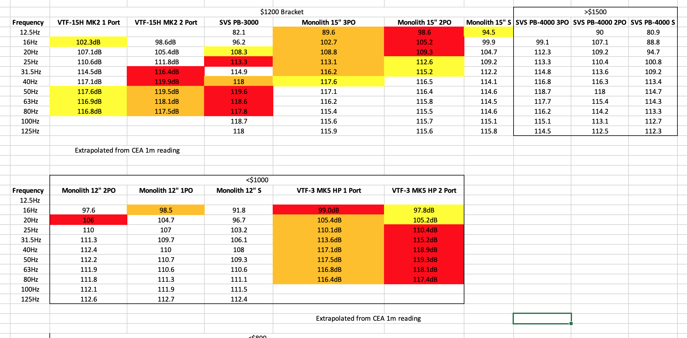

I complied some data together, and I wish I had the 12.5Hz or 14Hz extension readings. The Red is the highest output followed by Orange and Yellow. The VTF3 is a really good value at its price point. At 15H the Monoprice seems better when its on sale.
One thing that isn't quite reflected in that sheet is just how smoothly the Monolith 15" handles deep bass. It handles deep bass more smoothly at its limits than the Hsu or SVS subs. You can hear that the Hsu and SVS subs are a bit more stressed when pushed hard at the low end, even for the same SPL.
I think the numbers from the Hsu subs are taken from Hsu's website. Hsu actually tends to be a tad conservative in their reportage of CEA-2010. I think I was able to get a bit more out of the VTF-15h mk2 that I tested, but not a whole lot more. I would have to go back to look at my data. It wouldn't change the overall story told by your numbers very much. The story is that the PB-3000 and VTF-15h mk2 are pretty much even at 30Hz and above. The VTF15h and Monolith 15" have a bit more extension and can dig down to 16Hz whereas the PB-3000 is not that happy at 16Hz. When pushed hard, the Monolith 15" has more finesse at 25Hz and below.

Yes I believe what I saw is, you guys extrapolated the numbers taken from the HSU @ 1m, I think reducing 9db to compensate for 2m readings.
I feel like, even if the VTF 3 MK5 has some extension in the 12.5Hz range, I'll pull the trigger on that, the room gain and and a 2nd sub will take care of my room really well in most cases I think especially for costing close to ~$1950 for a pair. If I head to the next step ~$1200, I feel the Monolith is the ultimate champ for that price range. Ridiculously good performance. If it had gone on sale the last few days, I'd already pulled the trigger, If I can't settle for the VTF 3, then I'll very likely stick with the Monolith.

I called HSU today and they don't have the numbers below 16hz for any subs. I have tried looking online with no success so far.
12.5Hz is outside of the intended range of operation for all of these subs. I wouldn't expect much output in that range. Even if you had it, you wouldn't know it unless you measured it since it is so difficult to perceive. I don't know about the VTF-3, but I know that the VTF-15h mk2 has some output left in that region, but I wouldn't go chasing after frequencies below the tuning point of any ported sub.
