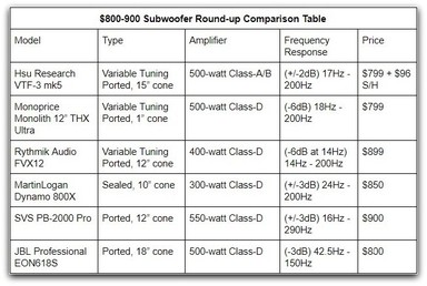

Which one goes the lowest of these. Some incorrect info here - VTF-3 has 600 w amp in their listing.
I agree, I think I was looking at it the wrong way, my need doesn’t really require a big sub. That said, between this and the other comparable subs from this list
Which one goes the lowest of these. Some mis info here - VTF-3 has 600 w amp in their listing.
From the specs the SVS, Hsu and Rythmik are close, the rest higher but not far off in the case of the Monolith but are they all at the same spl? What are their capabilities at higher spl? The amp rating tells you very little without information on the sensitivity of the system, tho. Personally I'd go with the Hsu VTF-3mk5....

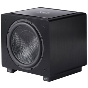

This just dropped to $999
where does this compare to in the foray of the subs we have talked about in the thread.
It's more like a Hsu ULS-15 since it's sealed. At the deep discount maybe, but Rel IMO tends to be overpriced and underperforming. Personally I'd go with Hsu.
Thank you, I’m skipping it.

I noticed the VTF3 has its number at the 16hz mark at 1 m 108, vs the 101.8 at 2m for the monolith 12”.Is there a way to normalize this, what would the reading be at 2m for the VTF3?
I also read the VTF 15 can drop down to 12-13 Hz compared to the VTF3. However all the subs will have some room gain, does room gain help with increased output or also with them extending lower?
There is a $200 jump between VTF3 to VTF 15 and another $80 to the THX. Can’t decide. I do like the looks of the VTF15 rose wood veneer, sort of matches with my speakers haha maybe I should decide based on that at this point /s :)
Indeed I’m haha, I’m just ready to pull the trigger, but just can’t decide.
You could apply eq if there's enough overhead but 6 dB boost would require 4x the power and at 16hz what are you really going to have for content....you a large pipe organ fan or something? Room gain may reinforce existing extension but won't actually extend it. Some do choose for finish options.
