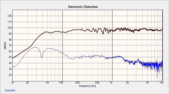

Why would a 201/2 have better measurements than a 207/2?
In what ways does it measure better? FR? Nonlinear distortion? Polar response? Link me to the measurements.
