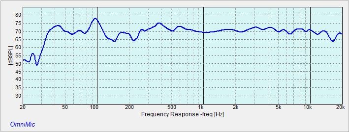

For those that might be interested, here is a quick on axis FR sweep of the Q700, taken at 1m, in room, 1/12th octave smoothing.

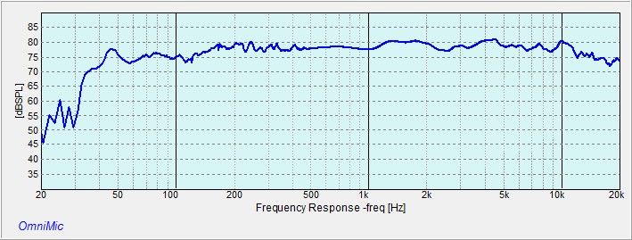

A little more time on my hands tonight, so I took a couple more measurements, this time on the other speaker of the pair:
On Axis, 1m, 1/12 octave smoothing:
90 degrees off axis, 1m, 1/12th octave smoothing:
Again, just pure direct mode, so no help (or harm) from Audyssey.

Doh! :D
I just wanted to see raw data for a change. Everyone uses smoothing. :D
But it's better than nothing. :D
Unsmoothed can get a bit crazy. 1/12 is generally a good enough resolution. I use 1/24 most of the time.
One of these days I'll measure my BS-22 and post 1/24, 1/12 and 1/3 for yah! ;)
