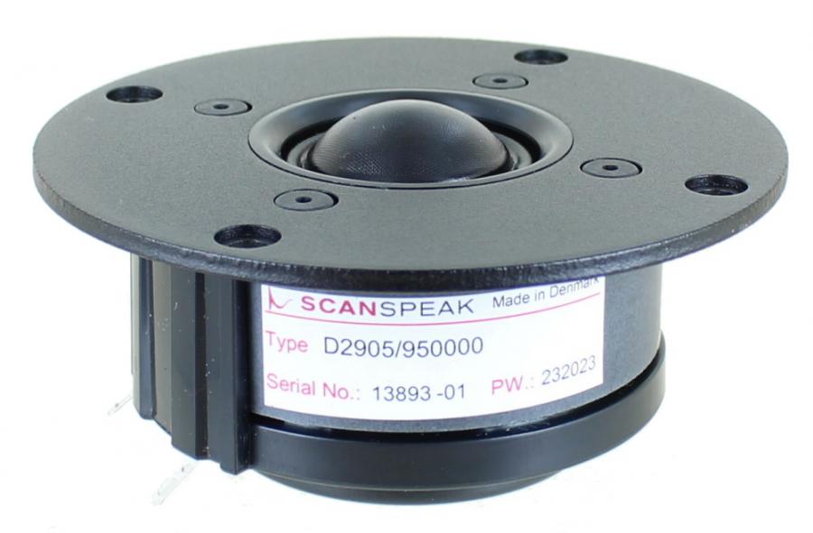

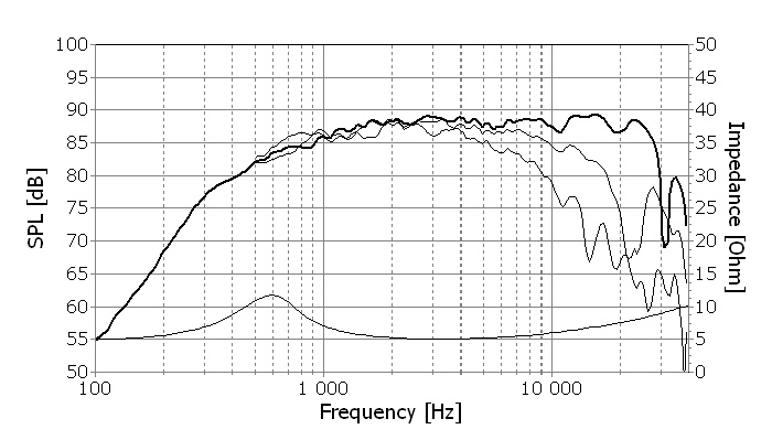

This is the FR if the best Beryllium tweeter available to the DIY builder and used in quite a number of high end speakers. I heard it in some Rockport speakers. It is the top end Scanspeak reveltor.
I don't care what hard dome tweeter you look at there will be issues in the top end.
Soft domes are arguably superior and it is because there is ripple across the dome. We have had this misguided idea that all cone break up must be stamped out. However controlled break up is a much better approach.

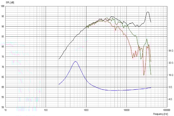

This is the FR of the SEAS soft dome I use.
Now which one would you pick for your design?
I know for certain which sound more accurate.

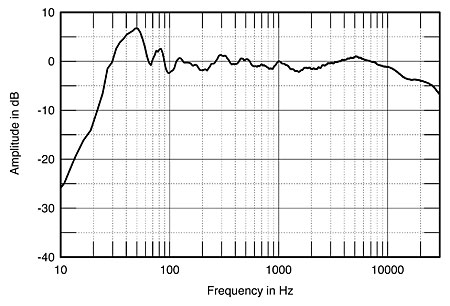

Some of them may in fact have the memo by now, just give them time. For now you are correct, as can be seen in the comparison below, Focal 1037 Be vs the 800 D3. With less smoothing, you can see that the Focal has that peak too at around 10k, but about half as bad.
https://www.stereophile.com/content/focal-electra-1037-be-loudspeaker-measurements
https://www.stereophile.com/content/bampw-800-diamond-loudspeaker-measurements
It looks like the Focal is -1dB at 10kHz and the B&W is +5dB at 10kHz. :D
I meant the higher resolution plots , more like 2-3 vs 6.
Oh, yeah, the Focal 1037 is +2.5dB at 10kHz.
I think most people consider anything less than +3dB okay?
The B&W 805D3 is +7.0dB at 10kHz.
https://www.stereophile.com/content/bowers-wilkins-805-d3-loudspeaker-measurements
I just looked at the Aurum Cantus AS25120 AMT Aluminum tweeter that is used in the RBH SVT tower. It's +1.5dB around 10kHz and +2.5dB around 12kHz.
The Soft-Dome tweeters in the RBH T2/ T30 seem to have less rise in the treble. So maybe TLS Guy might be on to something with Soft vs Metal Tweeter.
