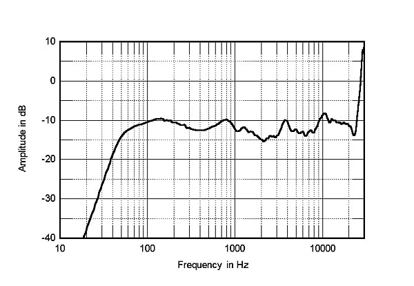

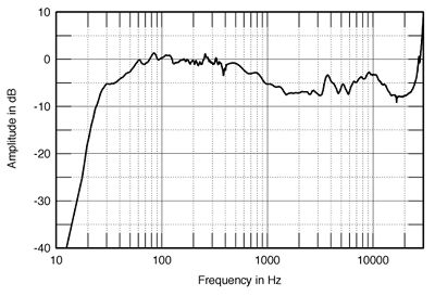

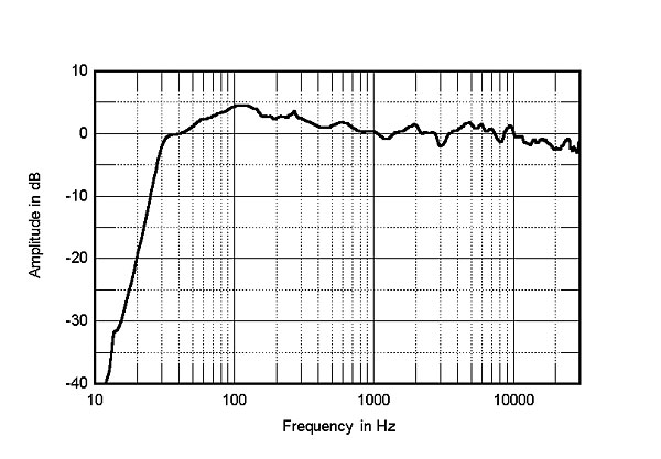

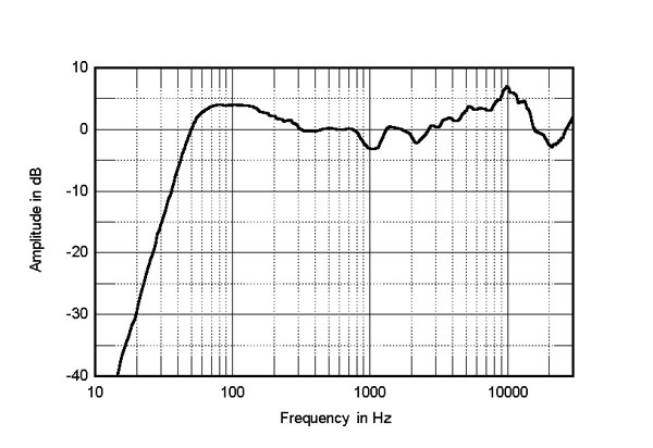

Below are some FR measurements from Stereophile, the KEFs have better overall response. I believe distortion is also very important, and KEF R series and above seem to do well in this area too. B&W probably do well too but I couldn't find much data from the internet.
B&W 805 d3
B&W CM5
KEF LS50
KEF R700

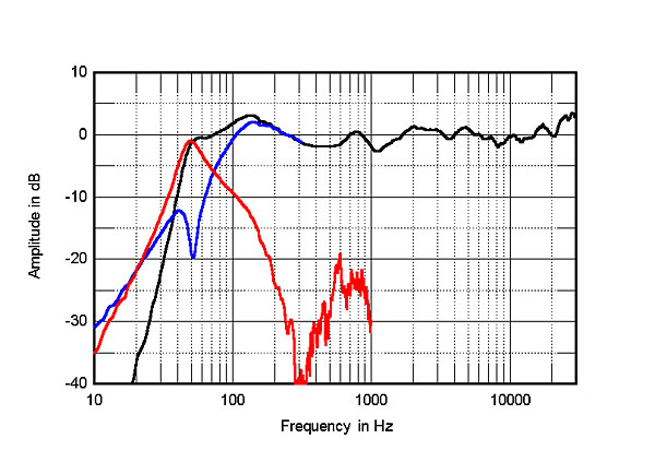

Fwiw, this is a Stereophile measurement of the Signature 800 which uses the old 1 inch aluminium dome. Note that the 10kHz bump is there exactly as it is with the diamond dome. The difference is the visibility of the dome resonance. So the Diamond is technically better, definitely, but whether it translates to something audible is debatable.
