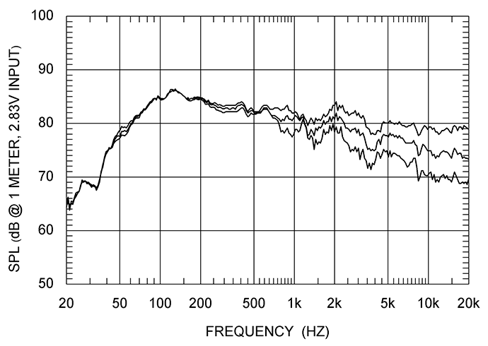

A peak in all the off axis measurements confirms a resonance within the speaker itself that colors the sound. I found that audible upon my listening, so I looked up the speaker and found the measurements to explain what I heard, and others did too.
As to your concern with not hearing the same results, how are you listening? Toole conducts tests with a single speaker in mono. It is much more revealing, and is quite relevant given our multichannel - monophonic, sound tracks. Plus you don't get the masking effect of stereo - if a speaker has an issue, you are more easily able to recognize it.

For what it's worth, we had a discussion about the LS50 measurements before and why the resonance at 2kHz seen on the NRC measurements doesn't show up in Stereophile's waterfall plot (or other waterfall plots I've seen of the LS50 from European sites).
The reason is simple, and obvious once you know it, but it took me a while to figure it out:
The resonance doesn't occur directly on the tweeter axis. It occurs off-axis (and to some extent gets stronger the farther off-axis you go). It appears to be an issue with the surround of the midwoofer. Stereophile's waterfall plot is based off JA's measurement of the step response on-axis only. That's why there is no resonance seen at 2kHz. If he did an off-axis step response measurement and then created a waterfall from that, the 2kHz resonance would show up.
B
Beave
Also, I saw on another forum a while back that Dr Toole has actually commented on the NRC measurements of the LS50.
He said that resonance is off-axis, but since we listen in reflective rooms and not in anechoic chambers, that the resonance is going into the room and will be audible. It will be more audible in more reflective rooms and less audible in heavily damped rooms.

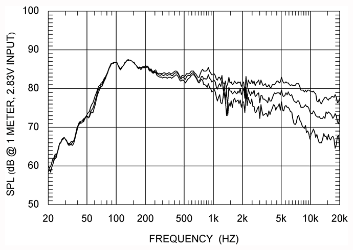

Hard to say what the issue is. The UniQ driver in the LS50 is fairly similar to the R100, which performs a bit differently through that range off axis.

Cabinet resonances would be eliminated, but resonances due to the driver wouldn't be. That said, my take on it is that it isn't necessarily a resonance. The LS50's tweeter is voiced a bit hotter than that of the R100, which is reflected in the on axis measurements. That accounts for the rise we see in the off axis measurements at 2kHz, and the dispersion begins to narrow above that as expected, at least until we see the effects of the tangerine waveguide/phase plug, which serves to improve dispersion of the top end.
Good point.
I notice the R100 doesn't have the off-axis peak at 2kHz, but it does have a (smaller) off-axis hump around 5kHz that the LS50 doesn't have.
Maybe these are diffraction issues that are different on the two speakers due to the curved baffle vs. the flat baffle?
I’d be surprised if diffraction had that significant of an effect on either speaker, but never say never.

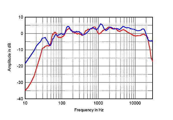

Well, I revisited the LS50's today to try to get specific on what it is that doesn't work for me.
I believe it can more or less be summed up by this graph and John Atkinson's statement quoted below:
The blue trace in fig.6 shows the spatially averaged response of my 1978 pair of Rogers LS3/5a's, taken under identical circumstances, but with a 3dB-higher level at 1kHz to equalize the two pairs of speakers' midrange outputs. The peak between 1 and 2kHz that lends this classic speaker its characteristic slightly nasal coloration can be seen, coinciding with a small dip in the LS50's response. The LS3/5a has noticeably more energy in-room in the top three octaves, this audible as extra "air" in direct comparisons with the KEF.
Read more at https://www.stereophile.com/content/kef-ls50-anniversary-model-loudspeaker-measurements#w58jJAL34IMdyAeg.99
In my earlier comments I spoke of a lack of ambiance, and this air is what I am talking about.
In many ways it is as simple as preferring a speaker with more presence! IOW, a more forward speaker over a laid back speaker.

After I wrote these notes, I looked at John Atkinson's measurements and comments as presented in my post above, and believe that fits my subjective experience fairly well.
