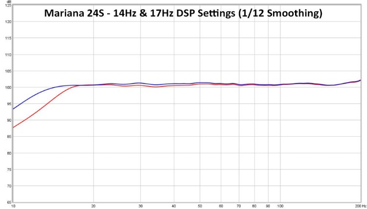

Absolute best system would involve DIY cabinets tuned for your goals... I've seen models of the 24" SI drivers up around 30cu.ft with a 10" port... Just stunning...
But you need a big room for those cabinets! It's not as practical as one would want.
Same for those Devs. Even if you aren't chasing the lowest frequencies with them, they still require some good-sized cabinets.
The Marianas, without knowing how much juice they are getting, are only showing on tat graph at 100dB. For most house curves and Bass-Head tastes... you want your output at a minimum of 115dB. ;)
Here is what Red Five was able to do in a ~20cu.ft cabinet with the SI HS-24 in his "companion" build
And here is a comparison against an 11cu.ft sealed:

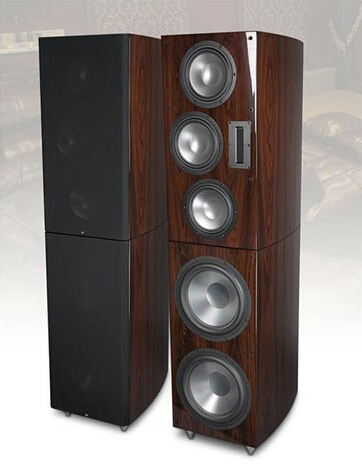

RBH make a set of speakers that go with those subs. They stack right on top and I want a pair!
The full setup is called SVTR tower system. Dream speakers for me man. Gene, the site owner has a pair of these in gloss black and they're just gorgeous speakers.
Sorry not sure how I missed replying to this post but yes those look to be the exact speakers I seen on YouTube. Gene Dellasala was standing in front of a pair. Slight chance i could be wrong but if so those speakers look a heck of a lot like the ones in Gene's video.
