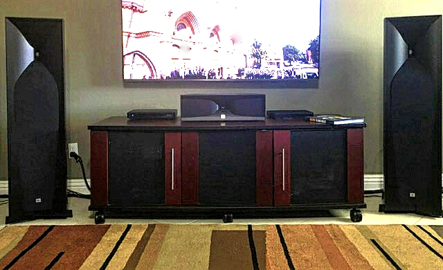

7’9” tweeter to tweeter.
Should the speakers meet you to form a triangle or cross in front of you or behind you?
How can I make the sweet spot wider? Thanks
Well the traditional format is an equilateral triangle but that doesn't always work in all rooms either. Experiment....I guess I'm doing more the cross behind me thing but only slightly
ps from your previous description of a phantom center sounds like you're in good shape already

Login is spot on if you got the center image locked in I'd say your pretty well positioned as it is

As noted, and observed, it sounds like your phantom image is nice and tight. Now, open up the toe in, in small increments until it stars to fall apart. As in the center image starts to sound like it’s coming from each LR speaker. Then move them back in to where it sounded the tightest, while still being nice and wide. One old skool trick was toe them in so you could just see the inside panel of each speaker. This usually had the tweeters cross behind the listener by a few feet(or a couple feet on either side). Mine work best when the tweeters line up about 4’ behind me. I use a laser level/pointer on the inside and outside panels aimed at my listening area to “aim” my speakers.

Small nit...
Might wanna move your CC up to the edge of the cabinet to avoid interaction with the flat surface.

I am questioning if I really need it. Looks wimpy against the towers. you really mean tilted or raised? Any specific material wood,foam etc. thanks
Foam pads, rubber door stops... the idea is to aim it at your LP. And yes you need it! ;)
Not talking about using it, that's up to you and what you're listening to as to what your preference is. Just aiming it at your ears like Ryan says.
