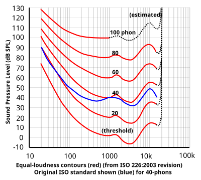

If, by this you mean you want speakers you can listen to at lower levels, the P363 are probably one of the better candidates. The little extra bass they have will sound rich and full whereas a totally flat speakers will sound anemic in the bass department at low volume.
As you can see in the chart below, at lower levels, the bass really needs to be much louder for us to perceive it as being the same volume:
Now the thing that concerns me is that they are advertised as an 8 ohm speaker but this review clearly concluded it as a 4 ohm speaker. I have a Scott 390R receiver that will be powering these speakers. Anyone think this would be a good match or did I mess up?
