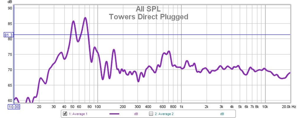

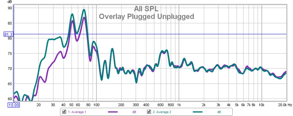

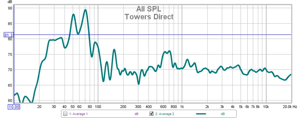

Ah, but setting my mains to large while Audyssey is engaged neuters my bass response. I took some measurements and the results are telling.
Both of these are an average of six measurements I took in and around my chair in direct mode.
This is in direct mode with the ports open. You can see the huge spike in the frequency range I'm on about.
This is with the ports plugged in direct mode.
Here's the overlay of the 2. Very similar, but of course the with the ports plugged it's a little tamer. I've come to the conclusion that what I'm after just isn't gonna happen. I can't have a "flat" response and that huge spike at the same time.
Looks like you are getting a 17-20dB emphasis on bass at 50 & 70 Hz. That exceeds the limits of what Audyssey will correct so I am curious what it does!
