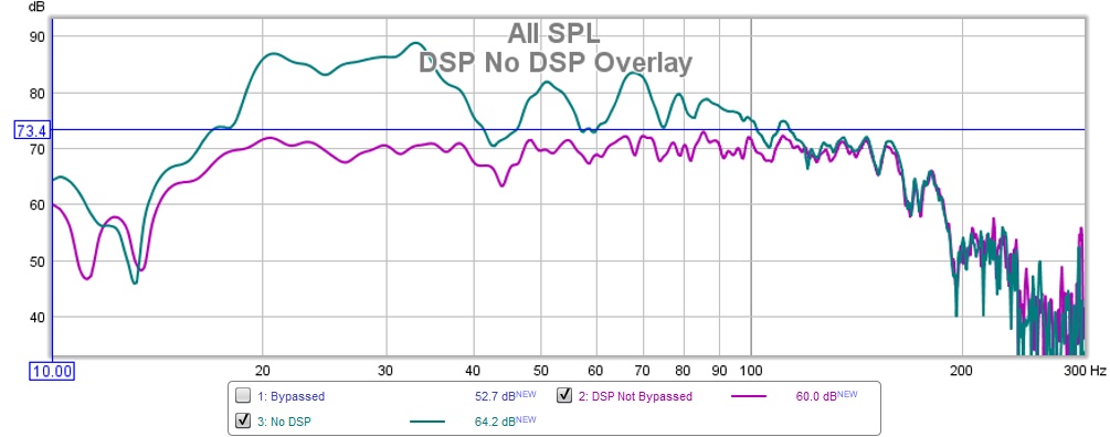

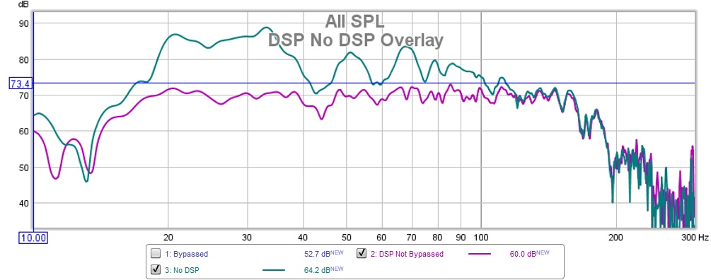

I'm not getting anything from my speakers. It's all subs. Here's with the mini and taking it out of the picture. Both sweeps are with Audyssey off.
Is that not a massive imrpovement?
Is that not a massive improvement?
Looks pretty sweet to me!
