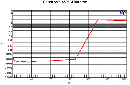

I agree, but too bad we have to "assume" and yet have no basis or reference to help predict how much the output would drop going from 0.5% to 0.01% THD, because no one seems to be able to find any bench test results for the popular XLS amps. It really would be nice if we can convince Gene to bench test one or two pro amps.
Something like what he did on the AVR-X3300W would be great, or what S&V did on the 140W 0.05% THD rated Denon below would be the minimum.
https://www.audioholics.com/av-receiver-reviews/denon-avr-x3300w-1/measurements
"with two channels driving 8-ohm loads, reached 0.1% distortion at 198.6 watts and 1% distortion at 218.9 watts. The distortion level remained at or below 0.002% across all power levels until it reached about 165 watts. Into 4 ohms, the amplifier reached 0.1% distortion at 298.0 watts and 1% distortion at 343.4 watts."
Read more at https://www.soundandvision.com/content/denon-avr-4308ci-av-receiver-measurements#IPSAGakKRwtoD6G8.99
