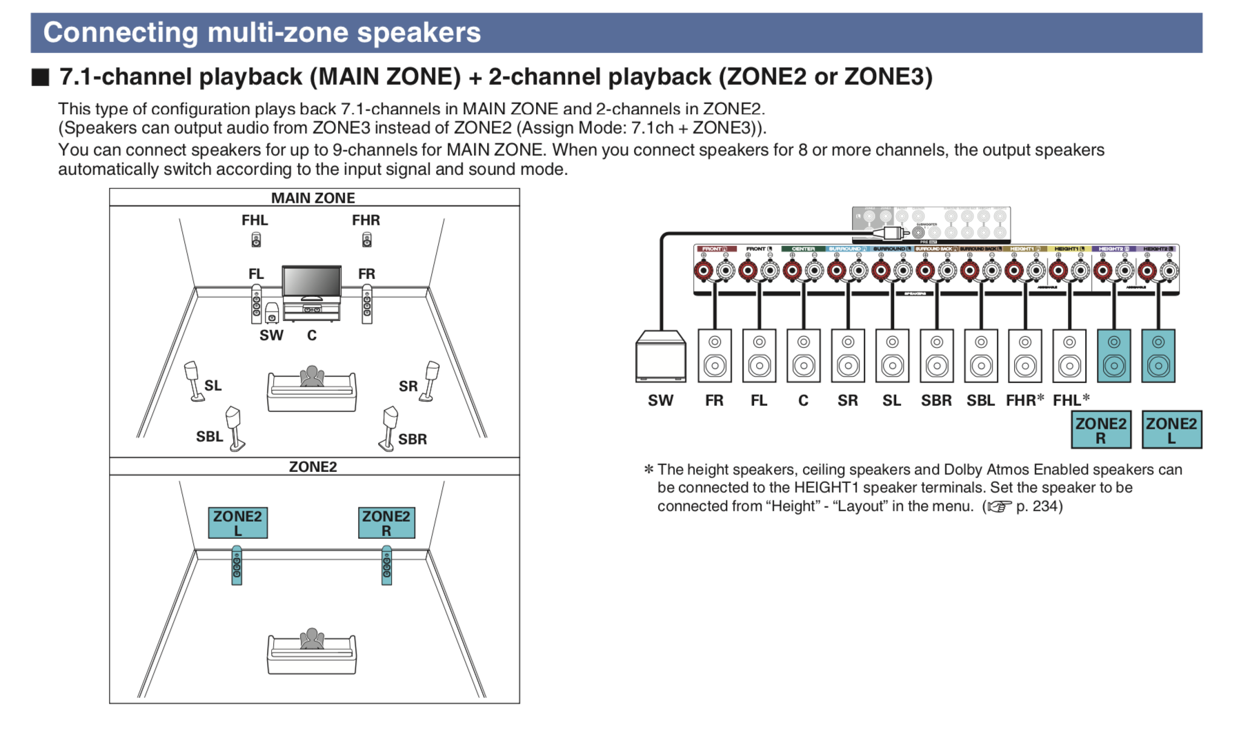

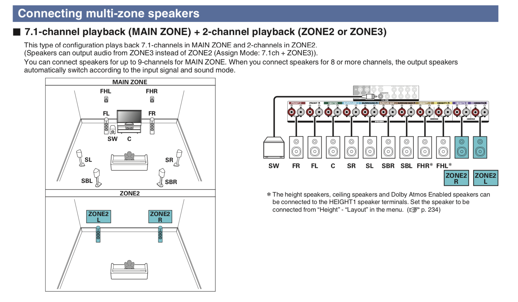

Thanks, I do NOT need a Zone 2, as second room would always be using the same sound of main room. So, would be "Speaker B", now, if I set it to 11.1, SO I can use pre-amp for fronts with disconnect of power, would I still be able to use Speaker B somehow? Meaning send the front speaker sound to Speaker B?

The Denon 3600, 3700, 4700 are all 9.2 receivers. If you set it to 11.1 then you will need to use an external amp to power the fronts. In that case, the "B speakers" would not be available.
If you select "B Speakers" in amp assign you will be limited to a 7.2 setup in your main room and the B speakers will be attached to the Height terminals. If you are going to use "B speakers" I would probably go with the 3600 or 3700. Since you will be powering two rooms you won't have the ability to maximize an Auro-3D setup that the 4700 offers. The power difference will be minimal.
